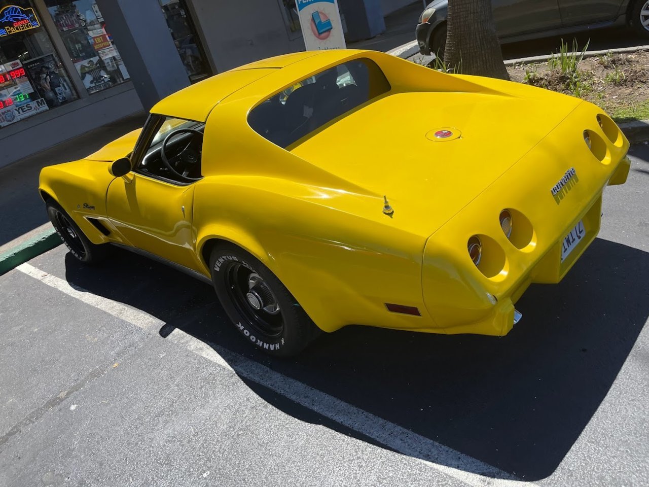

    Here is one of the side gigs i was working on. Changing all the oils, plugs, distributor, shocks, heater core, radiator, setting ignition timing, fixing the exhaust, and more im forgetting. Hate, hate, hate this car. working on it. Im so used to 90s and up JDM cars. But on a test drive around the block i pull up to a red light, me in one lane and lambo in the other. Pack of bikers pull up and start giving me compliments on it. lol completely ignoring the lambo.
