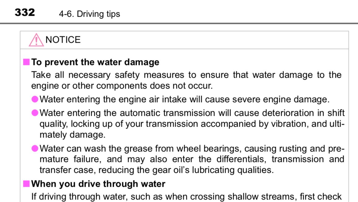

    Toyota won't say because they're irrelevant. Jeep and others provide fording depth but just because you didn't hit that mark doesn't mean they're not going to deny the shit out the warranty if you hydrolock the engine. If you take a bumper off on a rock 3 degrees less than the approach, Toyota isn't on the hook for the bill on that either. They're guidelines and should be treated as such.
    I'm not saying the denial was right because it clearly wasn't hydrolocked but when it comes to warranty, you are at Toyota and the dealership's mercy (yes, aware of Magnuson but good luck with that losing battle). I can assure you after spending a few years as a dealer tech, people are full of shit and totally never do things outside the intended use of a vehicle that will break shit and never lie about it.

    Well if it was about entitlement and free repairs, why put in the effort, he already got the free repair...
    nothing for him to gain, except for maybe a little revenge and entitlement for what he went through. He may be justified in being pissed off or he may have been an idiot that beat the living crap out of his truck, we can't say and will never know for sure so ignore that part and move on.
    He's presented a couple VALID questions VERY POORLY.
    He has not properly organized his facts and undoubtedly "salted" then a little bit.
    BUT not even the trolls here, that keep trying to ADHD the topic can't get past the rest of the shit and answer his two VALID questions:
    How deep can you go,
    How steep can you go,
    Other manufactures make that information available, and so has Toyota on other vehicles... Looks like we better hope our neighbors have Rangers if there is ever a flood.
    An analogy would be; you get pulled over, and a ticket for going too fast, you ask the cop what the speed limit is and they say "can't tell you".
    If I drive through a 150mm (6') puddle and my truck has an issue, will my warranty be void?
    In the above question, I'll say YES and NO ONE can prove me wrong. I know I'm not right, but I may not be wrong.
    That is his point.
    And since these two questions are unanswered by Toyota...
    Ii would be nice for members to band together and figure out what the rough safe limits of our trucks are without us all repeating expensive lessons,
    Sorting through 5000 shitposts of cranial flatulence to gather good information on this site gets a little tedious at times.

    If Toyota didn't market and name them as Off-Road I would agree with your about the irrelevancy of fording depth.
    Fording water is a NORMAL part of off road. It's not a dessert runner... there are puddles and streams off road.
    Warranty guide and manual covers all other "Normal" operating conditions and things that void the warranty. Guidelines protect the customer and the manufacturer.
    After working a few decades in Automotive design, quality, supplier quality and manufacturing design I became good at separating pepper from fly shit, I dealt with dealers representing the assembly plant and parts supplier sides. My brother was a Regional Rep for GM. Oh the BS and flim flamming that goes on from start to finish is just sad, but it's just normal human behavior whether we want to admit it or not.
    Frustrating for an engineer trying to figure out what the real problem is/was. Everybody stands in a circle pointing to the right trying to blame the other guy.
    Out of all his thread here and that web page I can summarize it into two useful legit things;
    How Steep and How Deep.
    20K words down to 5.
    I'm curious as to why that call was made, (Hydrolocked) most techs are not incompetent, so there must have been some sort of "evidence" and at least the air box and intake of water.
    But we'll never know for sure and never be able to get that detail out of the guy cause he'd be nuts to drop back into this troll farm.
    Once they already had him pay, they opened it up and found some things and reversed their decision and covered it under warranty, didn't say it was goodwill (maybe they did, can't ask now) but still so many unanswered questions there. But we'll never find out the rest of those details either now.
    If the Incline meter goes to 35 deg and there is no redline to warn you and you engine hydrolocks from oil at 25 deg is it user error for not having "common sense"?
    I won't argue that smokin and knocking is a "duh you've gone to far" moment.
    But I'd like to figure out some rough working numbers for how deep and how steep so I can plan my lines accordingly. :)
