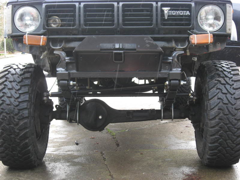

  8. Sep 6, 2024 at 9:32 AM
    MAG GRY TACO15
    MAG GRY TACO15 Well-Known Member
    Sep 5, 2018
    #265273
    5,063
    Alan
    GA
    '15 TRD Off-Road
    Same crap everyone else got
    My fracture was on the passenger side inner ubolt area. As you can see it's a strange place to have the ublot b/c it doesn't exactly sit flush to the axle to start with due to the diff housing curve. Not my pic, but a clear pic of where the fracture would occur. On a rear, I'd say the chances of it happening would be even less.
    111705d1501247950-need-help-identifying-_5c87ac58348d241f18fe8a2f678002ceabf16d88.jpg
    PathFinder1776[OP] likes this.
