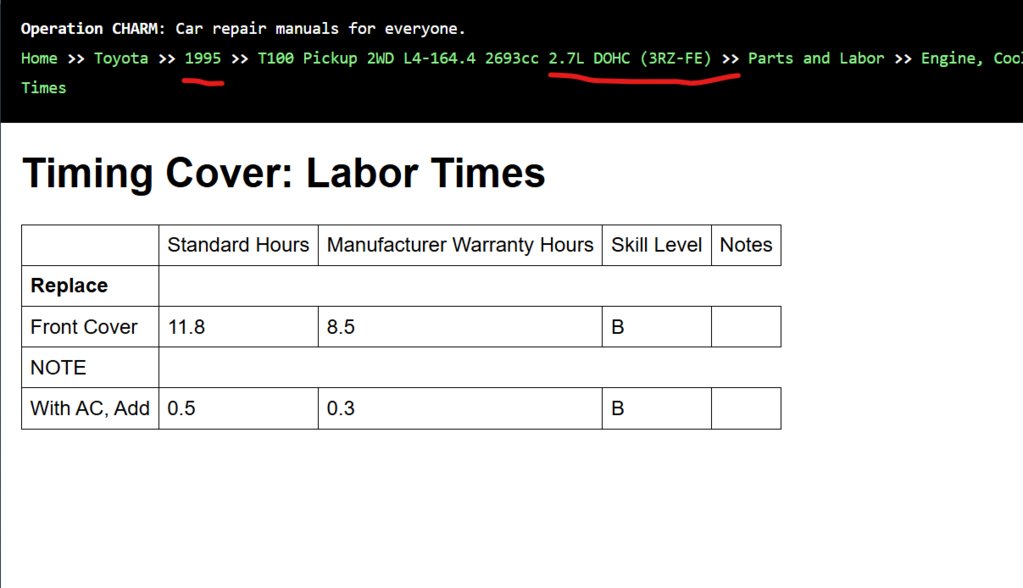

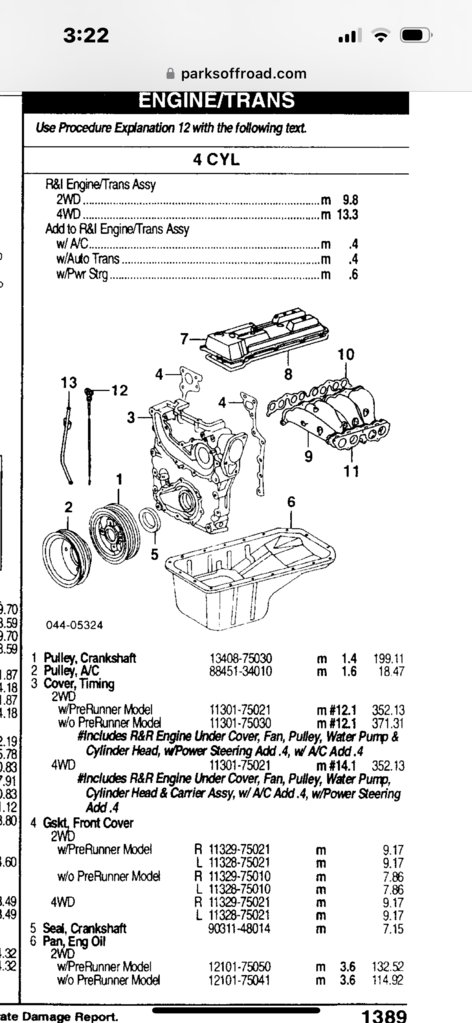

    2rz/3rz's T cover is a bear think book time is 12hrs

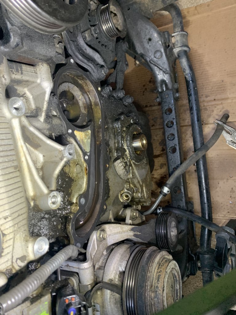

    Might have a trick to prevent all that work
    this was 1/2 way thru my T cover (gaskets)
    job
    Very possible if you take off OP…..will give a large enough window to confirm bottom T marks
