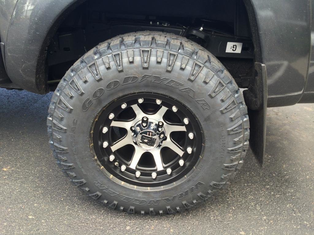

  6. Jul 30, 2014 at 10:31 PM
    #26
    Annolino122
    Annolino122 [OP] Well-Known Member
    Oct 19, 2012
    #89332
    820
    Evansville
    2014 Tacoma TRD off road
    When I'm rolling on these
    58AD5C4B-13EB-4EF6-ADB6-29FDC64DC795_zps_853927e2e7525680eaf132411a03bffbbc1e5e69.jpg
    I know the weight and resistance is higher and I'd lose a little mpg, which is why I was hoping for some mods to help but if not till monitor my foot

    All the intake/exhaust mods that improve flow at full-throttle will not do anything for fuel economy,
    If your tires are larger than stock dia., be sure to account for odometer error when calculating milage. For example, 13 mpg uncorrected with 33"s is actually 13 x 33/31 = 14 mpg.

    those LT duratracs are what is killing mpg... those are HEAVY tires

    When I fill up in Vail with 85 octane, and drive to Denver, I get 28mpg with my Wrangler MT's.
