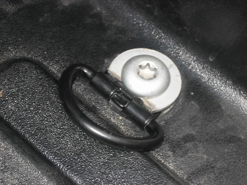

    Just picked up my extra D-rings today and I'm excited to perform my first mod!!!! One problem, I don't have a dremel to file down the washer like it's shown in the how to thread. Does anyone have any alternatives? I'd hate to shell out the money right now for a dremel, although it's a good tool to have, it's not in my imeadiate budget. I'm a little hesitant to take my bolts out before I know for sure I can finish the job. Thanks.

    Yeah my plan was to use the bed bolts with new toyota D-rings. BFH? I'm assuming you just used a "big f'ing hammer" to flatten the washer out? I fell a little behind today, so I'm gonna end up doing this tomorrow when I know I have enough daylight to take my time and make it perfect. I think I will look into the side mount, it may come into handy if/when I decide on a toolbox. Anyone got pics or a quick how to? Just so I get an idea.
    EDIT: JUST FOUND THE INSTRUCTIONS THAT CAME WITH THE D-RINGS. BUT HAS ANYONE EVER PLACED THEN ANYWHERE OTHER THAN WHERE THEY TELL YOU TO?

    Alright guys, just did it!! It took a little longer than it should have, but it turned out great.
    I went out and picked up a grinder bit for my drill to take the place of a dremel. But I couldn't wait for my battery to charge, so I ended up doing the first one by hand.
    By the time I was done with the first one my drill was ready and I got busy
    Finished product, my first mod :headbang:
