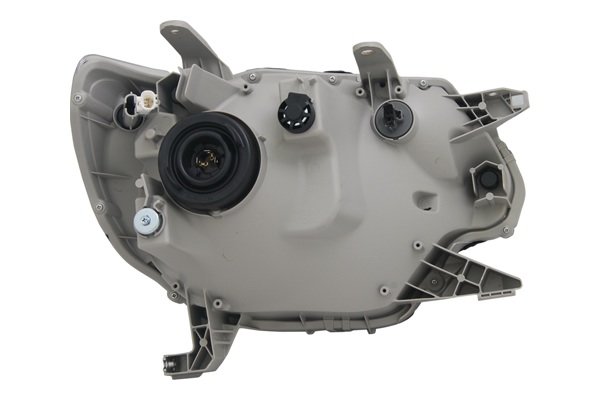

    Very simple, two 8mm screws at the back....

    Sorry, it's actually a phillips screw on the 2012's and up. It's the screw directly down and to the left of the black boot....

    Same screws or bolts on all the 2nd gens...if he can reach he can use a 8 mm socket if not a long Phillips head screw driver will work from the top town
    Reason why they made those small inserts to slide a screw driver in from the top

    There are two aiming screws, actually. The other is under that black cover.
