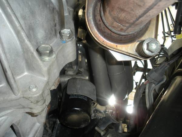

    After putting a header on a 4 model yr old truck last yr with probably 70k on it, I was fairly impressed with how unrusted they were. Sure, they weren't fresh new looking like the coating on the header but discolored and not actually rusted. Some were in better shape than others but all were in pretty good shape overall. Other than coating them with same ceramic stuff on the header, can't imagine what could keep them completely fresh looking. Of course, I am not from an actual winter area that sees any salted roads either. I'm sure that makes big difference.
    Collector spring bolts look pretty good too..........
