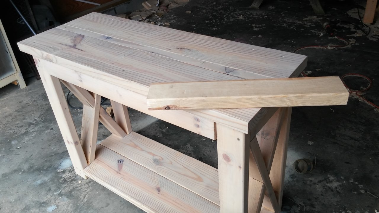

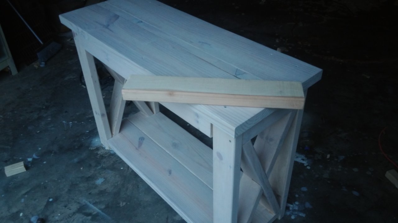

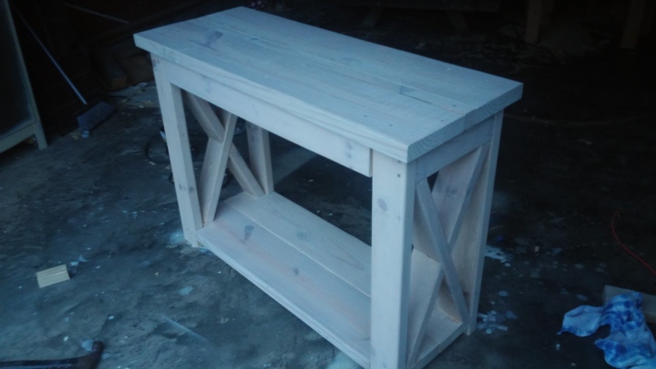

    It was early this mornin an light is bad but here it is after the water and paint from last night

    I can see how it "paled" it up a bit.

    I started with like 2:1 water to paint but that was way too much, I basically got down to the water that you have cleaned your brush out in for a day. the oil based stain I used may have had some inhibition on allowing the paint to soak into the wood and helped some with the pronunciation (however, It may not have)

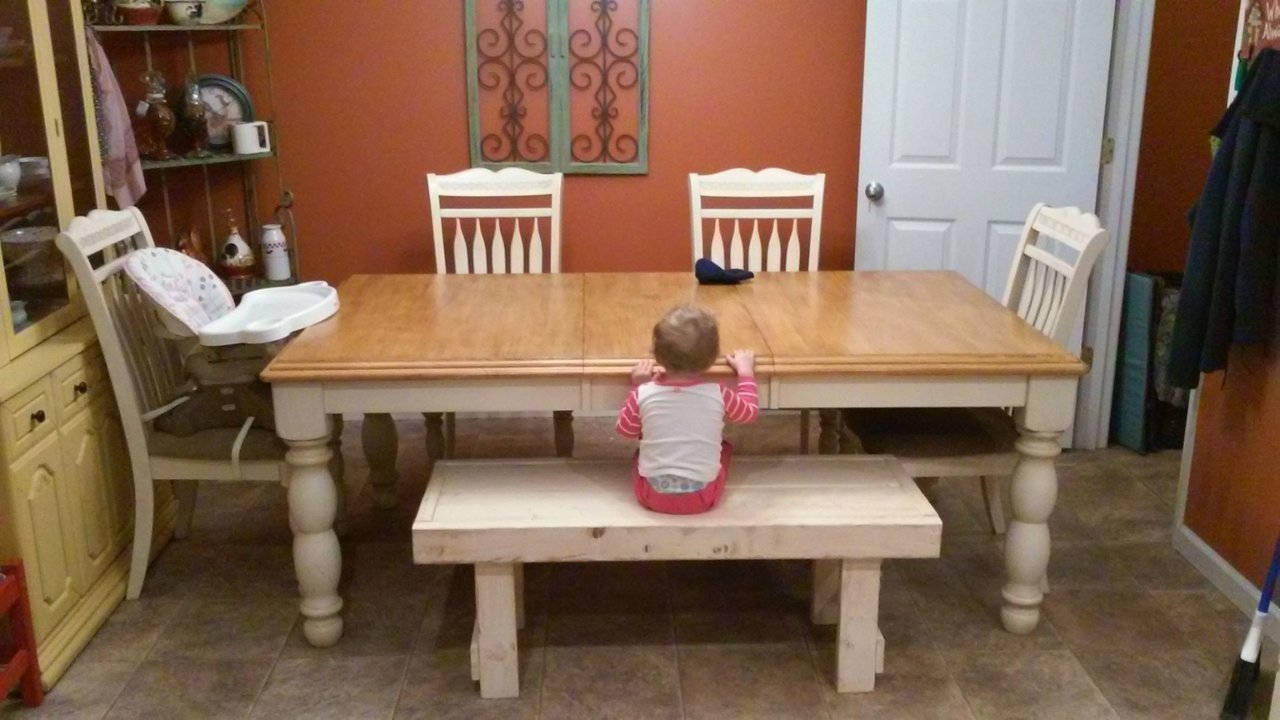

    this was my first attempt at white washing and I was hoping that the stain would have given me the effect I was going for. I have glazed a few piece of furniture that I painted but I try and stay away from painting as much as possible haha
    I painted this bench antique white (rattle can) and rubbed a mocha (I think, some kind of dark brown) glaze on it, it really stands out in the knots and in between the boards where you cant wipe as much back off.
    I guess it would have helped if I put this picture in...

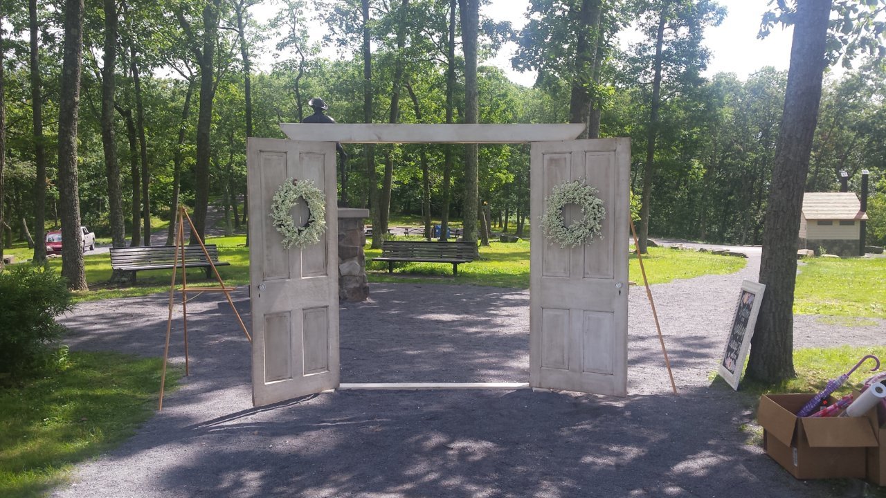

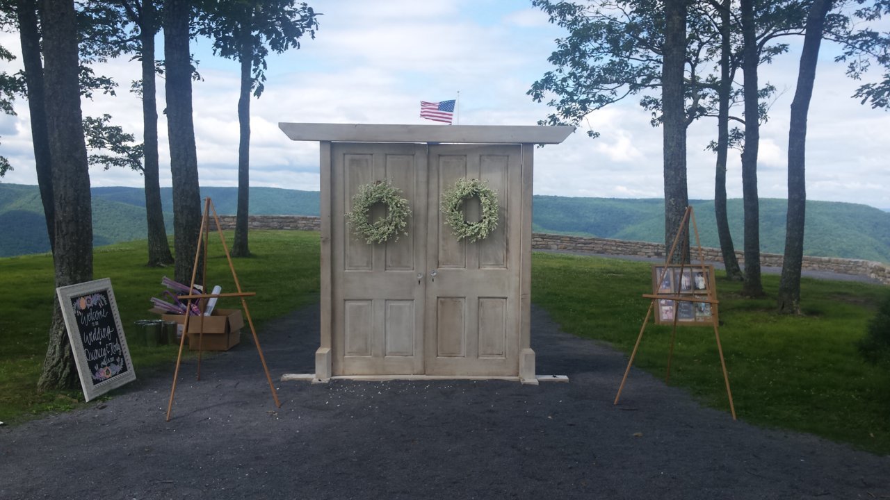

    Very nice. I did these doors that way...

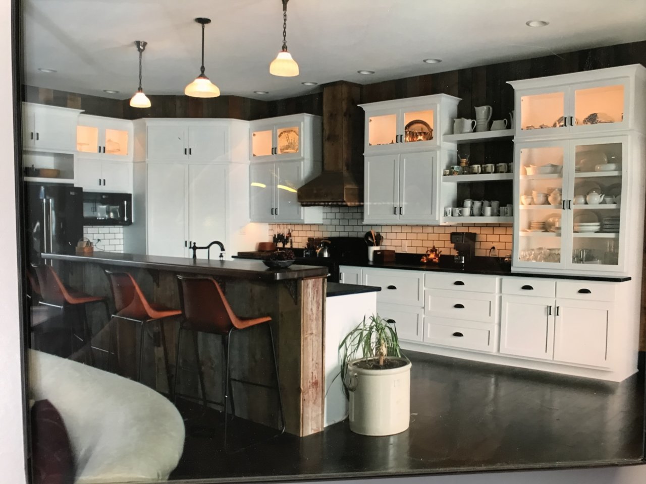

    Banff is on my list of places to visit this year. Never been but I can’t wait. I also dabble in the woodwork here and there. I’ve been a cabinetmaker full time twice in my life. Here’s one of the only kitchens I have a pic of after loosing all of my pics from a corrupt backup. Had to take a pic of a pic because I liked this one so much I wanted to remember it 557129EF-9BDF-4FD9-8BA8-C06217EA6037.jpg

    Beauty! Clean and warm, functional and open. If you had to guess, how long ago did you do that kitchen? It's interesting to see how trends go for kitchen designs. That's a pretty popular style (In my area at least) and I'm personally a big fan. Just curious if the 'trend-cycle' has gone full circle again.

    Thanks! It’s been about a year and a half. If you notice the backsplash is done out of subway tile, which to me will be one of those things that 30 years from now will let someone know what time period it was done in lol. Seems like the last 2 years subway tile is everywhere! This picture doesn’t do the size of the room justice. The cabinets are just under 11ft tall and that island was around 14’ in length. Those huge doors in the back are actually the opening to the pantry, the owner just wanted everything to look seamless. I definitely enjoy the mix of rustic/modern in this one. The cabinets aren’t painted either btw. We used a conversion varnish with a heavy white pigment in it to give it a paint look but the durability of a real finish. For the record, as nice as white looks, I’d never in a million years choose to do my own kitchen in white. It literally shows everything! Even if you brush up against it with your pants and a river slides across it..boom there’s a line lol

    Thats some nice looking work from a fellow Iowan.

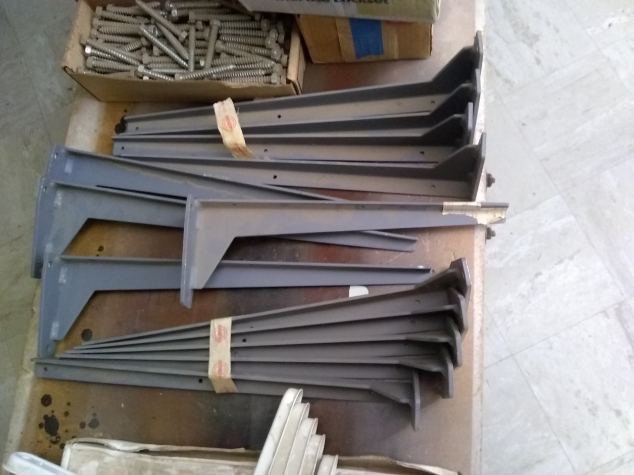

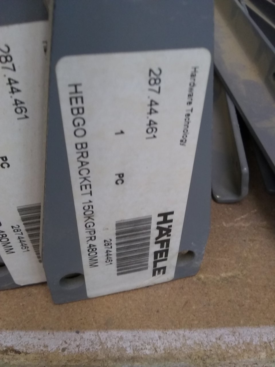

    Cleaning up found these, nice deep brackets.
    Can't use them - anybody interested?
    Probably expensive to ship, but if you can use some, they're yours.

    Those would make some great lumber hangers.

    This is exactly what I was thinking. We used to something almost identical at the old shop I worked at.

    Nice work! I like that blend of styles too.
