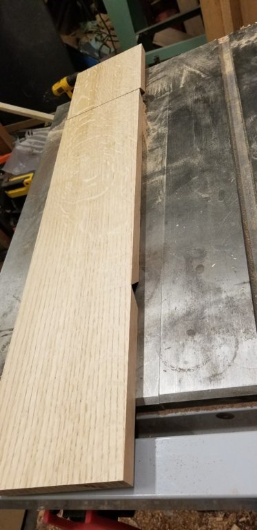

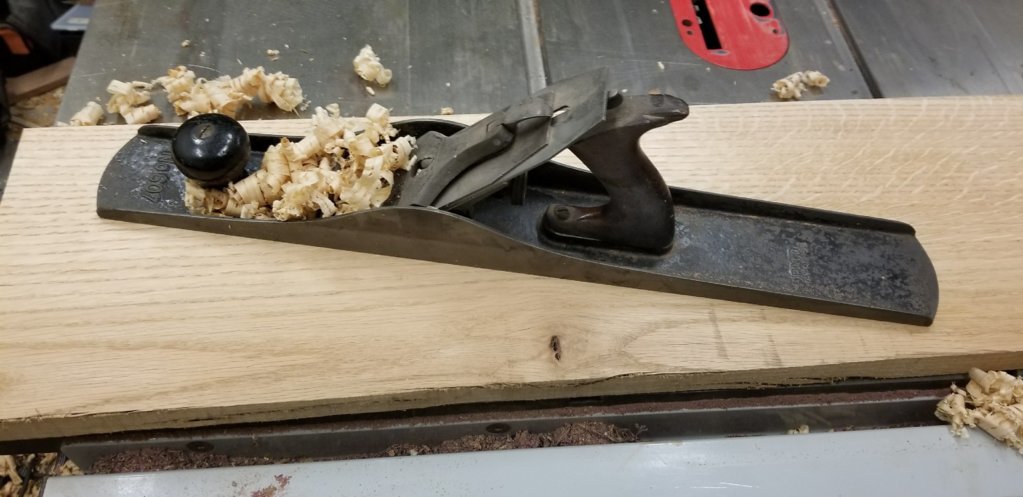

    Led sled getting some work done. I love this plane.
