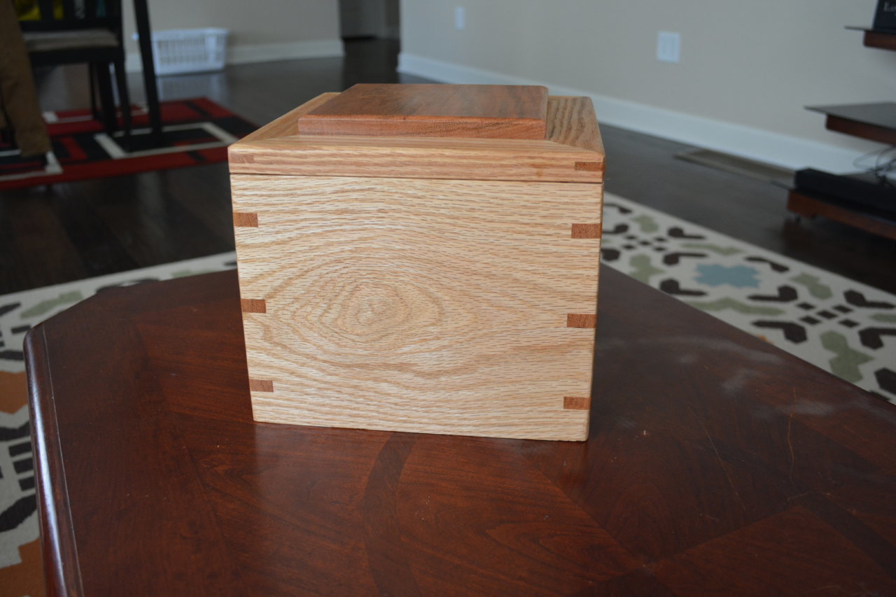

    Just finished making a memory box for someone in Cali.

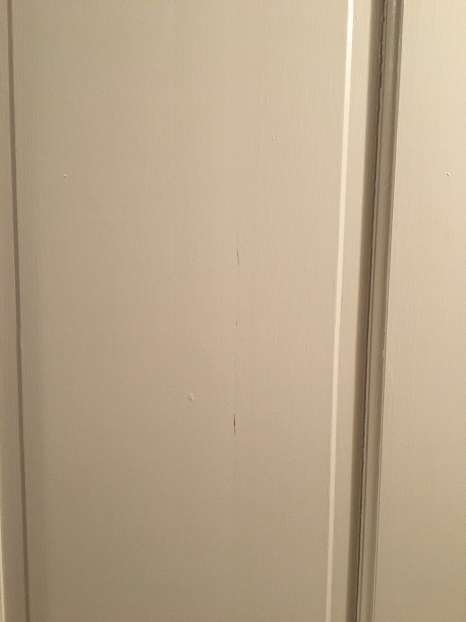

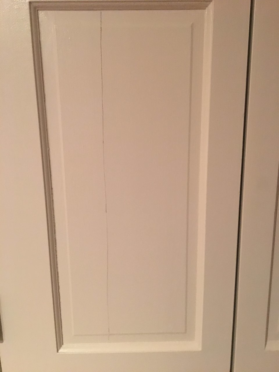

    I have a door with a crack in one panel, otherwise it’s in great shape. Was thinking of - somehow - opening the crack up a bit and injecting wood glue. Once done I’d clamp it for compression, let it cure and repaint. This make sense? If yes what is the right tool to open without doing a lot of damage? For inhefting, what is the best method? Apologies if this is overthinking the solution. Pics of back and front:

    Since the door is painted, could you just inject some 2 part epoxy into the crack with a syringe and sand flush and repaint after it cures? Tape the bottom if the crack goes all the way through as epoxy will seep into every nook and cranny. No need to clamp.

    This is the worst feeling, customer received the box and the lid was broken.

    Thanks, I’ll do exactly that, appreciate the advice.

    Is it the panel itself or the gap on the right side of first pic?

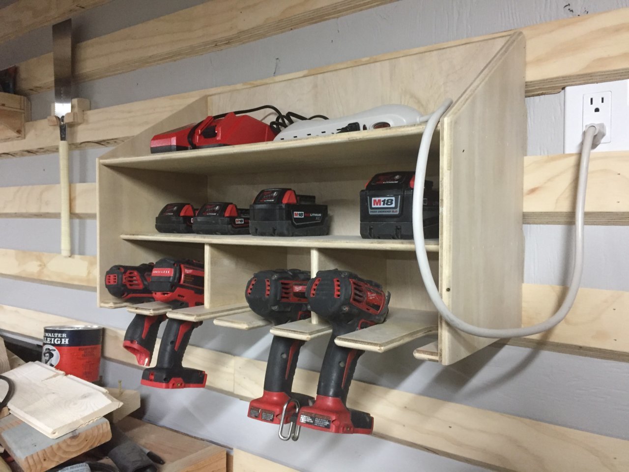

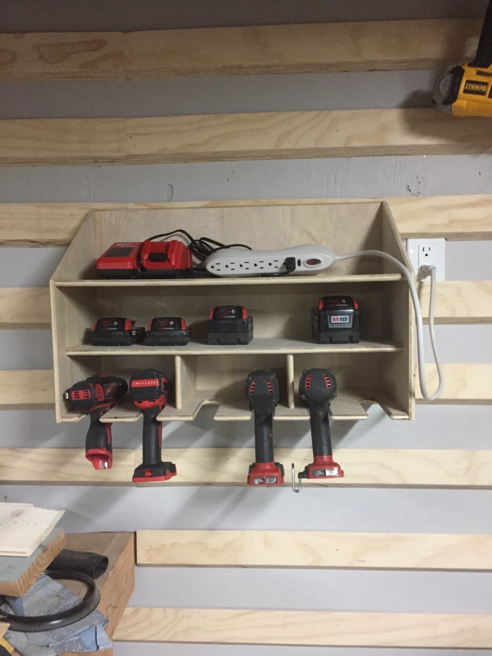

    I built this today.
    Still need to drill a hole to route the power cord through the back. And mount the surge protector so it’s not just laying there.

    Nice cabinet. I've been meaning to build something like that for a couple of years now but never seem to get around to it. I like your french cleat system.

    can be fixed but still stinks it was busted.

    Sucks because it costs $30 to ship the box each way. And I can't make a new lid and just send it because the box is sanded to have the lid edge faces blend with the boxes edge faces. Trying to figure out what the customer wants to do so I can fix this.

    did you get it insured? I had to re-do a shadow box for a guy, because USPS messed it up. Luckily I did have it insured and got the money back.

    The panel is cracked all the way through though more apparent on the front side. There is a gap on the right side as you have noticed.
