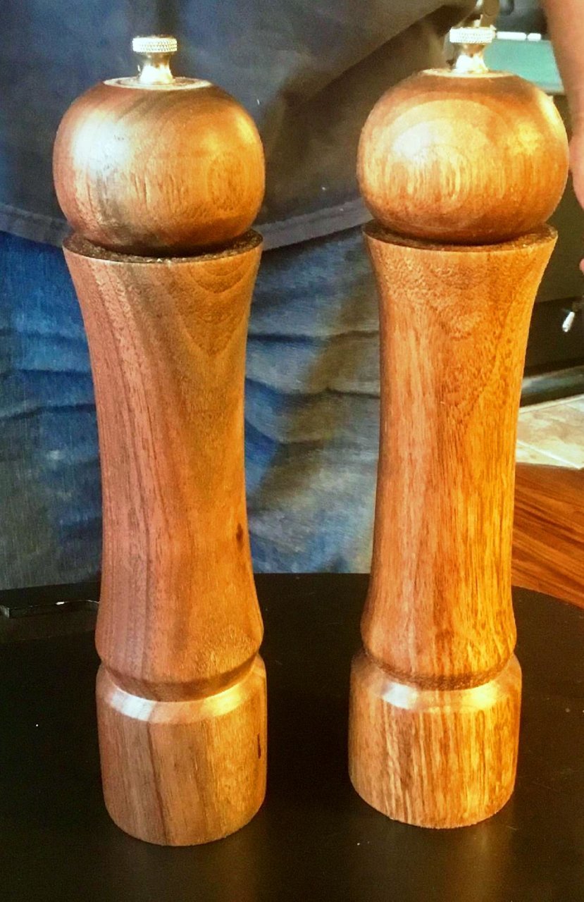

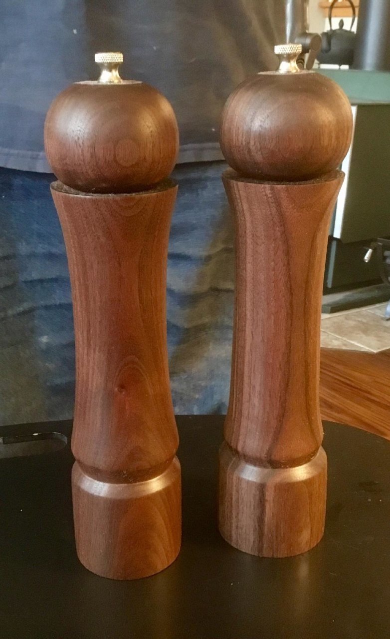

    made these today, its the same set just two tone so shows both sides. Pics arent quite the right color but still came out nice IMO ;) They are about 10" tall.

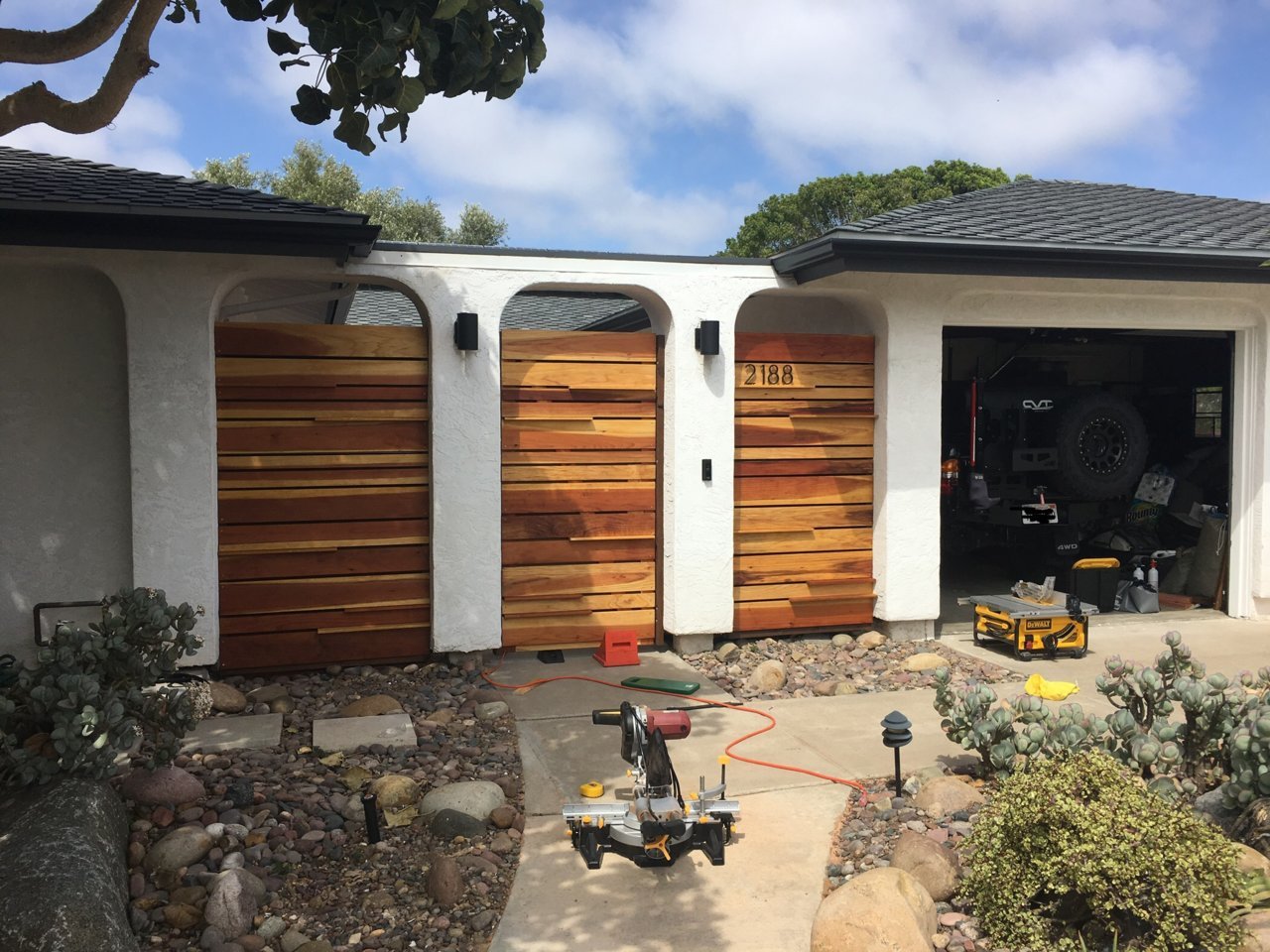

    Found a cool pic of a front gate online and bought a table saw. Was pretty fun, not as crazy as some of the stuff on here but fun for my second table saw experience. Just waiting on hardware for the gate to show up n will rip the trim on the bottoms and the edge trim for the gate4BED76B4-F3CA-465C-9A6B-8523EE443D5A.jpg

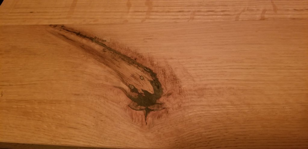

    Working on a counter for the laundry room. Had this beautiful knot in a piece of wood. Filled it with epoxy and it looks good.

    What type or brand of epoxy?
  17. Jun 22, 2018 at 10:52 AM
    #2317
    krap22
    krap22 Well-Known Member
    Mar 20, 2011
    #53389
    21,287
    west systems epoxy.
    i've also used the loctite 5 minute expoxy as well. It works well if you are tinting it. if you want it clear, you need to buy a special hardener from west systems otherwise it's kind of a yellow color.

    I filled a knot on one of the Salt &Pepper mill I made a while back, I used super glue and shavings from the block of wood. cant hardly tell it was an open hole...but its sealed up now.
