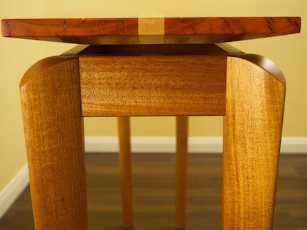

    Console table in mahogany and birdseye maple.

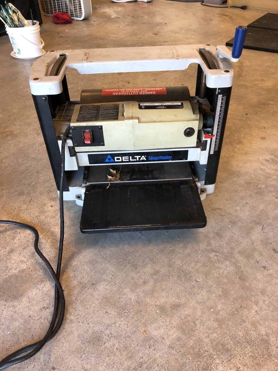

    351127F3-EDDC-46A9-8819-849EAA178809.jpg Picked this little Gem up for 40 bucks at the neighbors garage sale today !

    I’ll give you $41 for it! Just kidding, great deal!

    The blades are relatively easy to change. I have a Delta also but its blueish green color. They are good machines.

    I need to give it a run down and see the blades Are any good.

    the black cover on the back side is what comes off to check/change the blades. has 2 small wingnuts on mine and it comes out kind of clunky like but you dont need to take apart anything. I didnt have the manual so I had to figure it out.

    Great looking table! Love the curve on the tops of the legs and how they taper. Did you do that all by hand? Any pics of the process?
