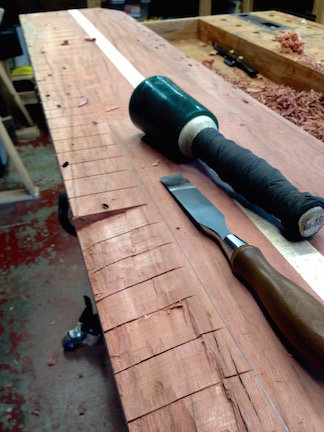

    Thanks Barry. The rough dimensioning was done with a buddy's table saw and thickness planer. Everything else was done by hand. The only shot I have shows how I shaped the underside of the table. Relief cuts, chisel, then plenty of hand plane work. It was surprisingly easy to taper and shape the legs by hand, especially since they only have to 'appear' to be the same. If someone wants to get down there and measure, more power to them.

    Thanks @Bman4X5. Nice work. Guess I just need to take the leap and give it a try. I hear you about the fact they don't have to be exactly identical. That's a good point.

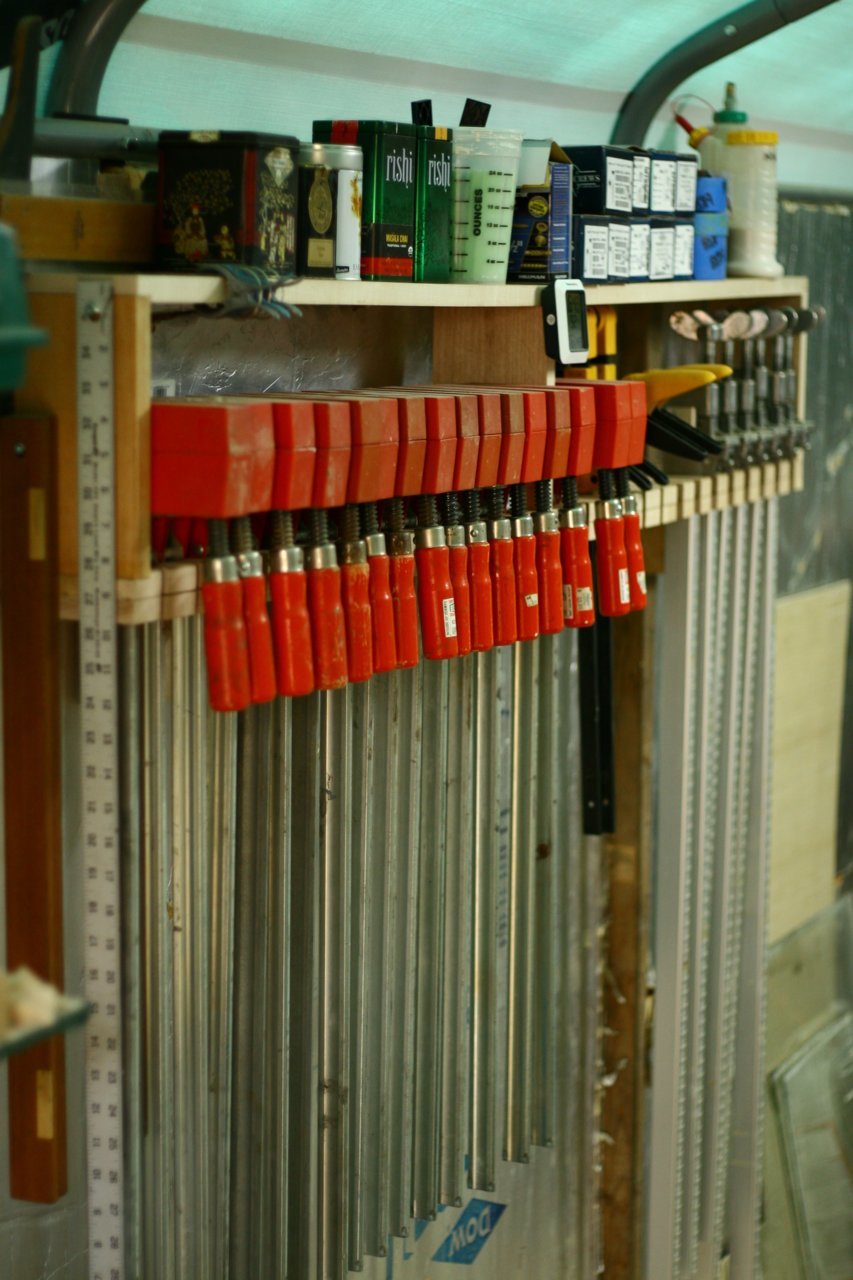

    I really like Bessey, great clamps. The older ones are pretty stout and can be had on ebay for a lot cheaper than new. I'm a big fan of their parallel clamps

    i have 4 of the older bessey's that are 48" and i have 4 jhorgenson's that are 24" long. They are well worth the price, expecially if you can find them on sale.
