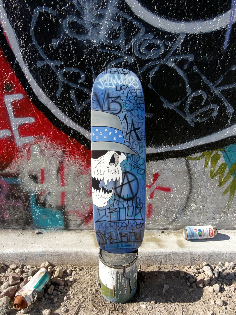

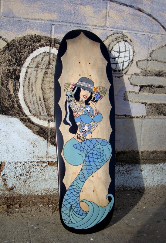

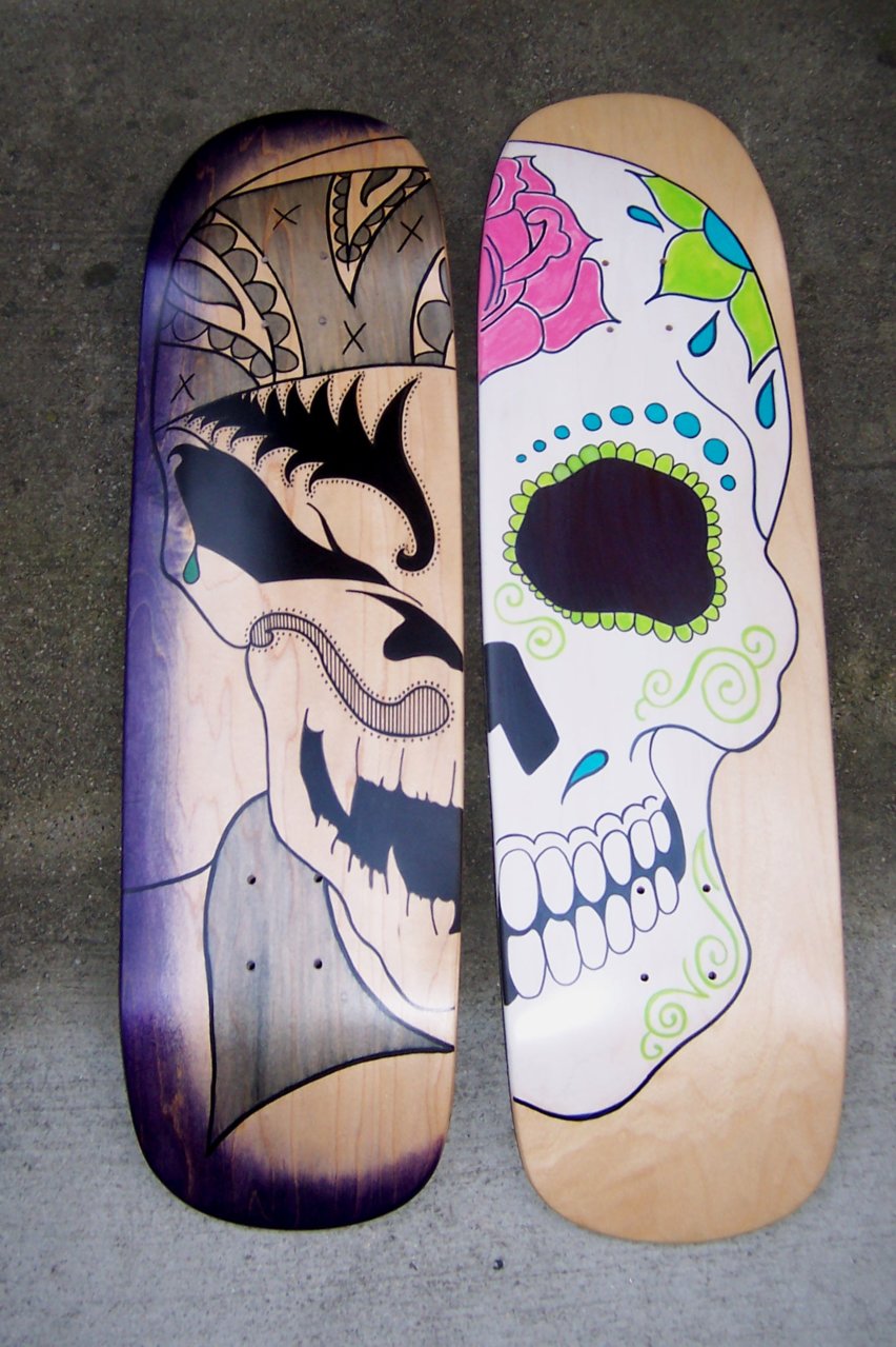

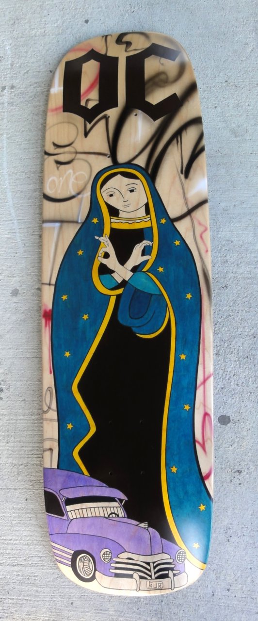

    A few of the boards that I shaped and painted over the years..

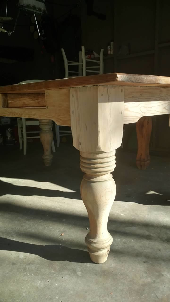

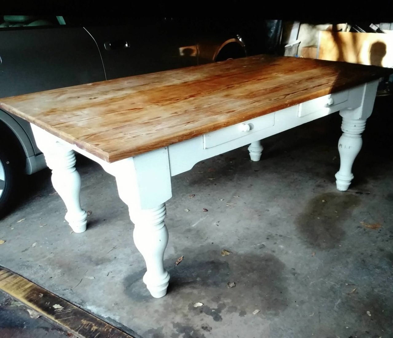

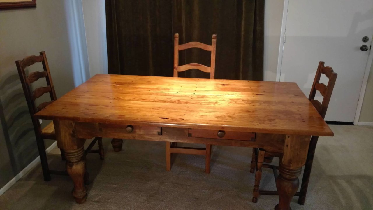

    I scored this pine table from one of my clients a while back. I live in an apartment and I don't have any electricity in my garage so I did all the sanding and finishing entirely by hand.
    I used a two inch scraper then hand sanded the rest of it. I used stripper and scotch bright on the detail on the legs (woulda been much easier with a heat gun but no power).
    The apron and legs are stained then finished with a hard wax. The top is stained, two coats of oil poly, final coat water based poly (satin).
    I've been sanding hardwood floors for nearly 30 years, and 20 years ago we used to hand distress flooring on benches then install and finish on site.
    Since I didn't use any electricity on this project I like to tell people that I did this Mexican-Amish style :D

    thats some dedication. Looks great, very rustic!

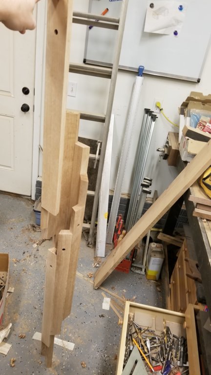

    Stocking hanger is coming along nicely. Still working on the base.

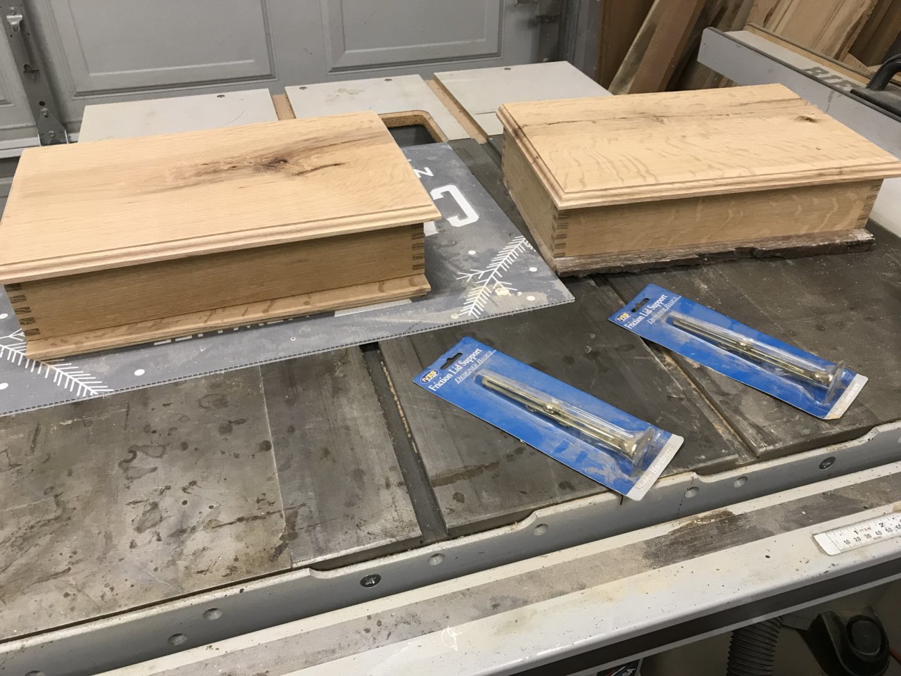

    This is going look great oiled up..
    Probably gonna use a green epoxy in the seams...

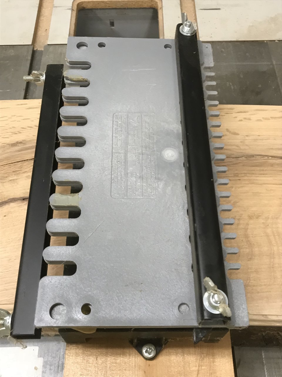

    How do you cut your box joints? I have been looking at a table saw jig.

    Vermont American jig from WoodCraft. Also a diy depending on the piece..

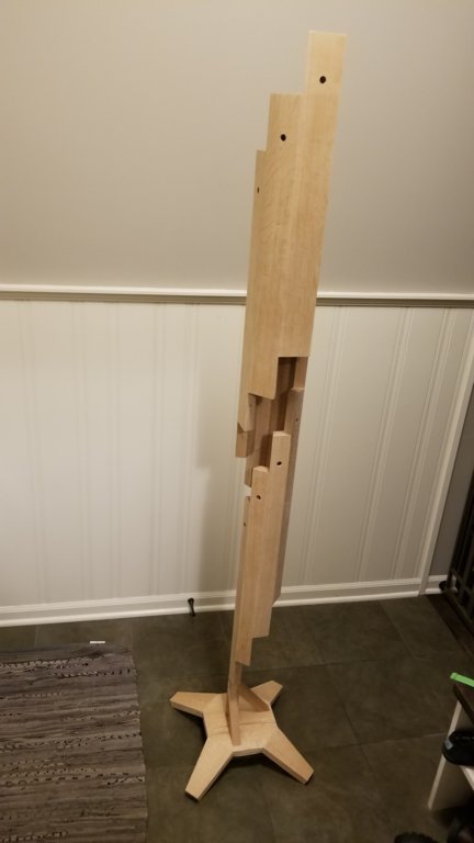

    Getting closer....
