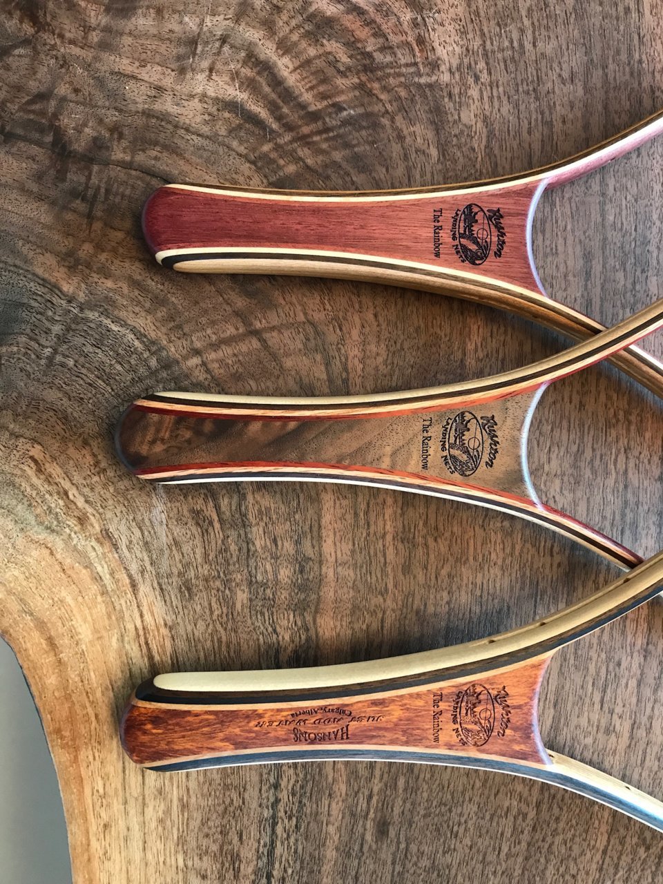

    I make wooden landing nets using exotic and domestic hardwoods.

    Amazing. That's something I want to try. Do you have an resources for source material on the netting?

    I buy the material in bulk and make up my own bags to suit.

    I've got it down to a science now, after doing it for so long. I've got good jigs and have made or modified machines to speed up build time. Depending on the size, it takes anywhere from 75-120 minutes start to finish.

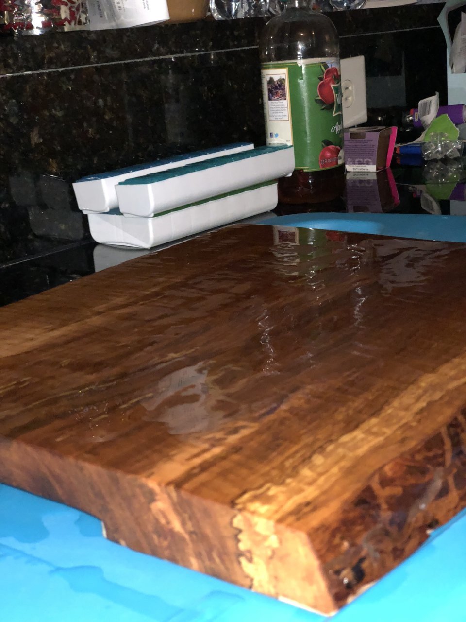

    Poly finishes aren’t the best if you’re going to actually use it as a cutting board. Being a film finish, once you start cutting on it you’ll break the film layer and you could get flakes of the finish in whatever you’re cutting. It also makes a passage for water to get under the finish and start to lift it. If you use an oil finish it’s easy to touch up by giving it a light sand and applying another coat of oil.

    General Finishes makes a "salad bowl finish" which is a non-toxic (when fully cured) oil finish. I use it on all my cutting boards.

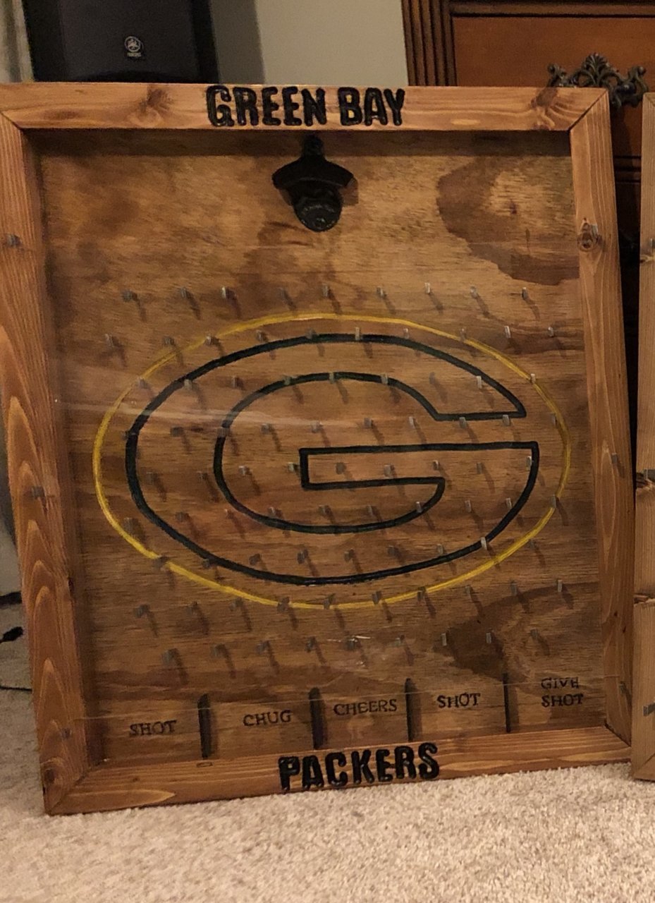

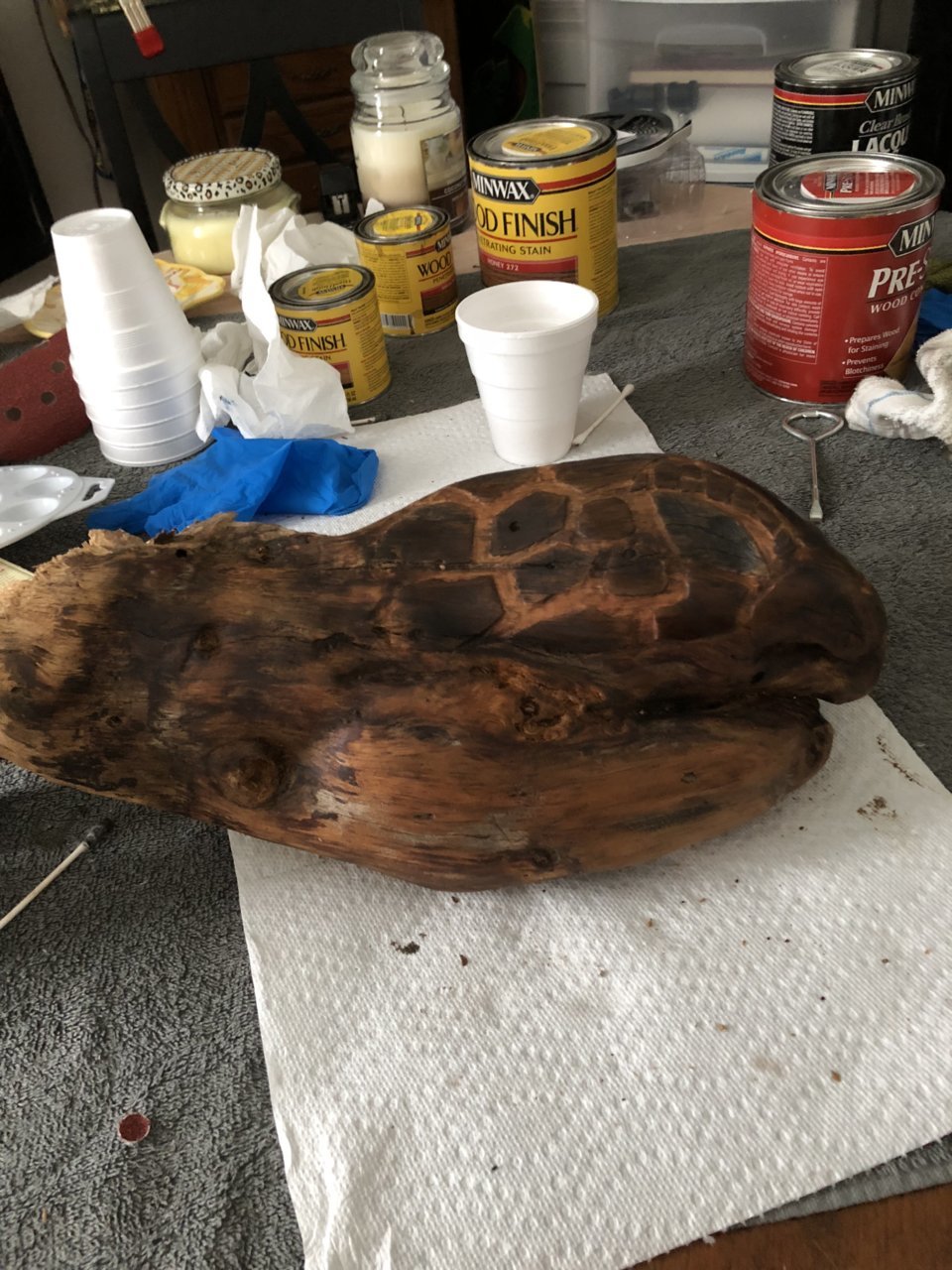

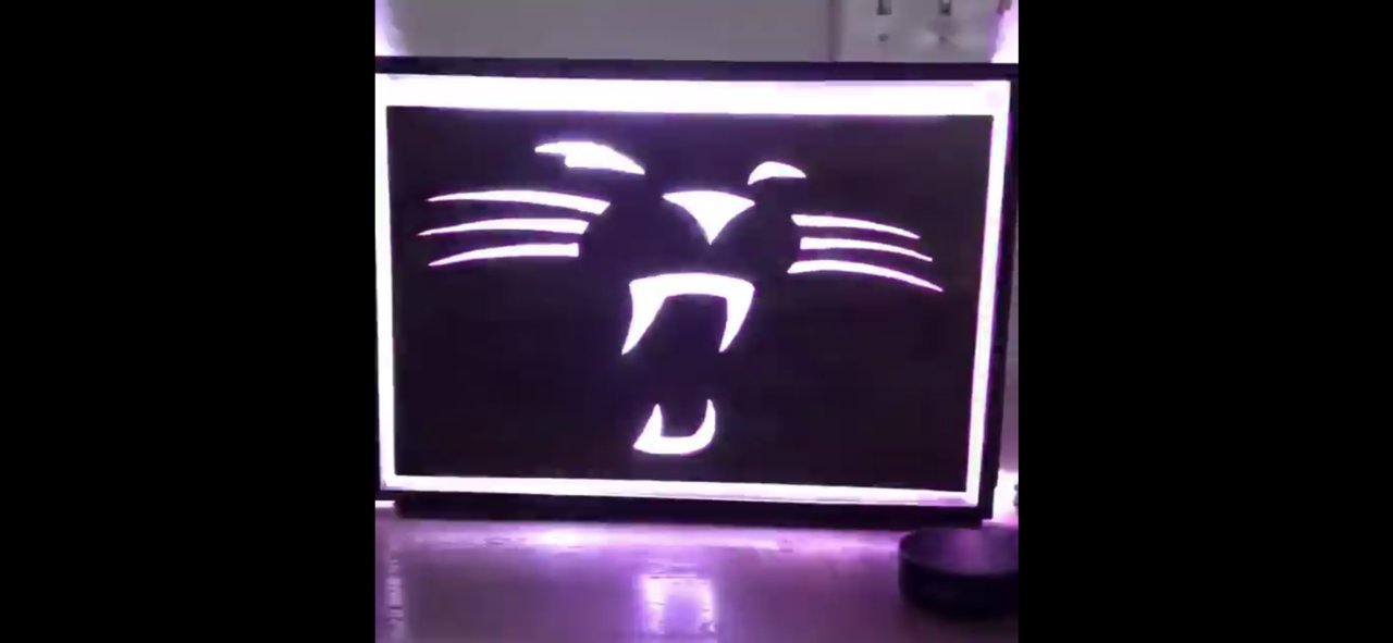

    Some of my projects include:
    •Panthers wall lamp
    •Pecan charcuterie board
    •Driftwood turtle head (still needs to be mounted)
    •Unfinished wall lamp gun box
    •Drinko Plinko boards
    All done in my apartment haha

    I use it also. And mineral oil can be used in a pinch.

    On an end grain cutting board, i thin it about 50/50 with mineral spirits. That allows it to soak down in deep. I add a few coats this way and then finish up with a full strength coat on the cutting board.
