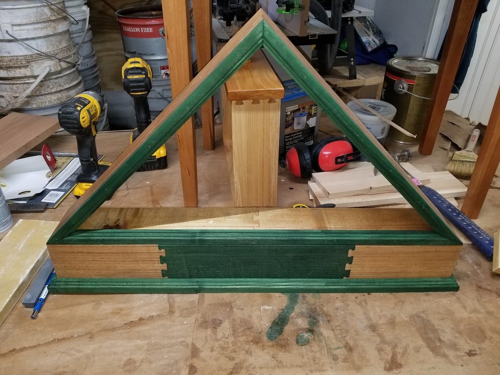

    The green portion on this flag case was dye with TransTint green.
    http://homesteadfinishingproducts.com/wp-content/uploads/2017/10/transtint_chart_2018.pdf
    It's an alcohol based dye that you put directly in denatured alcohol. The more drops you put in, the darker it will be. You wipe it on and let it dry. If it runs or you have light spots, just apply more. It its too dark, just wipe it with an alcohol soaked rag and it will put some of the dye off. I would definitely test it on scrap wood to get a feel for it...and wear gloves and clothes you don't care about.

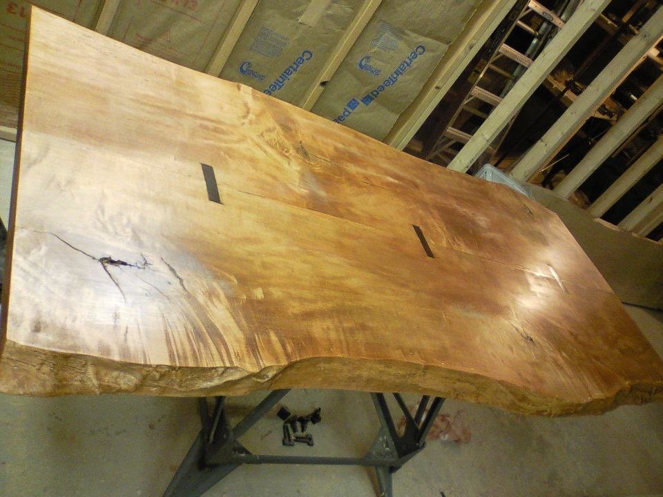

    I second this product!
    You can actually mix this with alcohol or water, which is really nice and makes it a bit more flexible, depending on what your clear coat will be (don't remember if you mentioned what you're using or not). I know you're going for the green, but you can get some really interesting looks when you layer several colors.
    Used two different TransTint dyes for this maple bar top I did about 8 years ago:

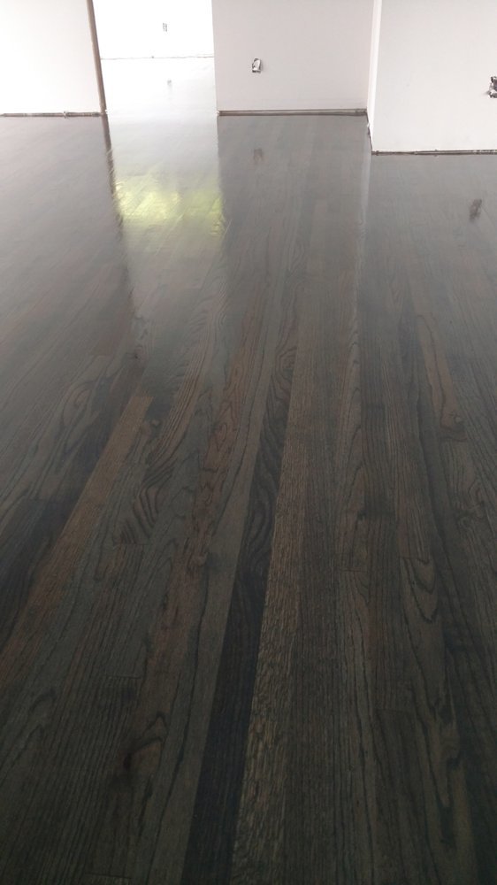

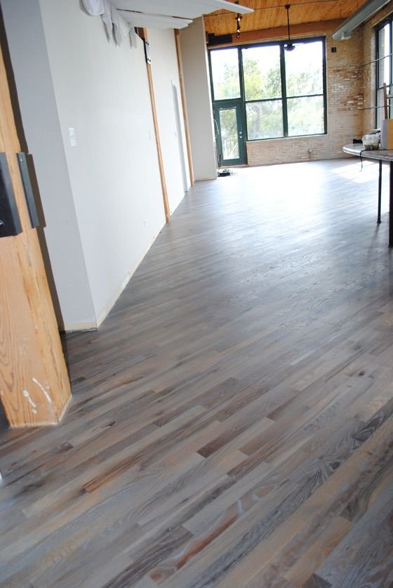

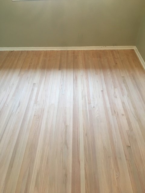

    I've been sanding and finishing floors since 1990. My advice would be not to try and do it your self cuz with the trial and error factor you'll probably end up spending just as much as hiring a professional.
    BTW, the first pic is red oak, very common in most mid century homes. Whatever the original color of the wood is it will also contribute to the final color - so grey over red oak, the red will show through unless you go with a very dark grey. That said you also have to know how to prep it to ensure that the color penetrates as much as possible, and there are also very specific non-yellowing finishes recommended specifically for white and grey stains. Staining a large area properly is actually a whole other skill level (compared to natural finish), that even a lot of professionals don't ever master with consistent results.
    Grey over red oak.
    More Pics ~ https://www.yelp.com/biz/nicolas-hardwood-floors-santa-ana

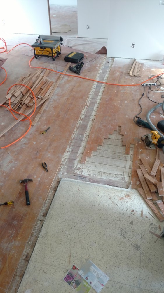

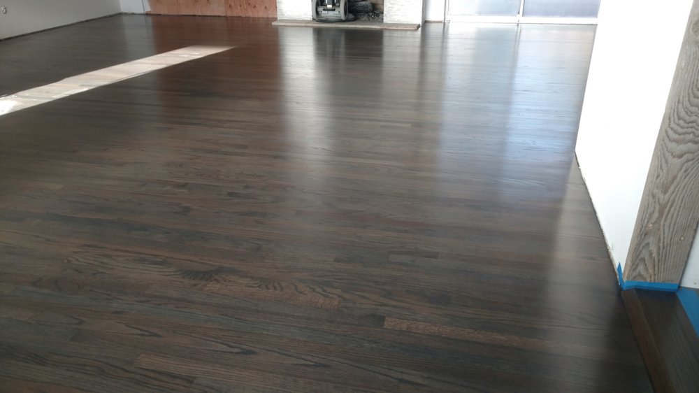

    Before
    After
