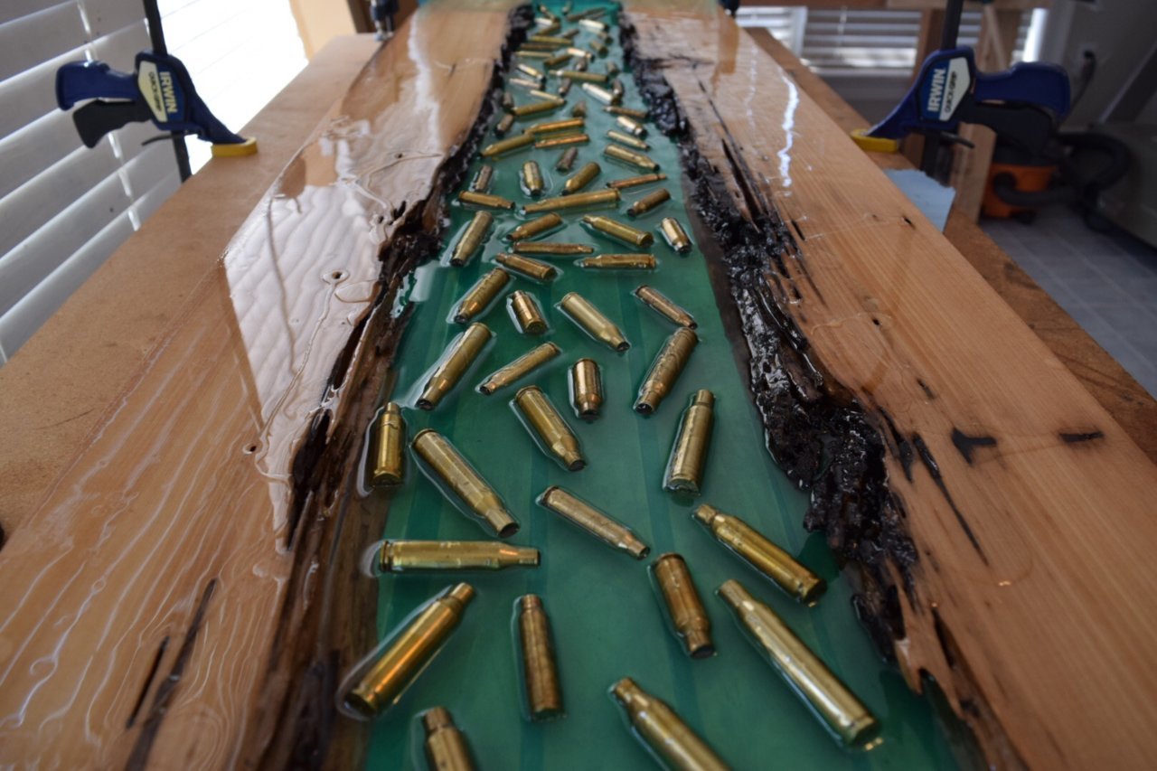

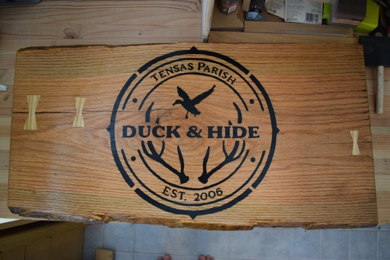

    Working on some camp projects lately. Finished up the sign to give to my dad for his birthday. The bullet thing is getting close to done, just have to sand it and pour the flood coat. I don't have any current pictures of it, but it's closer to done than this picture shows.

    thats neat looking!

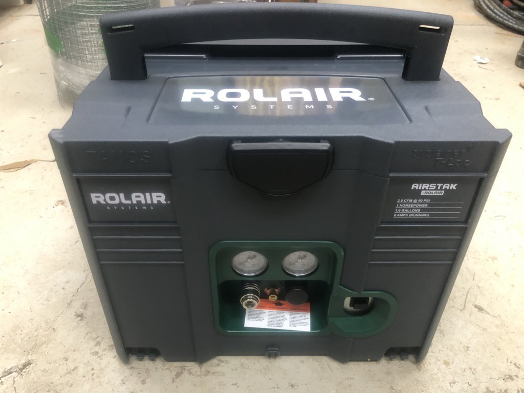

    I just got this , you might be interested haha

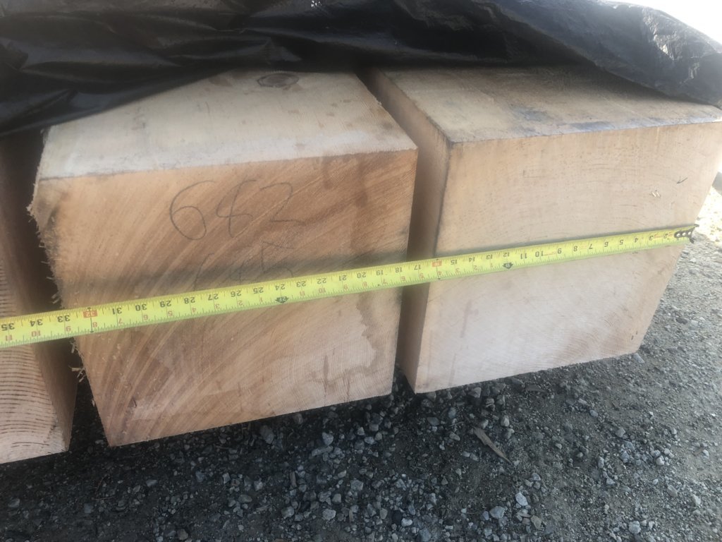

    The woodworkers in here might appreciate this
    Saw these monster timbers at my timber guy's yard yesterday , 18' long , #1 FOHC Douglas Fir 16"x16"

    not cheap...wonder what one beam costs?

    I didn't even ask but if I had to guess , probably $2K range
