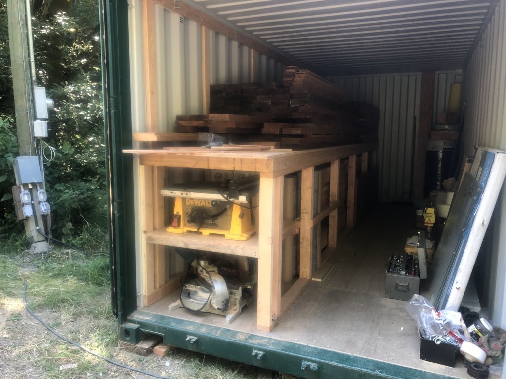

    Fir downstairs , cedar upstairs
    As this container will be my home base while I build my shop / storage building , I made a shelf to house my chopsaw and tablesaw when they are put away

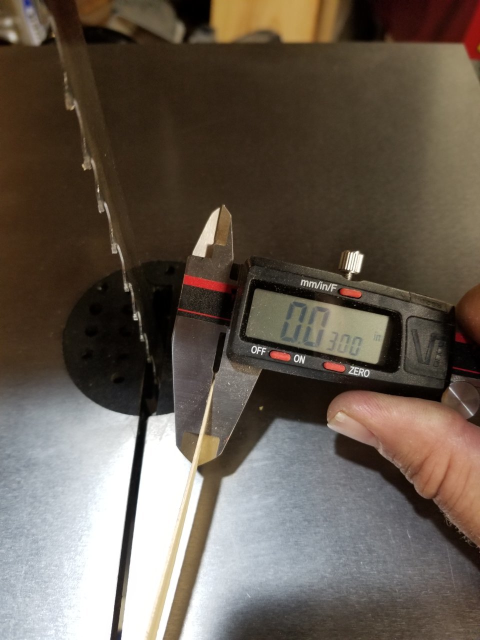

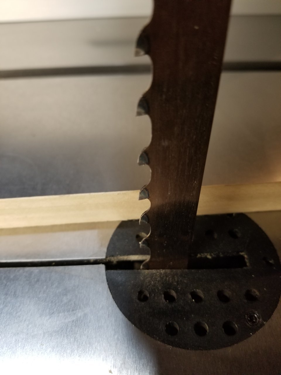

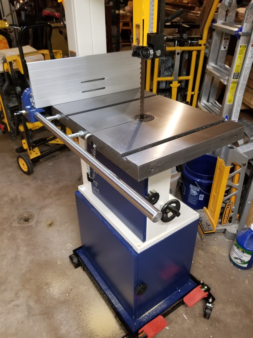

    I got the bandsaw put together and tries out the Laguna Sawking blade.

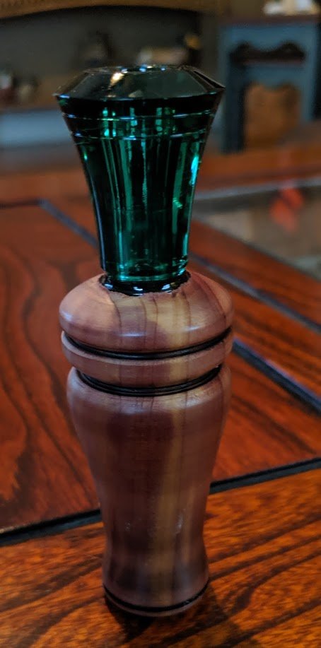

    Turned a couple more duck calls this weekend. One in cedar the other in cherry. Was worried the cedar wouldn't hold together for turning but it actually came out nice.

    Nice. How are making those dark lines? Are they painted or burned?

    The thin lines are first turned in with a fine tip then I burn the line with a braided copper wire while turning at high speed. On the cherry one the thick lines that fade in are burned in using 600 grit sandpaper, high speed and pressure.

    Those are aggressive teeth!
    interesting!
