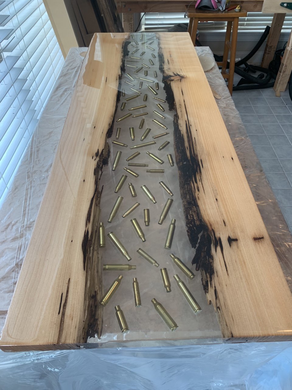

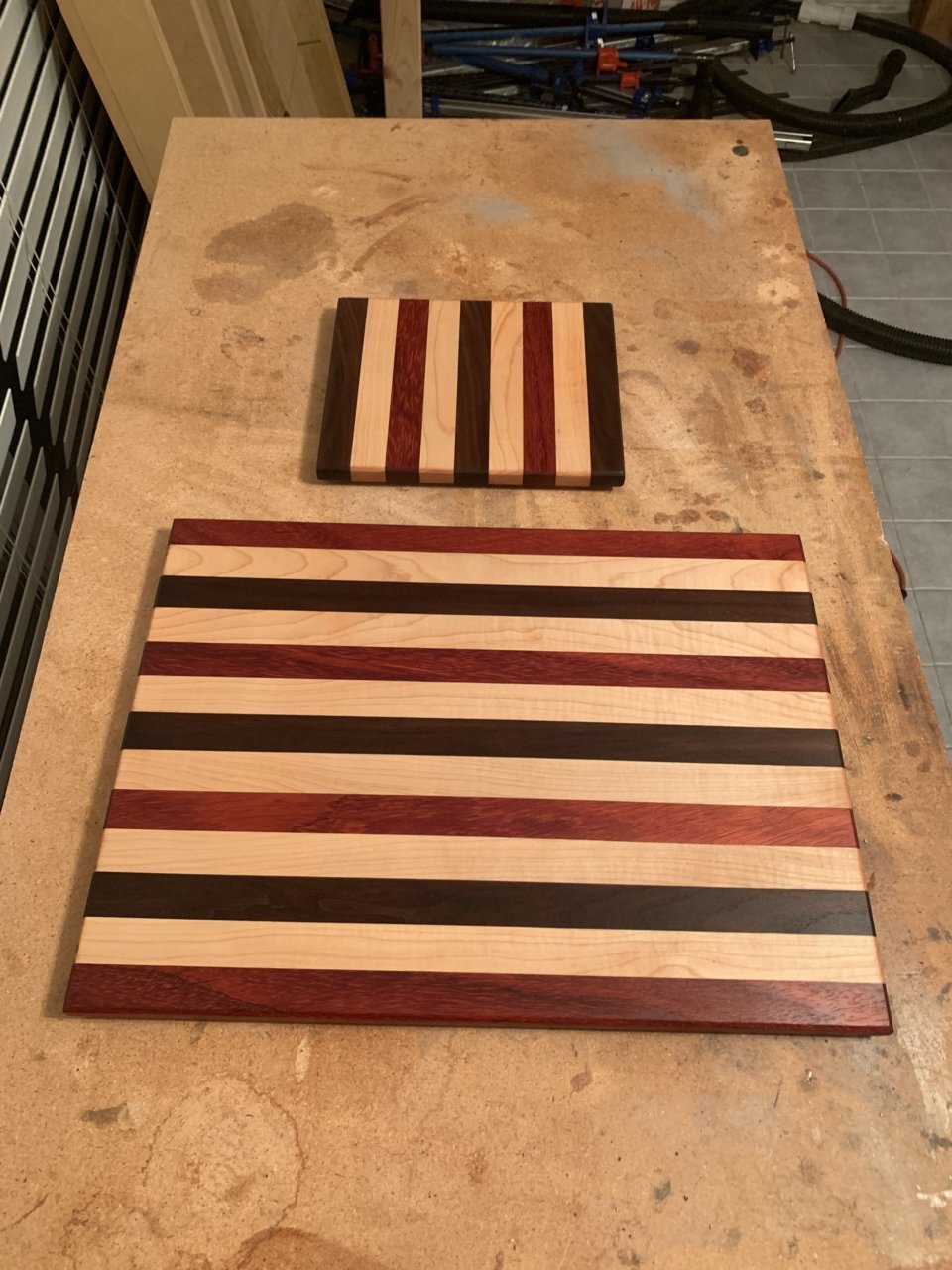

    Just finished up the two cutting boards. Both are maple, padauk, and walnut in different patterns. I couldn't remember if I ever posted a finished pic of the bullet piece either, so here it is.

    Nice!

    Was thinking that bullet table would make a real cool gunsmithing bench top till I saw the price of that much resin!

    Is that a bunch of 300wm brass in the resin?! Im getting into reloading and thinking I might have to steal your idea for making a workbench space.

    That's a great idea! It's really not all that hard, just takes some time and patience. There's actually no 300wm in there, it's a random mix of 270, 5.56, 243, and 6.5g

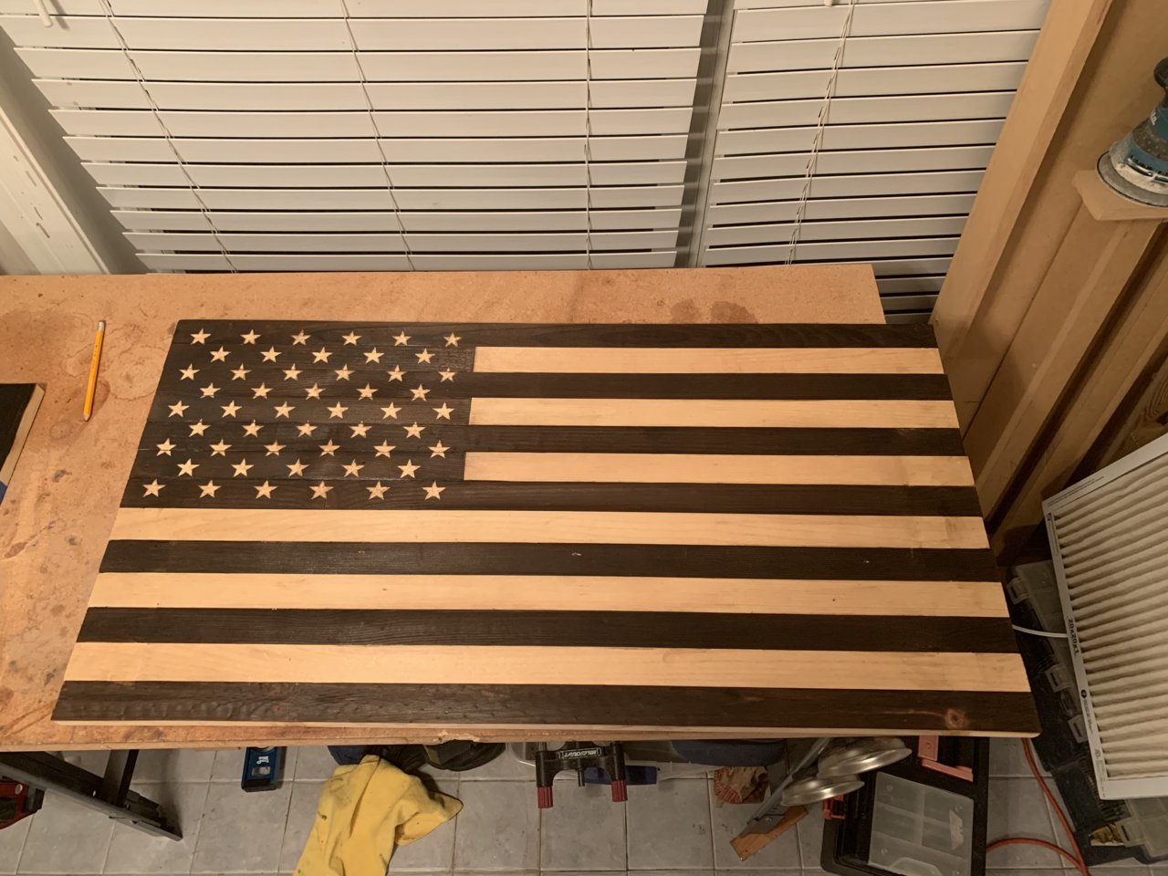

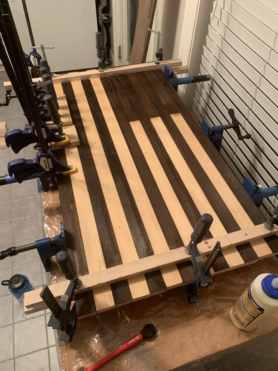

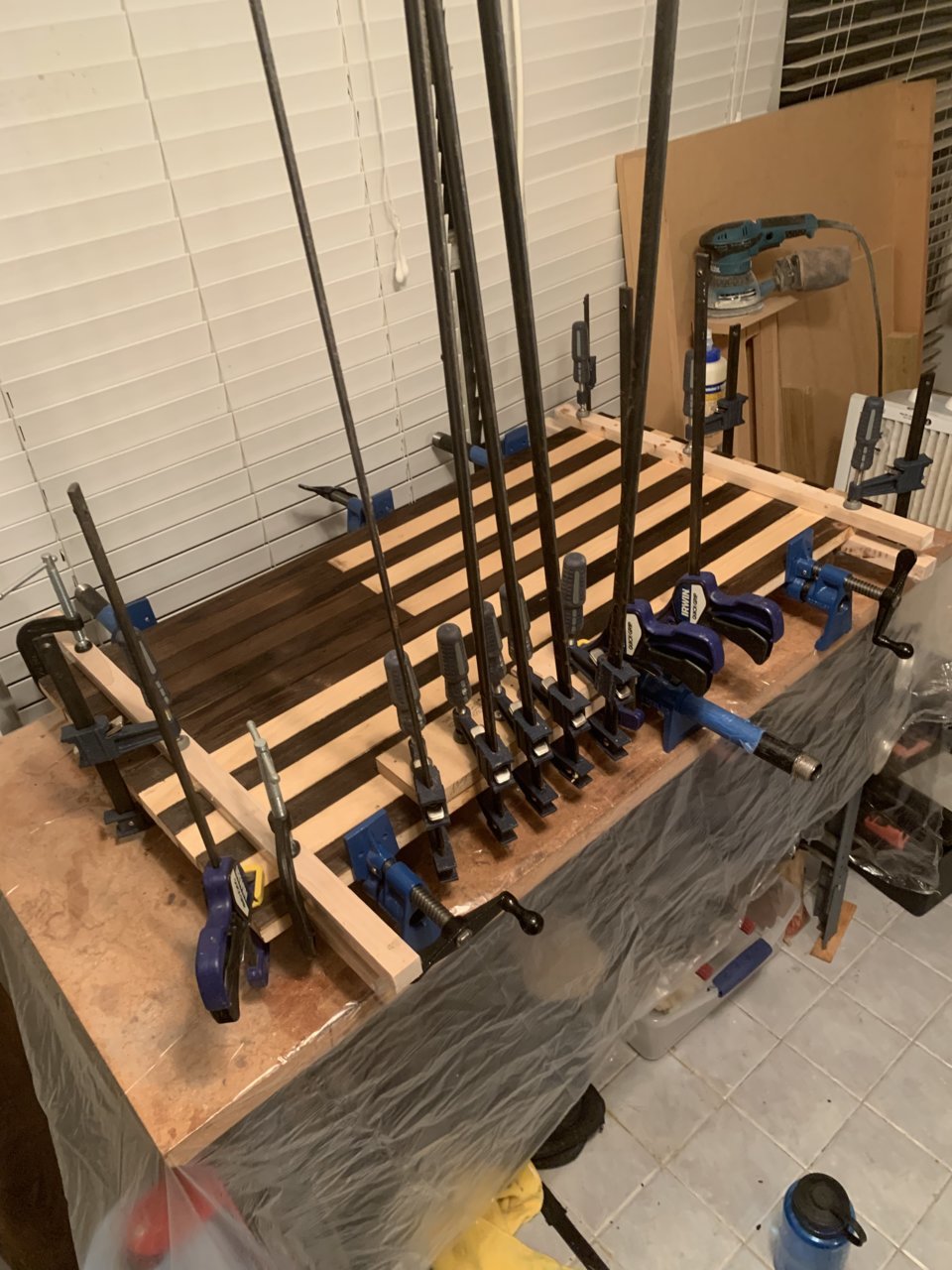

    I've always thought the idea of these "concealment flags" were kinda cool. Tonight I decided to give it a try. I've made a subdued flag like this before and really like the look. The extra seven clamps in that one spot are from the last board warping from the heat and it actually seems to be leveling out. Hopefully tomorrow I can finish it up.

    Thats cool! about how long is the flag?Im working on a couple flag projects myself;)

    I try to follow the real dimensions so with 1.5" stripes it's 37x19.5. If you look up American flag dimensions there are plenty of charts and pictures that give the ratios and measurements if you're looking to make one smaller or bigger. I also do this cause I have several sizes of stencils for the stars that makes carving them easier and they all use the original flag specs.

    Looks great! What kind of price you putting on yours? Just curious

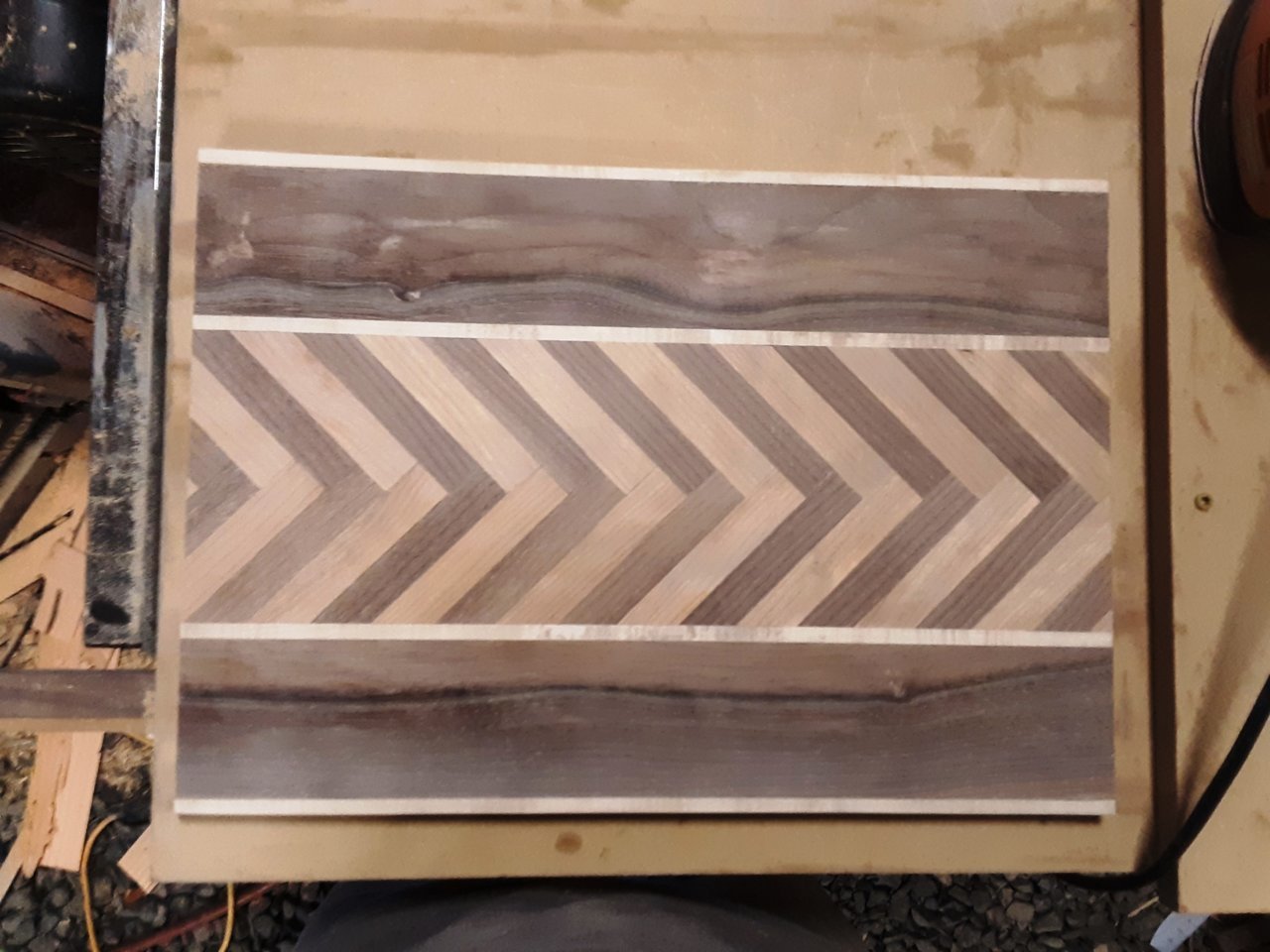

    Not oiled up, and needs the feet but mostly done ;) Not a thick board but still decent.

    Nice design!!

    Did you make the dark strips via shou sugi ban?

    Im getting better;) Helps to finally get my fence straight...:anonymous:

    Sure did. Just took a propane torch to them and brushed off the surface with a wire brush. Finished it with spray poly so it doesn't all rub off.
