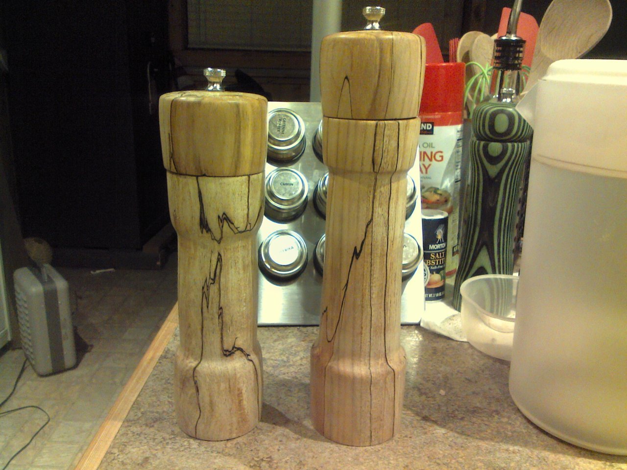

    hang on I'll show you some spalted maple mills I made.
  12. Sep 17, 2019 at 11:04 AM
    #3612
    wilcam47
    wilcam47 Keep on keeping on!
    Jan 27, 2016
    #176243
    54,486
    Will
    Bourbon state
    these are spalted maple...see the grain difference
