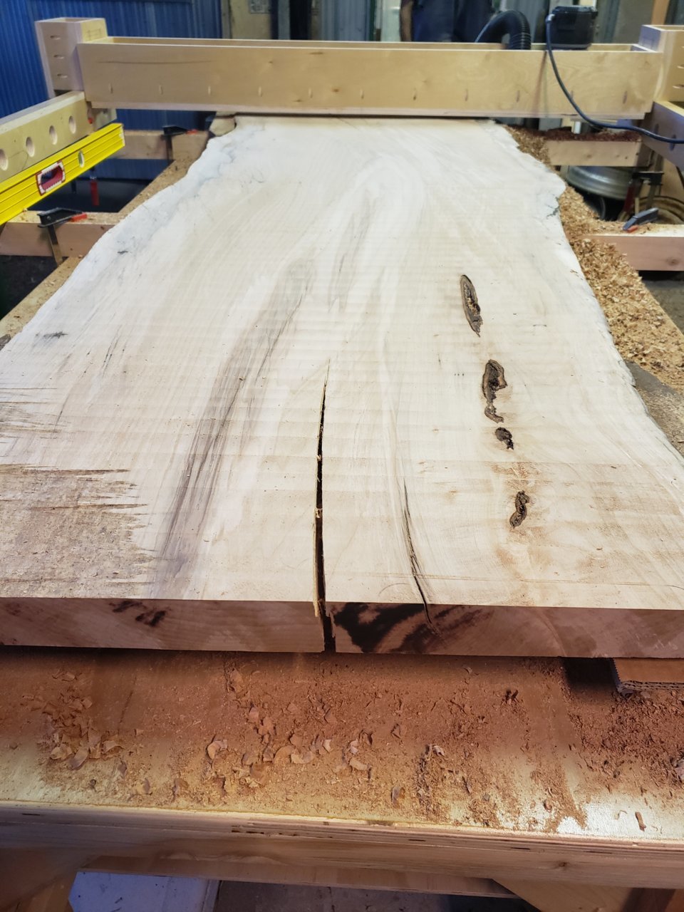

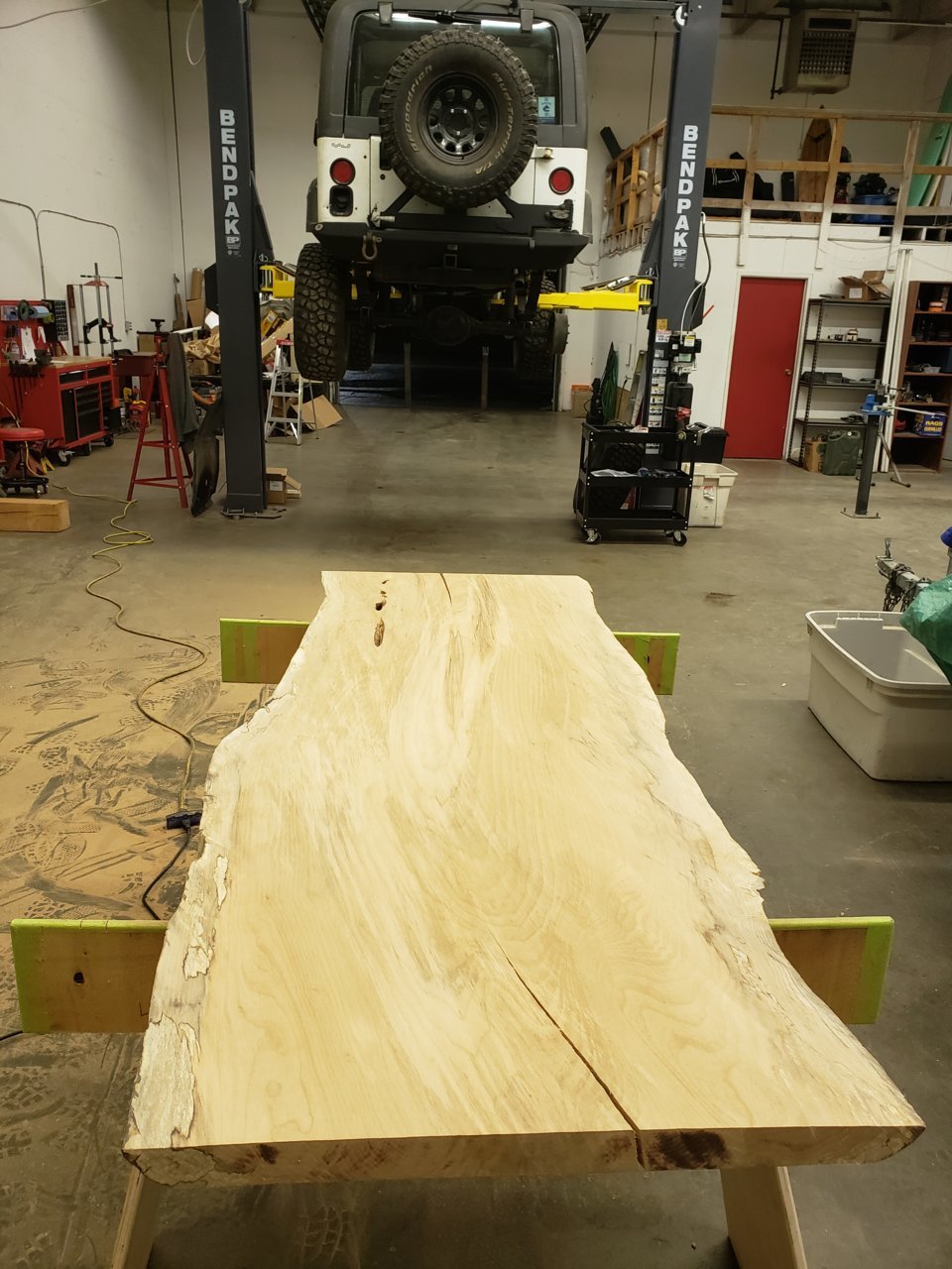

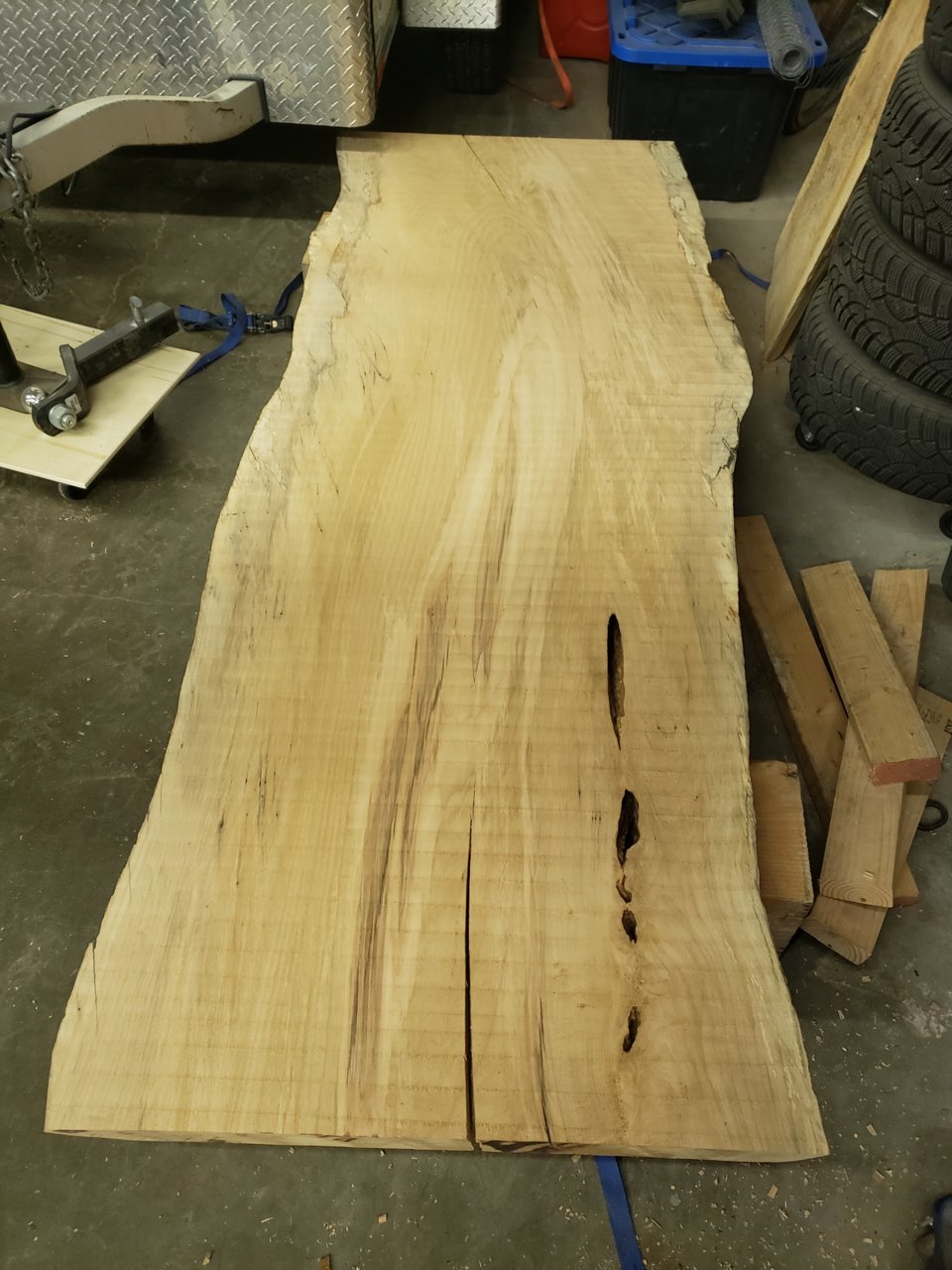

    I haven't posted in this thread before, but I'm working on a live edge table right now for our kitchen. It's a maple slab my friend milled. Router planed it last night, and I sanded it down to 50 grit tonight. Lots more sanding to do before some bowties and epoxy. Also have to weld and powder coat the legs.
    Planing:
    20190916_192153.jpg all flat:
    Sanded (don't mind the customer's Jeep in the background...):20190917_205648.jpg
    Hard to see how cool the grain looks in the pictures, but there's some funky spalting on the edges which makes it unique! Really excited to see it all come together!
    The slab is just shy of 7' long, and averages around 33" wide and is 2" thick after the planing

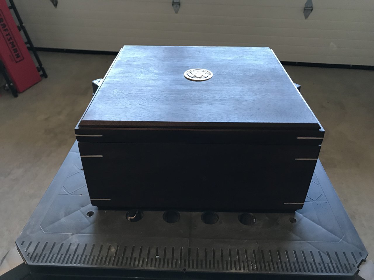

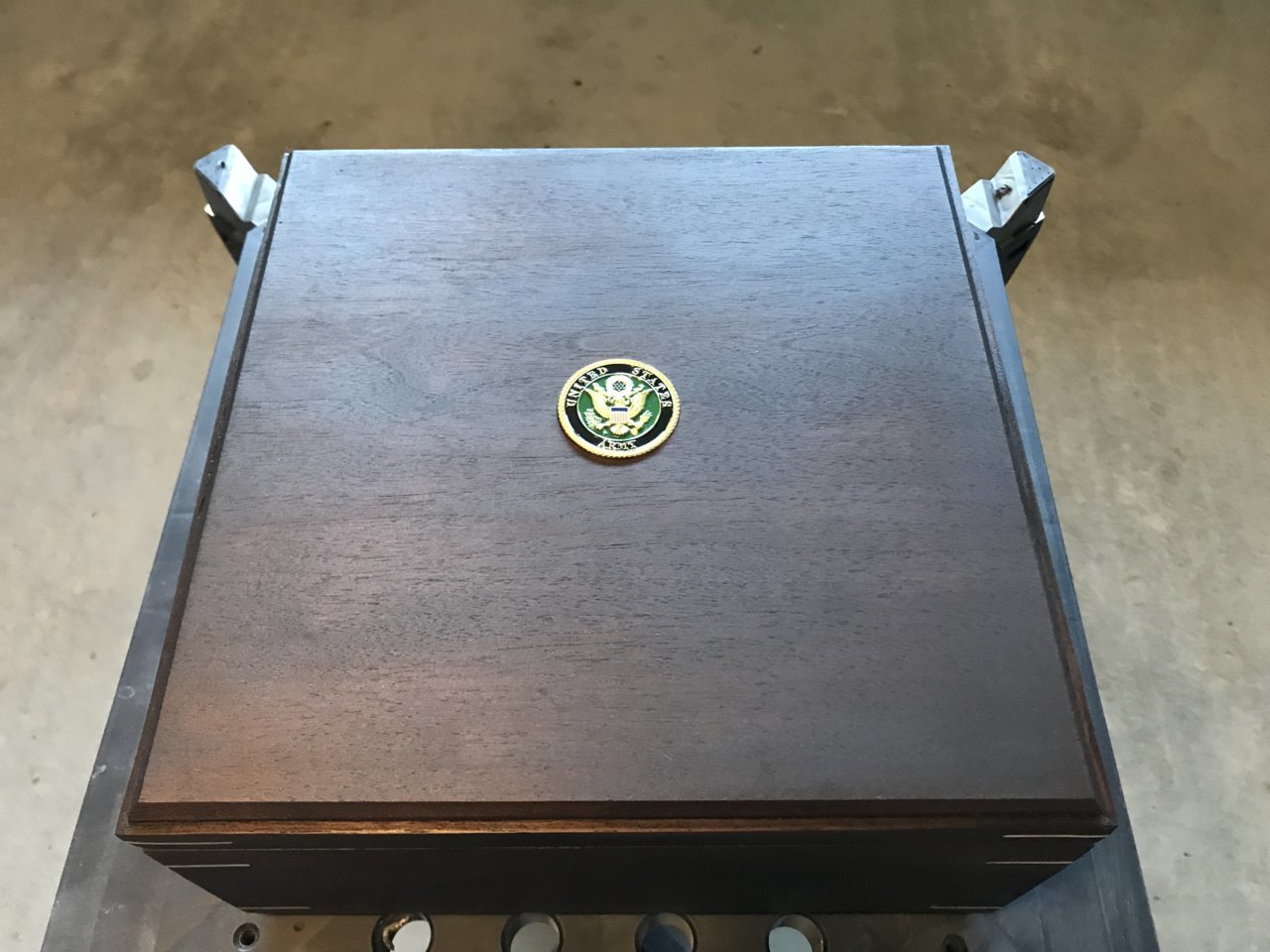

    Got the miter keys cut down and sanded. Had some corner tear out but I guess ok for the first attempt with miter keys. Drilled out the coin slot and test fit. Now to lacquer, send the top off to get the inside engraved. Then velvet line followed by glass and decanter support. Much more involved project then I originally intended!
