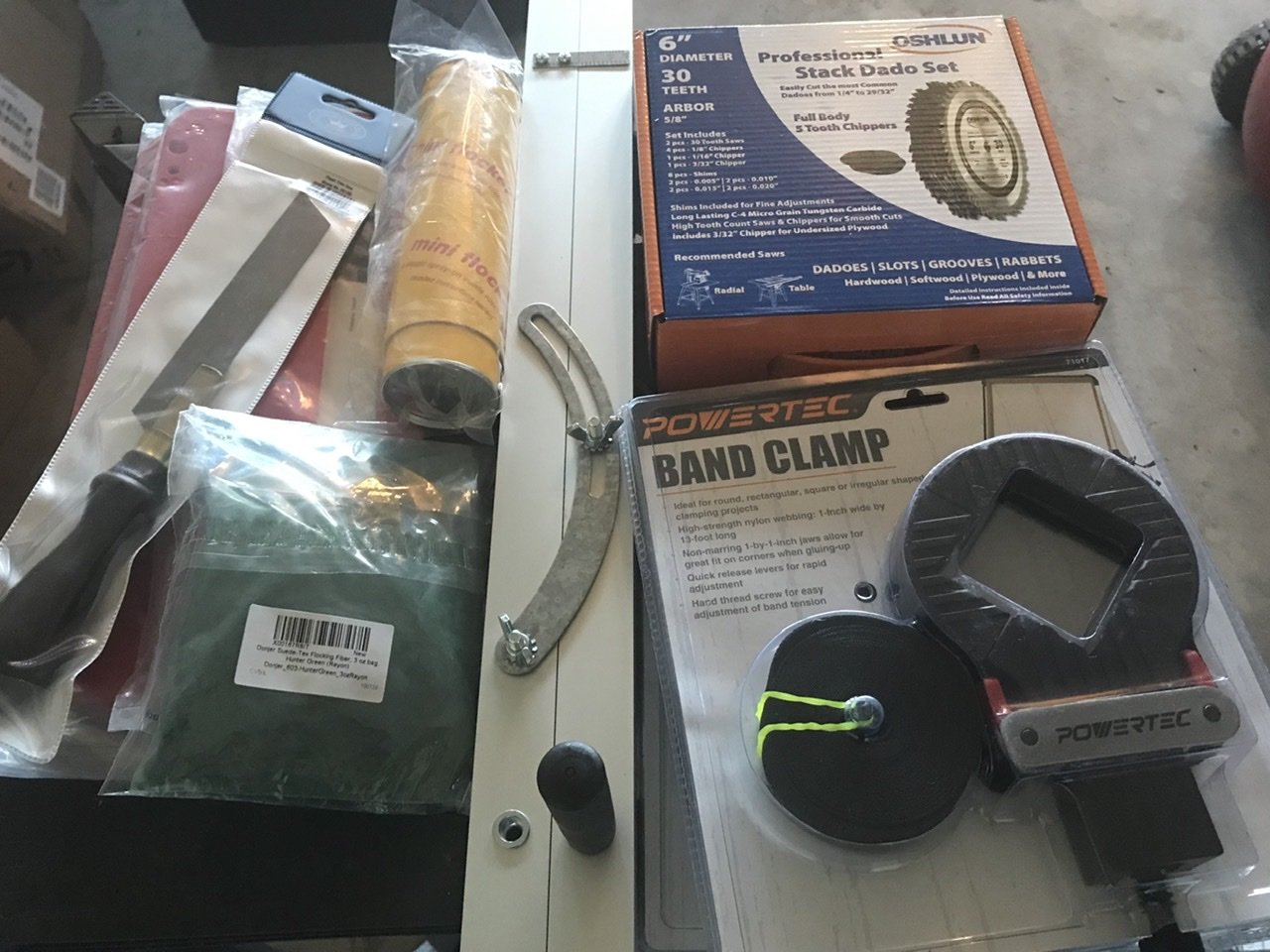

    Merry Christmas everybody!
    Ok maybe just me... but I am one step closer to finishing up my box now. Got some extra stuff while I was at it.

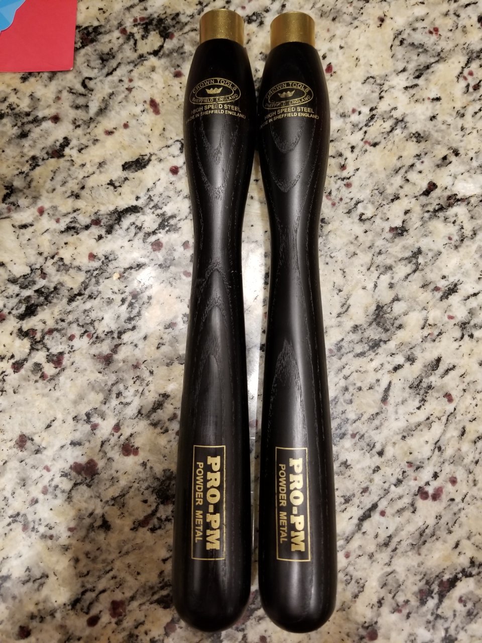

    Now I just need the pointy ends...
