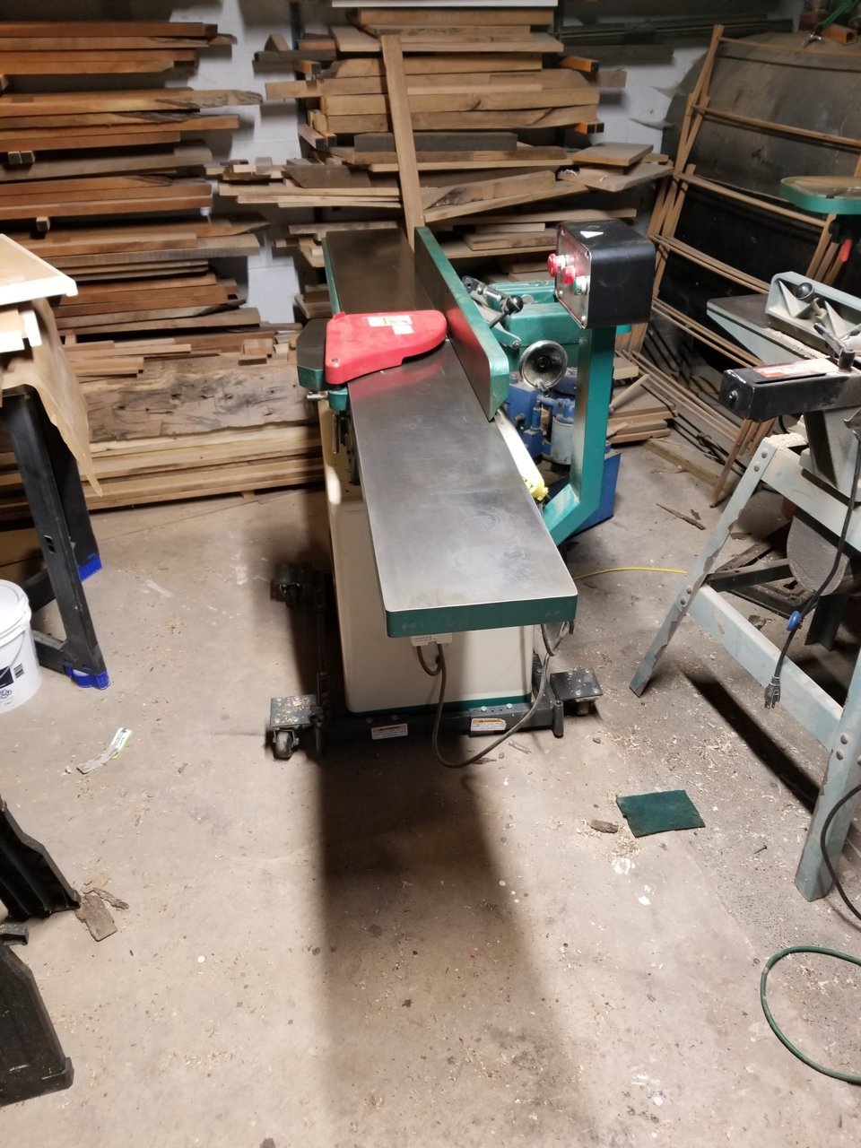

    Haha, John has some cool stuff in his shop. A lot of his tools are homemade. I don't have that issue on any of my saws. I can reach the nut just fine when the blade is at full height. He definitely has a great design mind though.

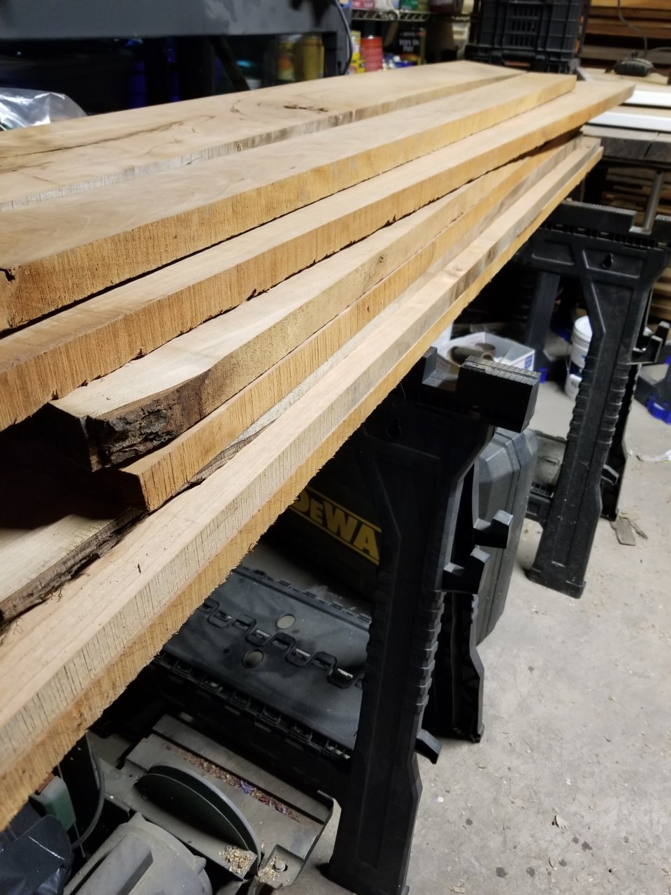

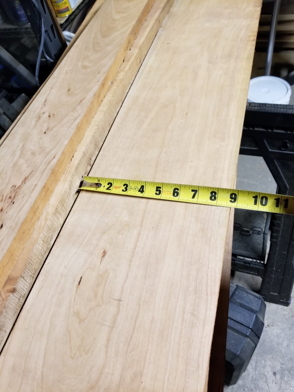

    Blades sharpened, fence set, time to mill some cherry15706720113426921638660719228169.jpg

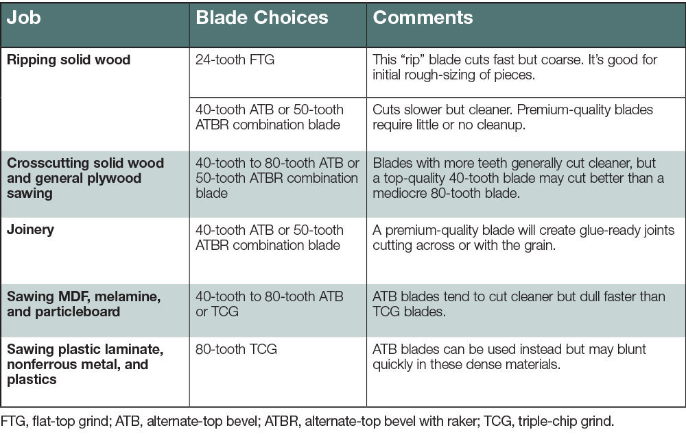

    Read this... more teeth isn’t always better.
    Edit: added quick ref pic.
    https://www.woodcraft.com/blog_entries/choosing-the-right-table-saw-blades

    They should all cut it straight. More teeth is generally for finer finish.
    A ripping blade would be the best, combination blade next.
    This combination blade will do both rip and crosscut. If you're cutting 10/4 board, take some shallow passes first.
    https://www.homedepot.com/p/Diablo-10-in-x-50-Teeth-Combination-Saw-Blade-D1050X/202786854
