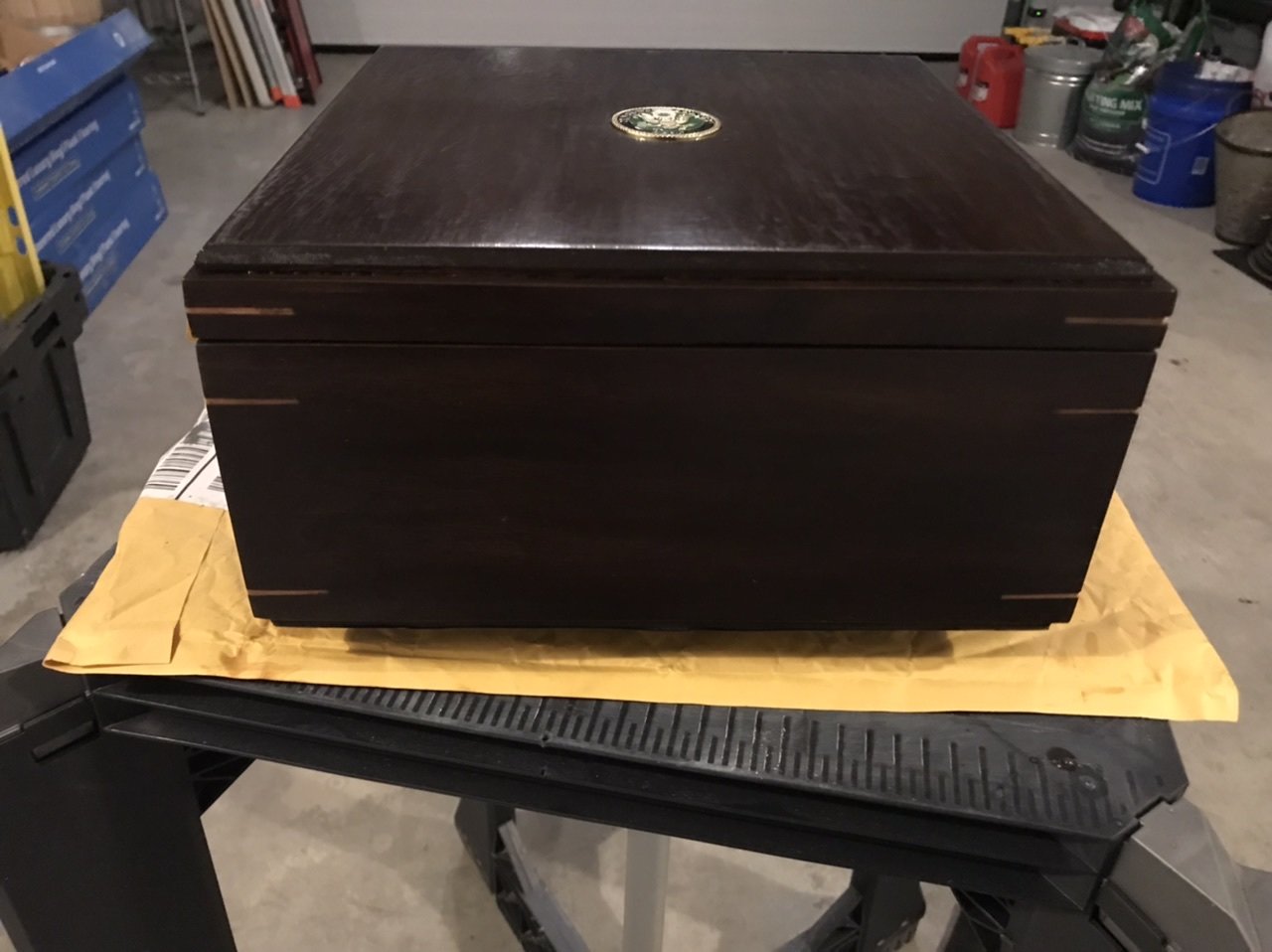

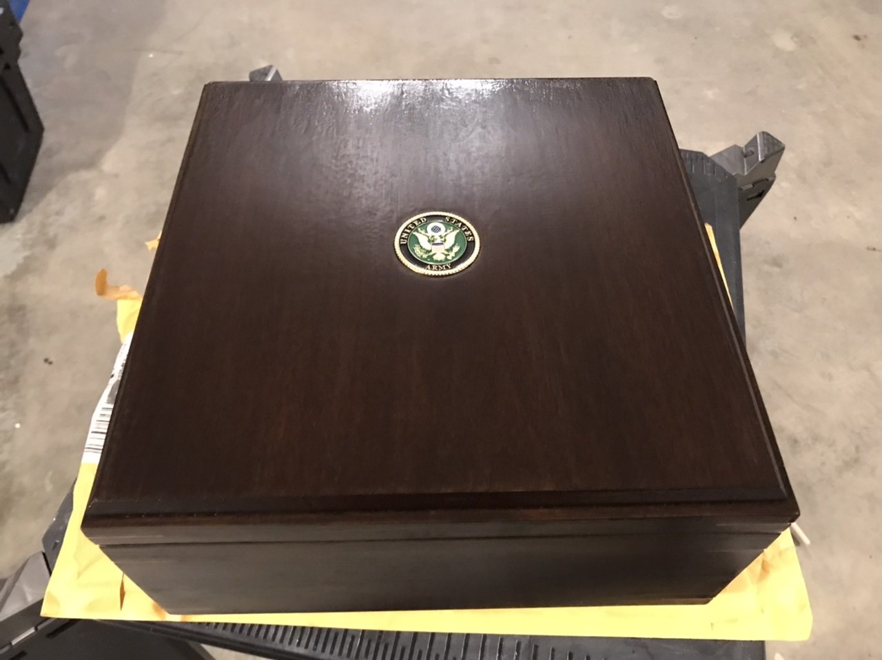

    lol keep in mind the vast majority in here only have good looking stuff in online pix.
    My box looks great on here but I already stripped the finish once and reapplied and under the light I can still see variances in the thickness of the lacquer.
    Can’t speak for the rest but compared to actual legit “woodworkers,” I’m a complete novice.

  15. Oct 11, 2019 at 7:38 AM
    #3835
    98tacoma27
    98tacoma27 is going full "SANDWICH" Moderator
    Dec 18, 2008
    #11714
    67,858
    Ben
    Not Beech Creek
    05 Tundra SR5 (+295k AND COUNTING), 2006 F350 King Ranch 6.0L
    Some stuff. Not a lot, just some.
    It's all about the camera angles... ;)
  16. Oct 11, 2019 at 8:22 AM
    #3836
    shane100700
    shane100700 Bed, Bath & Beyond Crawler
    Jun 1, 2011
    #57578
    7,012
    Montana
    2019 DCSB, OR
    Rocket Boosters
    No thanks, did that cutting the 2x6’s for the shed ramp.
    wilcam47 likes this.

    Bourbon state
    how many coats? and did you let it dry and sand with fine grit sand paper between coats?
  18. Oct 11, 2019 at 9:57 AM
    #3838
    shane100700
    Jun 1, 2011
    #57578
    7,012
    Montana
    2019 DCSB, OR
    Rocket Boosters
    yeah. Three. I’m gonna wet sand this coat and then on a couple practice boards try some thinned out.
    wilcam47[QUOTED] likes this.
