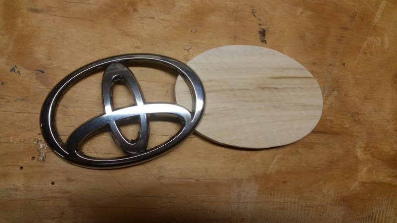

    I just got a scroll saw yesterday, wow, what a fun tool. So i am making a wood emblem. Kinda silly i know but I really want a Colorado flag emblem so i figured i would make one and see how it comes out. this is after about 15 minutes of scrolling and sanding.
