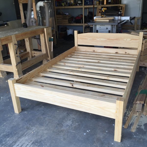

    Here's a full size using yellow pine. I used hardware that gets mortised in. The slats are 2x4's and I'd suggest using a middle support with legs for a king. I've also built beds with storage drawers and whatnot but I like the simple construction lumber. This fullsize cost about $55 in materials.

    Nice, did you M&T by hand or machine?

    Looks good and looks strong. Will last longer than my $1500 particle/veneer King Bed (made in Vietnam) that is of poor construction and thought. All the support around the 4 corners and no support in the middle.

    By hand.

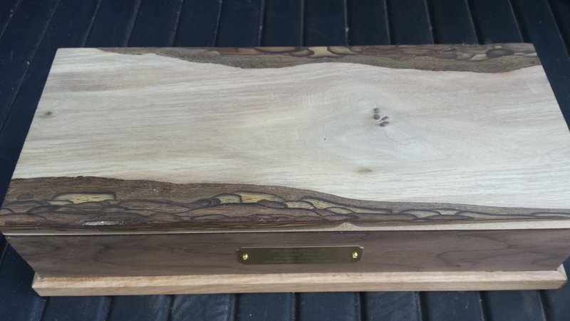

    the lid looks great! nice project!

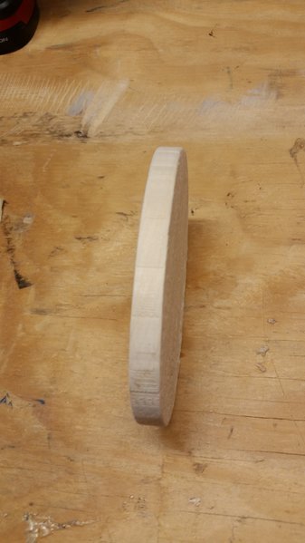

    Can someone tell me what the easiest and safest way to cut this in half down the middle would be? Hand saw I am guessing? It is the same size as a 2nd gen tacoma emblem. Thanks!

    i'd probably clamp it into my front vice and use the rip side of my japanese ryoba handsaw to rip it w/ a thin kerf...

    Glue it to a larger piece then use a bandsaw to cut each piece off.

    :sawzall:
    Might be able to do it on a table saw, thin kerf blade and a zero clearance insert.

    Tablesaw

    Double sided tape to a larger piece and use a resaw blade and fence on a bandsaw.
