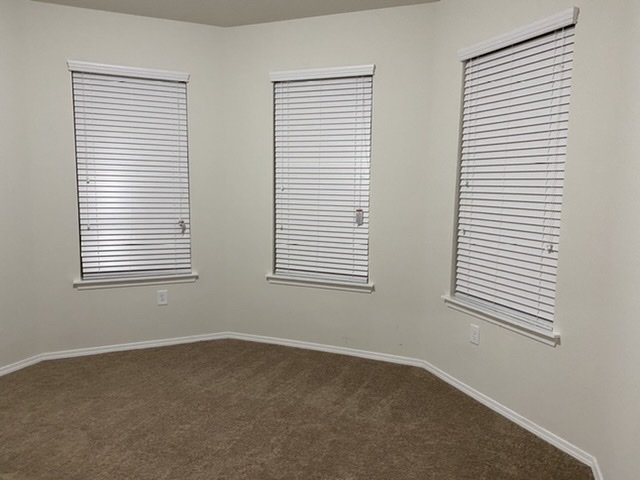

    Picture of room attached.

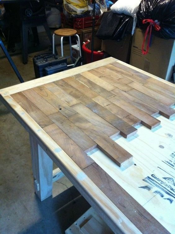

    I mean how deep do you want the table top? I’m assuming something like 24-30”?
    Other then big box store sheet goods or cabinet tops, you have a couple options.
    Edge laminated top;
    Or glued down to a top made from sheet goods;

    See above.
    If you don’t want to go sheet goods or cabinet top route, the laminated options above are what most of us would do.
    With out a planer it will take some elbow grease/time with a sander, if you want the top relatively flat.
    Once you have a method or type of top you want, we can help walk you through a more specific way to achieve your end goal.

    Gotcha! Alright. Yeah, I know I’m taking on something without the best tools for the job. My fiancées dad likely has most of what I’d need though. He’s a contractor.
    I’m not opposed to the sheet goods method, but how hard would it be do shape it to that bay window wall?

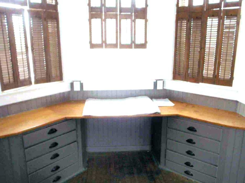

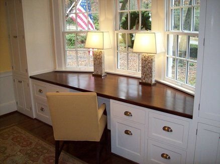

    As far as I can tell from your pic, it would be pretty basic. Cut your width after you have whatever method you wanted to use to create the basic top. Figure out your angle, the FIL could easily help with all of this and you would learn a lot more with him helping then just reading what we type. Anyways, once you know the angles, cut and butt them all together. There are several approaches to that. Glueing, using another piece of wood or brace and screwing from the bottom, biscuits, dowels, or pocket holes.
    Assuming you want the pic on top vs the bottom pic.
    5EF6E0F2-CEC8-4E3B-9BF0-0D2A7AA23308.jpg D295C6F5-0862-4DDE-9D13-3053566669B6.jpg

    Yes, aiming for something closer to the top, but without the drawer setup. The total length of said desk will be almost 13 feet. The left window side will be mine, right side will be hers, and the middle is where the possible drawers will go. As far as mounting it to the wall though, the only sturdy way I can think of is to have 2x4s coming off the wall diagonally and towards the front of the desk top.

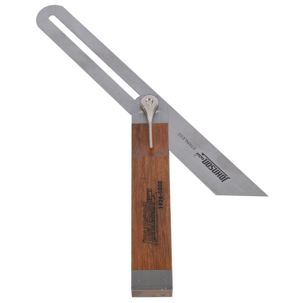

    Damn, I must be old school. I usually grab a T-bevel.
