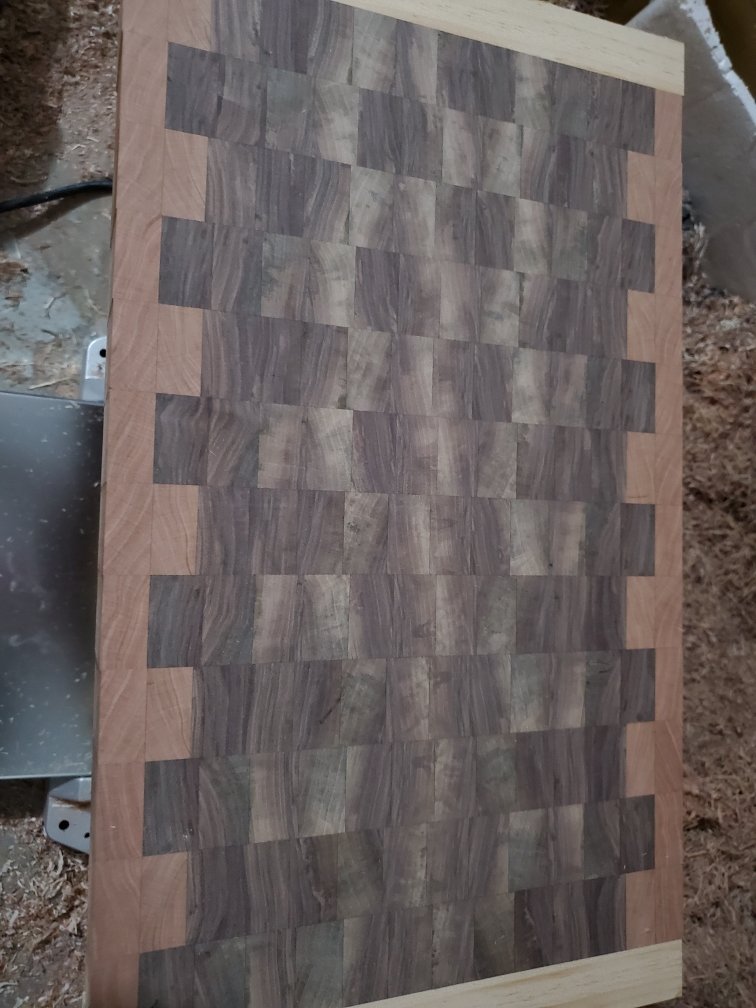

    Lol it's a dewalt 734.... I dont run the helix blades, BUT if I "end up needing new ones", I'd still probably go back with straight blades.

    If you can, add a 45° chamfer on the trailing edge. It'll help fight prevent tearout.

    That's what the pine pieces are glued to the ends for. Poor sacrificial bastards...

    I have ZERO issues with them so far. Rarely any snipe, tear out, or ridges, or any other imperfections. I honestly wasn't expecting the kind of results I've always gotten out of it.

    Can't upload the video.... but it worked and everything is ok! :thumbsup: I never doubted it!!!!! :anonymous:

    Looks amazing!

    Thanks! I did do it a bunch of very very shallow passes to minimize risk as much as possible.

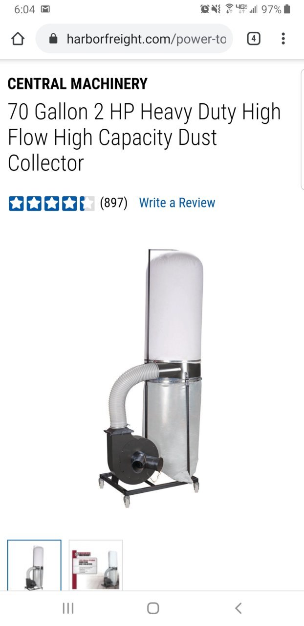

    I have a harbor freight collector on mine. It's very similar to this one.

    Old school ftw.

    I need something like this. Thanks!
    Same, suuuuper tired of sweeping the driveway.

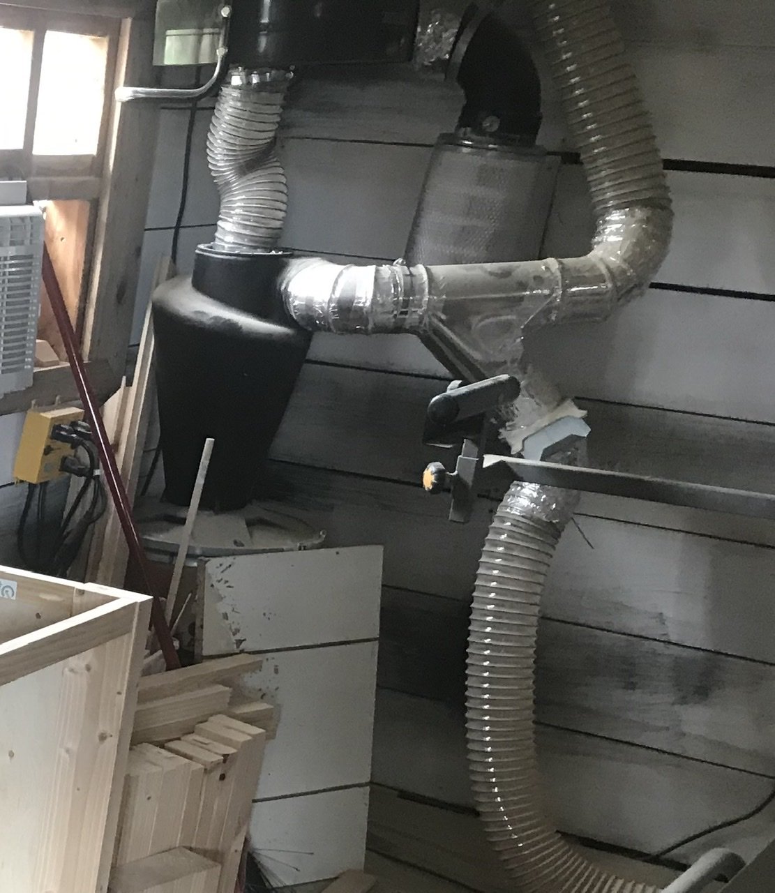

    1hp Harbor Freight with a super dust deputy. Also has the iVac power strip so it comes on and goes off with each machine.
    Very different air flow with a shop vac vs dust collection. Shop vac is high power, dust collectors are high volume.
