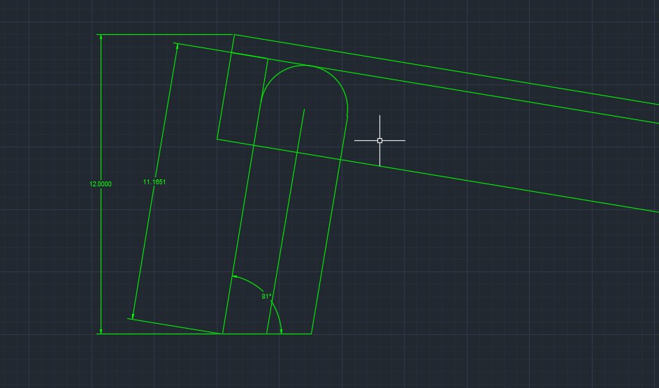

    Cut the angle @ 80° (or 10°) and cut the OAL of the leg to 11 5/32-ish and you will get the 12 height requirement as long as you use 3/4 ply as the top. I typically use 2x4's for the sides and legs.

    Is that AutoCad?

    Yessir

    Nice! Good way to do it!
    I typically model my future projects in Revit when I have downtime at work.
