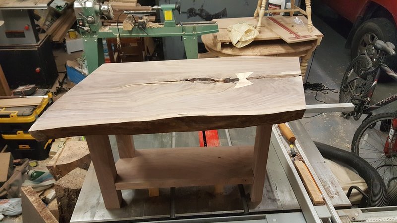

    Following the crack would put it offset in the front to back alignment , I would just make the end offset the same or at least similar

    Either way you are still letting your creative juices flow. :thumbsup: I just noticed the logs on the left. :spy:You also own a lathe, so that got me wondering if you might have more tools than most of us. Just thought you might have cut the top yourself then ran it through a planer.

    I might be a tool hoarder. The piece was flattened by a no. 7 bailey hand plane that I picked up at an estate sale. I've dated it back to around 1907. $20 well spent. I like a mixture of hand and power tools.

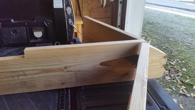

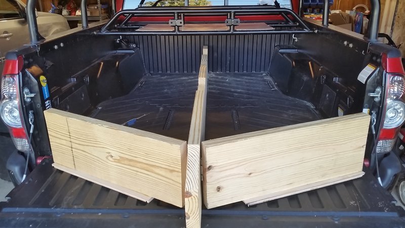

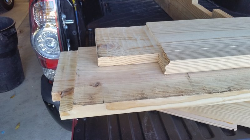

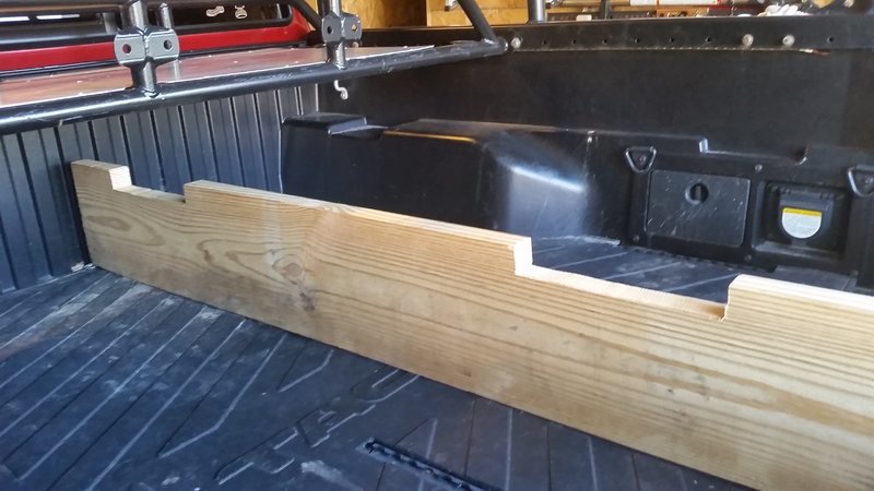

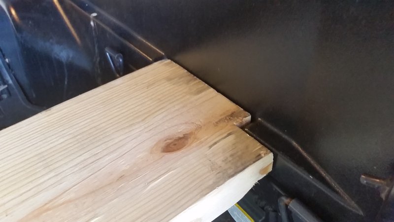

    A picture dump for my plywood rack for the shortbed.
    First the middle support with the back wings.
    Shows the cutouts for the support pieces. This lines up with the notches in the bedsides.

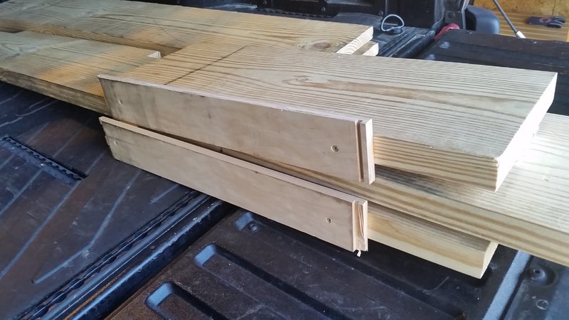

    Wings are held on by hinges.

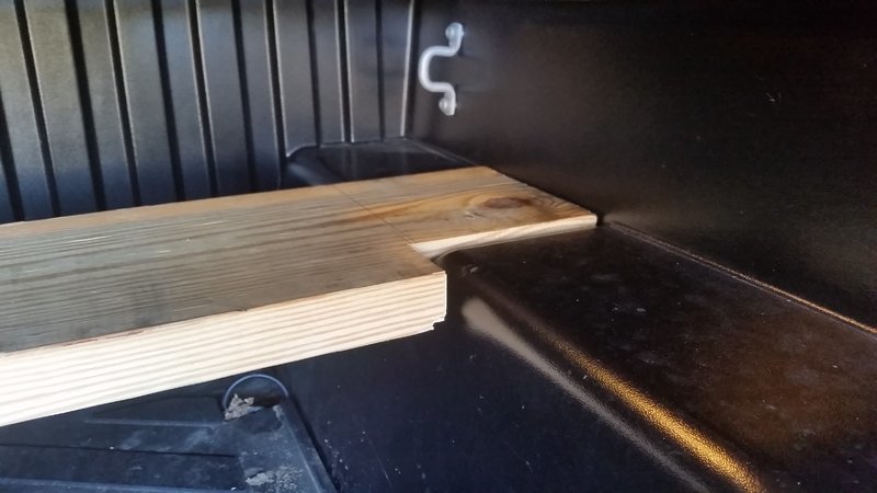

    This shows the material removed so they fit flush in the bedside notches.

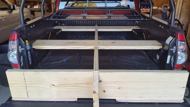

    All together
    The wings needed a shim due to the fact the tailgate sits lower than the bed floor. This might be due to the bedmat.

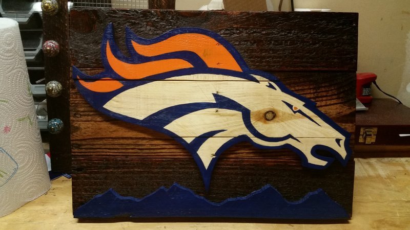

    Stuff
    Latest work out the door.
