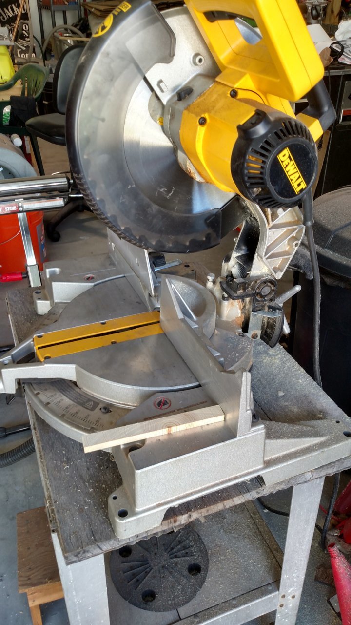

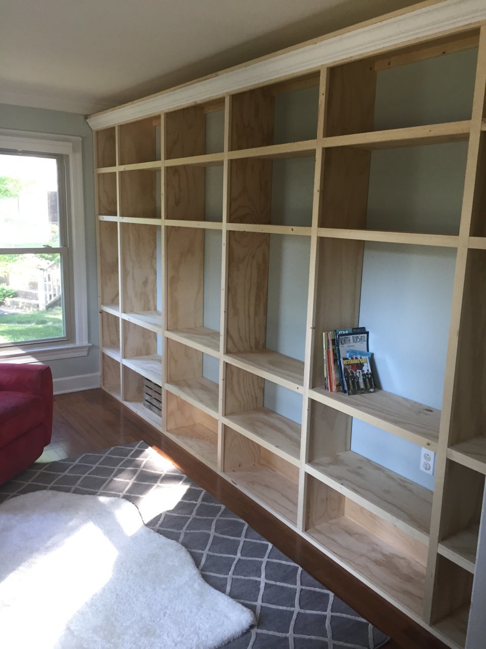

    Its a damn nice shelving unit though.

    nice! I dont think we have that many books...

    Make a 90° cut in a board, flip the right side of the cut piece front to back (edge that was at the fence now faces you) and mate the cut. Make adjustments in the miter until they pair perfectly, which may not line up with an indent. Then adjust your gauge to read 0/90.
    You should not have much deflection on a chopper on a thin board. But then again these aren't ever really precision tools with the exception of the Kapex.

    Very nice... only joking about the lack of books currently on it. Probably like us with several boxes of books with nowhere to put them.

    I have a miter saw that I know is just off.... 1 and a half degrees to the right is square. Not a huge deal to me lol.

    My wife has plenty of trinkets to fill the spaces, I’m pretty sure

    Loosen the fence, tighten it back down, then reset to 90°

    What model is it?

    We have containers full of books. Just waiting for these shelves to get painted.

    https://www.ereplacementparts.com/r...re_Up_and_Align_a_DeWalt_DW708_Miter_Saw.html

    Cool, didn't know you could reset the indents on that one.

    So... Funny story... I did all of that before I made the first post about this.. and even explained that I did in fact do all those things.
    Anyways.. thanks for all the advice .. hopefully it'll help someone else.
