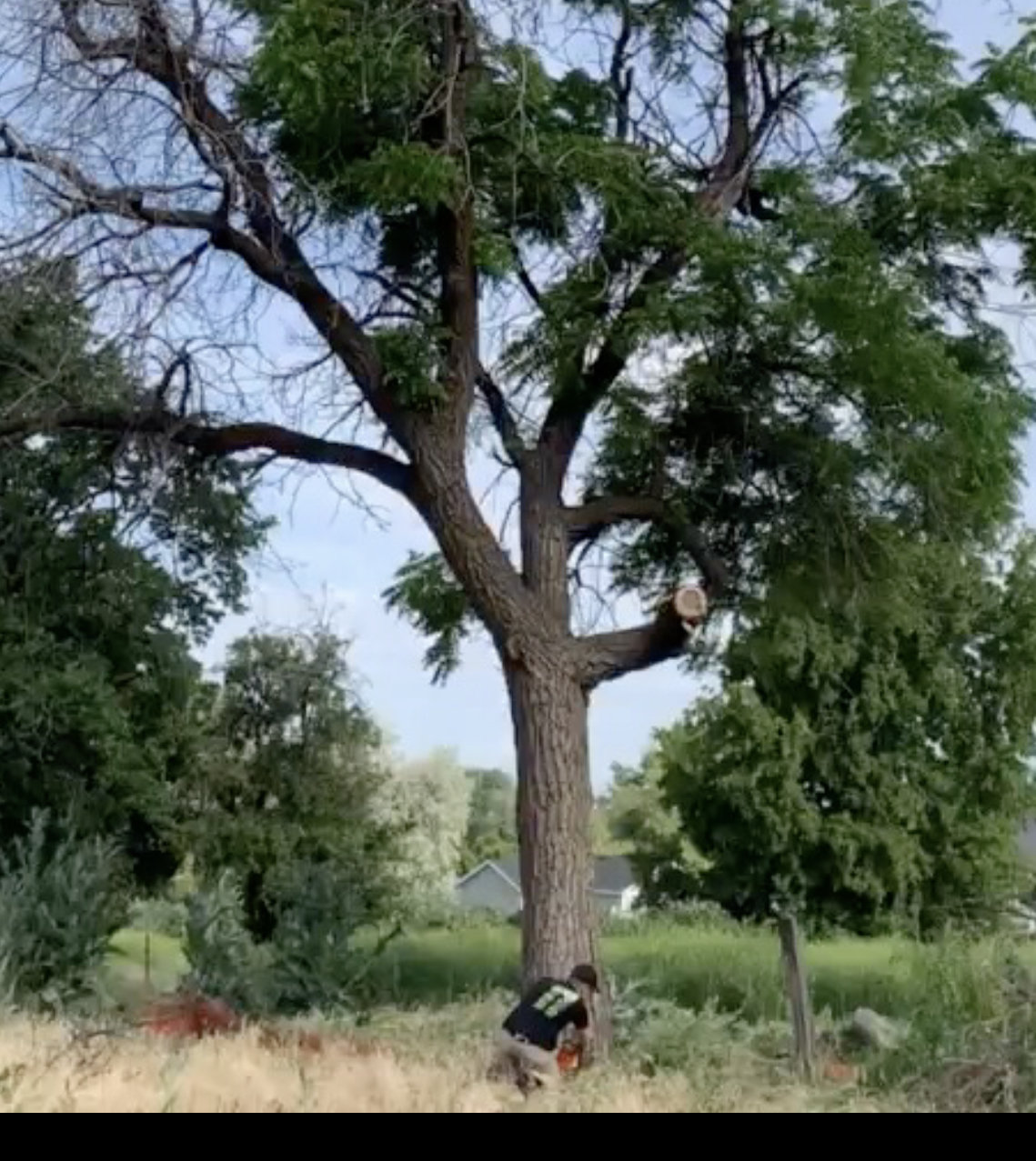

    Cut down a big walnut tree yesterday. Any of you guys have experience / would recommend trying a chainsaw mill, or should I find a local sawmill and haul it out to them?

    Gun stocks and pistol grips? Jk my dad had one just rough cut at a local mill and I'm actually using a few boards to case out the transition between the existing room and the add on for the laundry room we are doing... Its hard from what I hear...

    Id take it to a mill.

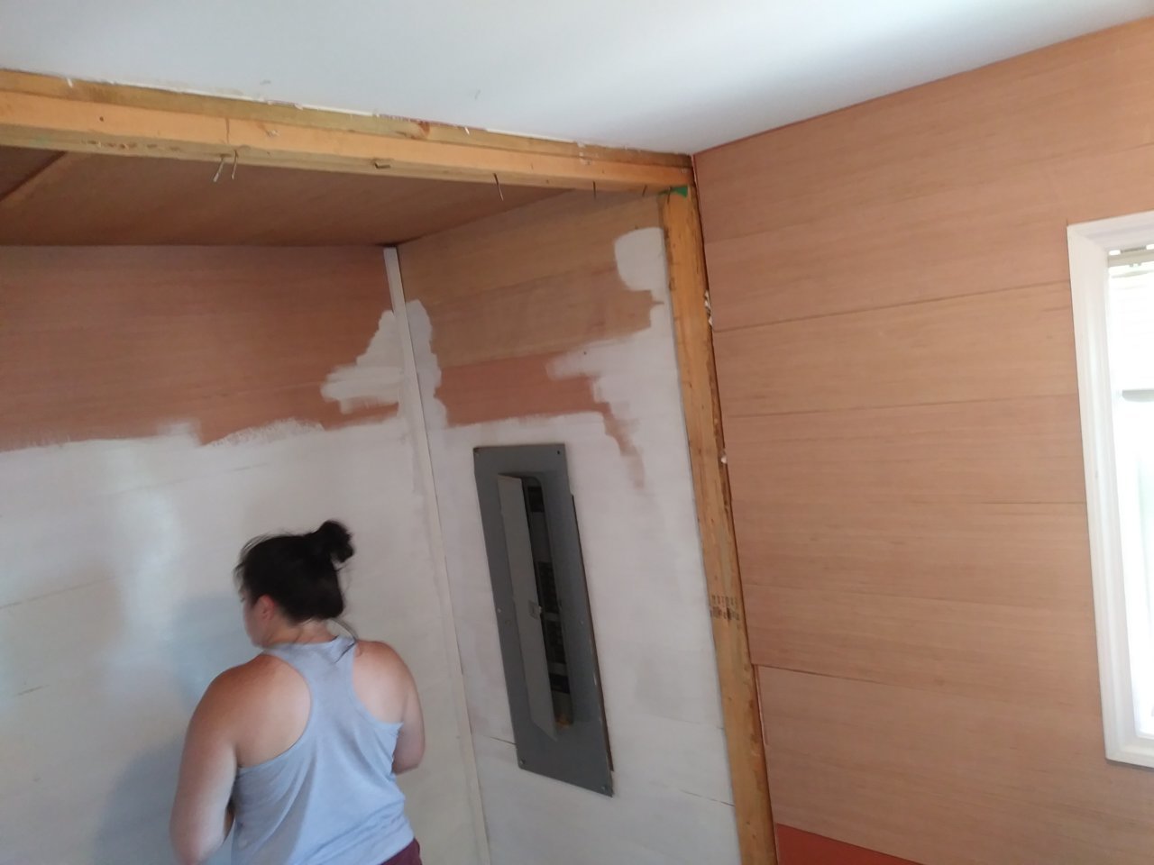

    Making some progress

    Most mills won't touch a single log that came off someone's property. I'd look for someone with a portable mill first.

    don’t forget to paint the ends to avoid checking!

    reason being there are typically nails or other metal that are in the tree. When the mill hits them, it's typically fairly costly because of the damage they do to the blades of the mill

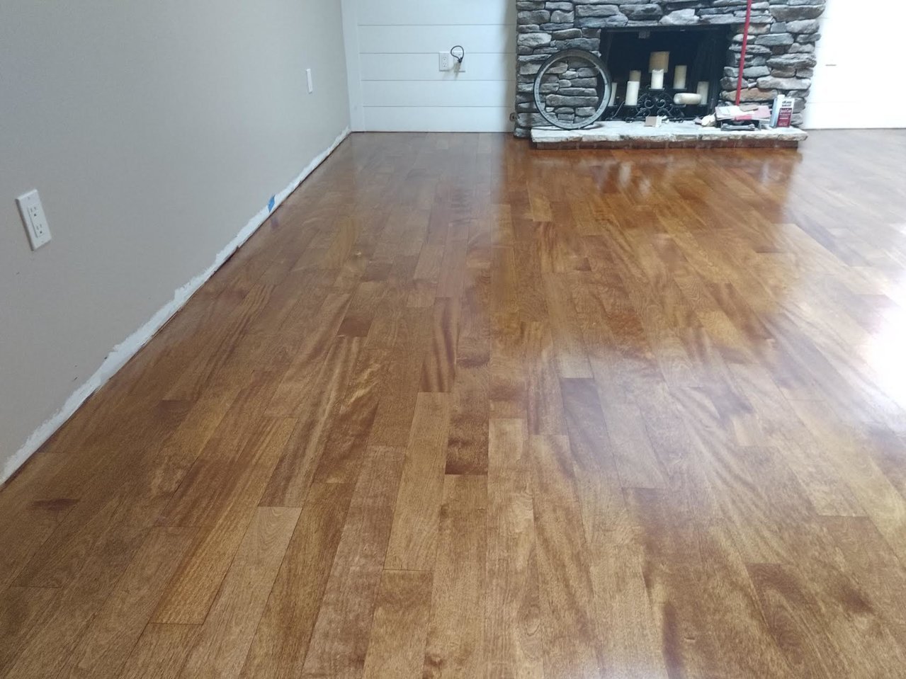

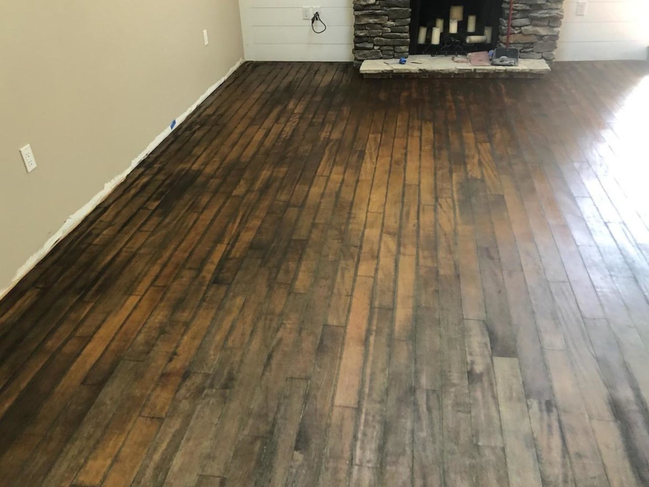

    Before and after pics of a floor that sanded and stained last week.
    BTW, the first pic isn't 20 years of wear, it's actually the result of someone that claimed that they knew how to sand and stain floors.

    Looks like cherry nice

    They were just giving you the antique look. :)

    Funny thing is that's what I've been saying.. The grain looks exactly like American cherry, but it's actually very yellow like pine.
    I know it's not maple, and I don't think it's ash or alder..

    The older pine is harder

    Wow, total night and day difference. I thought the first pic was actually water damaged.

    I meant to say "I know it's not maple". It's definitely not pine either (or heart pine).
    I've been sanding floors for 30 and haven't seen this. I'm going to ask my buddy that's a vendor..

    Needless to say, the clients were happy :)

    It looks a lot like Alder to my semi-uneducated eye. :laughing:

    Thanks to all for the advice a couple days ago. I found a guy with a portable mill who came and sliced it up for me.
    Now to dry it then figure out what to do with all this walnut ...
