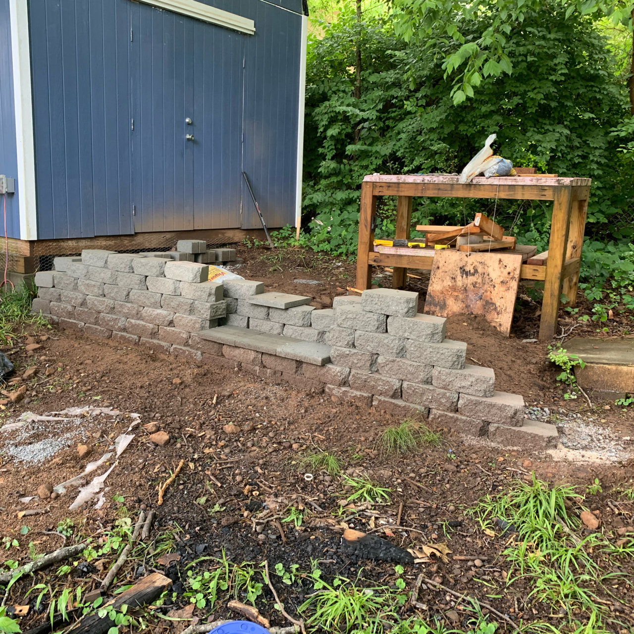

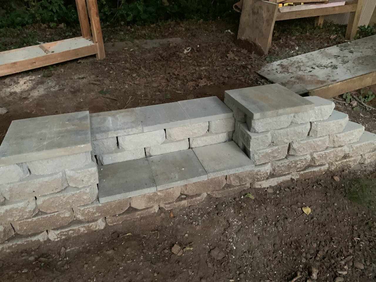

    Finally went back and revisited the steps. Happy now. Need to wrap the wall around to the right side, and I'll be ready for a dirt delivery.
    Oh yeah, and wrapping the wall around means I'll have to destroy the ramp to the old shop.

    Perfect! Good work. Looks great, looks functional. That should serve you well.

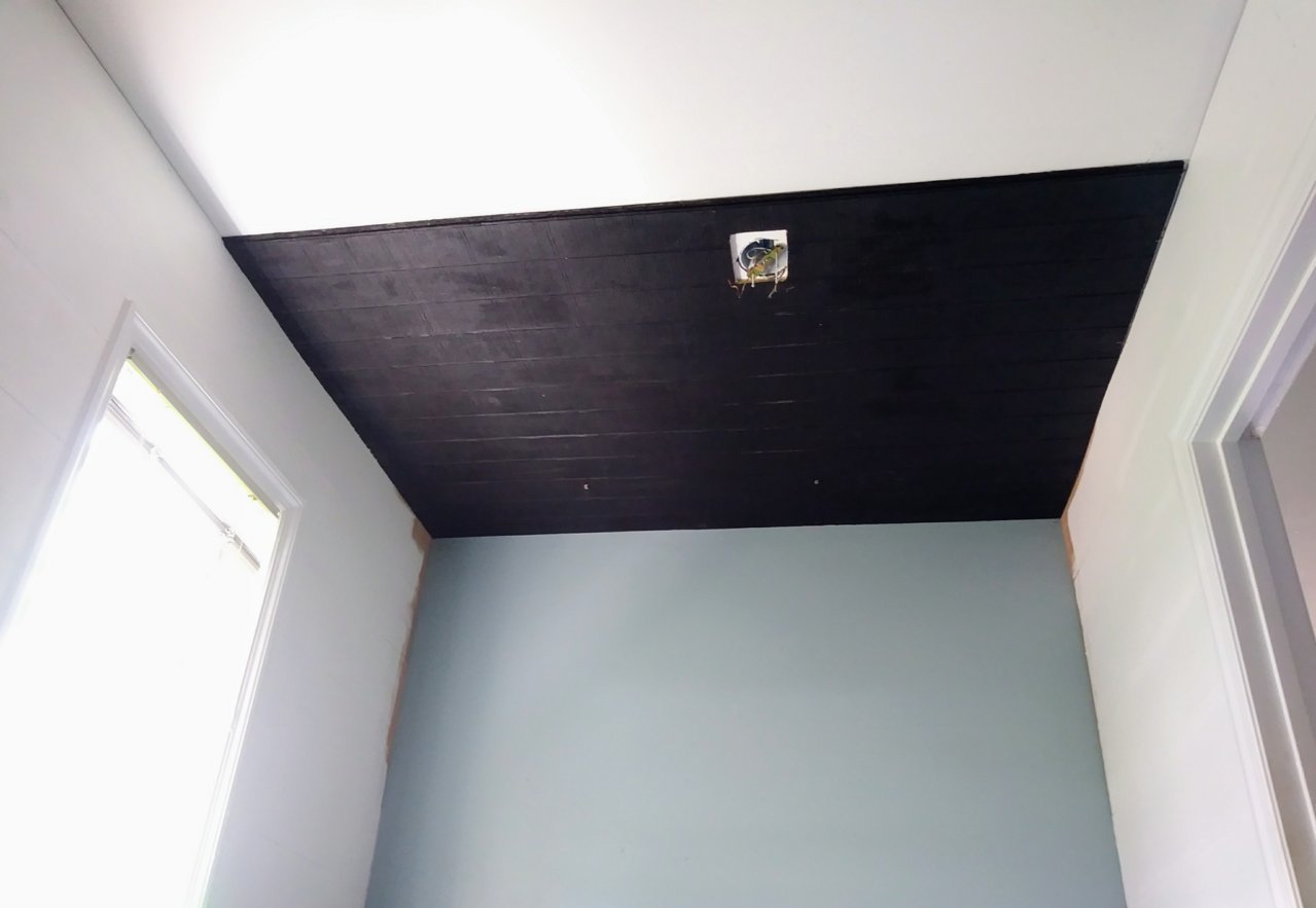

    20200606_135609~2.jpg Ceilings are going up... Yeah thats really really black. Found some wider bead board than what we had seen at the Lowe's closest to us. Also air compressor motors get hot and feel terrible on bare calf muscles

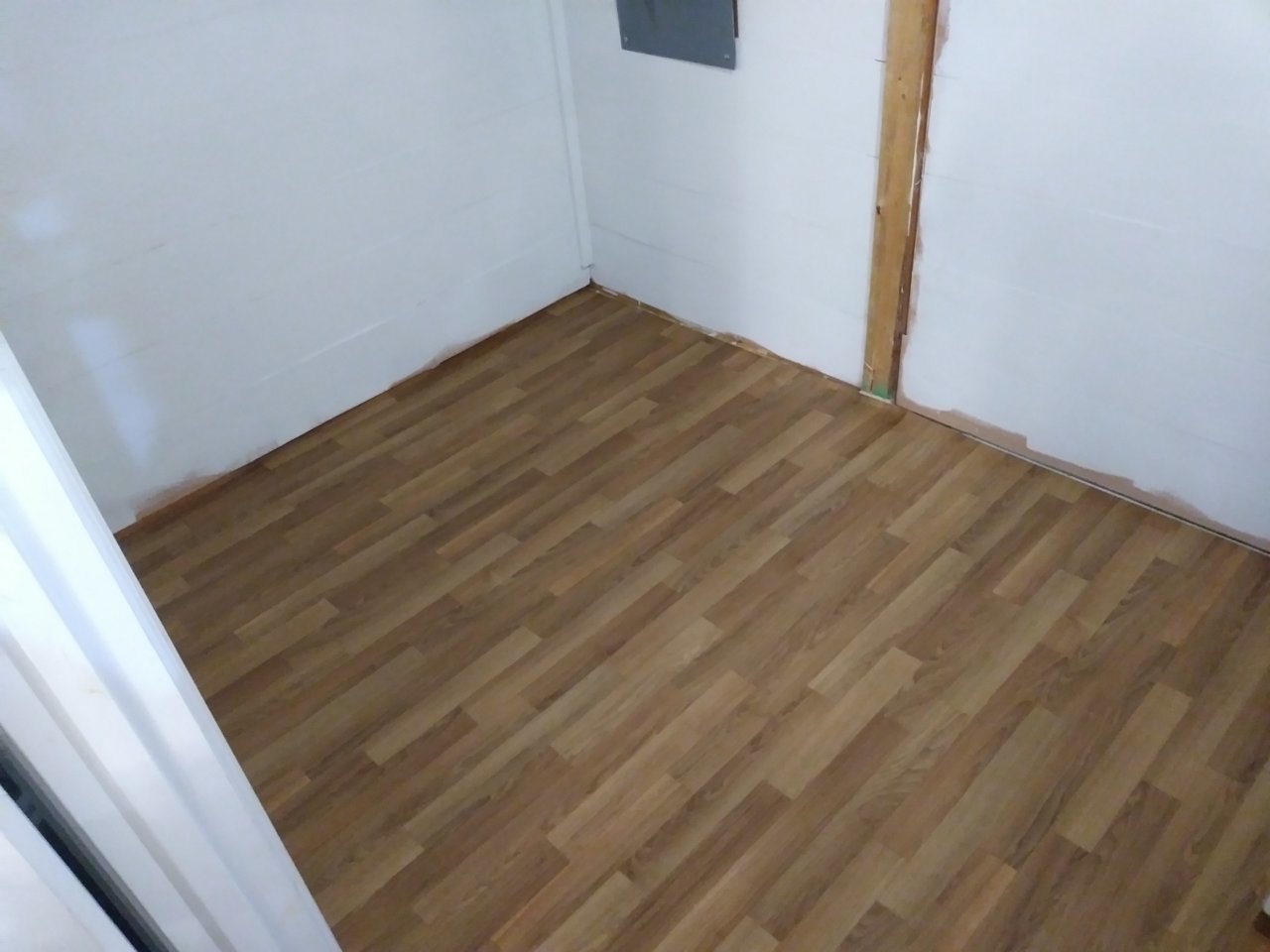

    Closer (that is vinyl flooring but it is almost an exact match to the solid hardwoods we have every where else in the house that doesn't have plumbing... It isnt all attached yet) and we have the base board and I still have to make that walnut exposed casing... We have another wall cabinet to hang above the dryer and then on the addition part we have a floor to ceiling cab for one corner and in gonna make a clothes folding bar/table/countertop/shelf from the tall cab to the wall... Well maybe I'm not as close as I thought haha

    Looking good

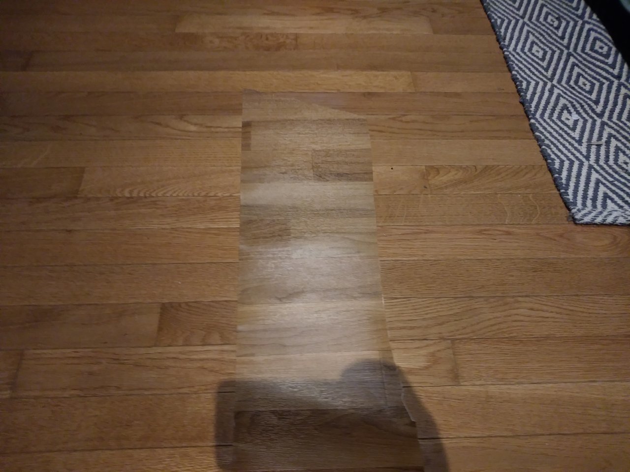

    2 competing stores, 2 different brands, 2 different styles, ~10 years apart... Id say that's as close as you can get to a match

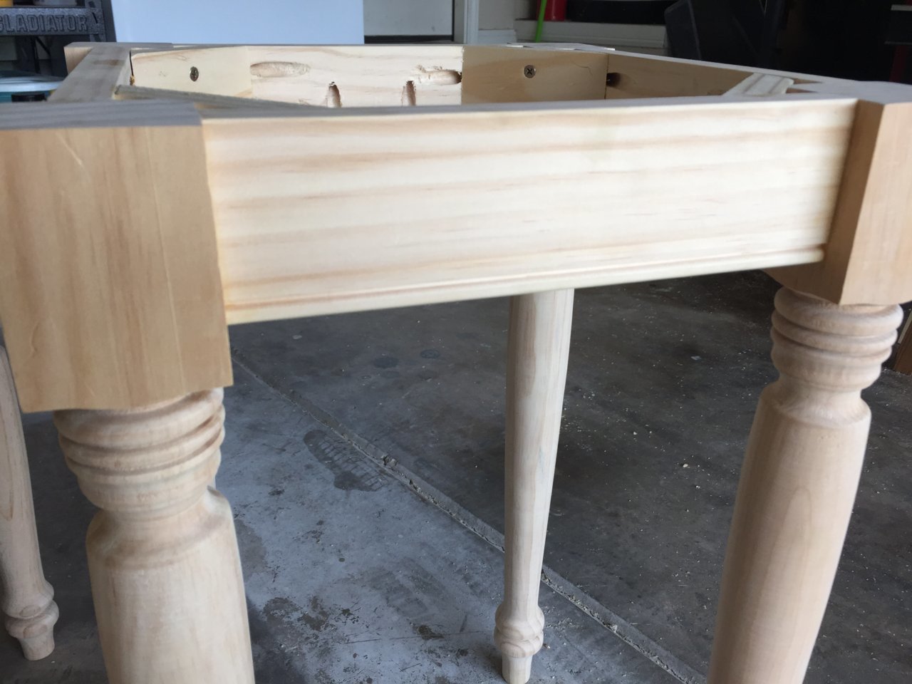

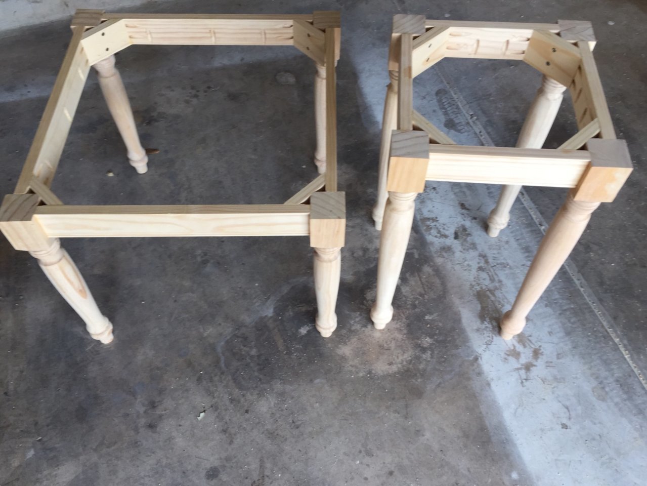

    Working on matching coffee and end table for the living room. Tops are round tops found at Lowe’s. I really wanted to make the tops myself but couldn’t justify wasting $300 in material if they didn’t turn out as planned. Sometimes you have to put pride aside continue on

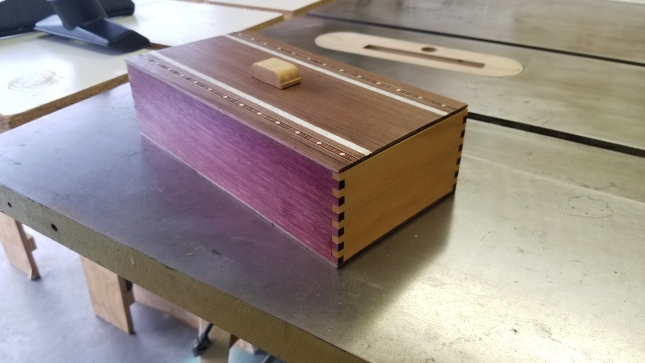

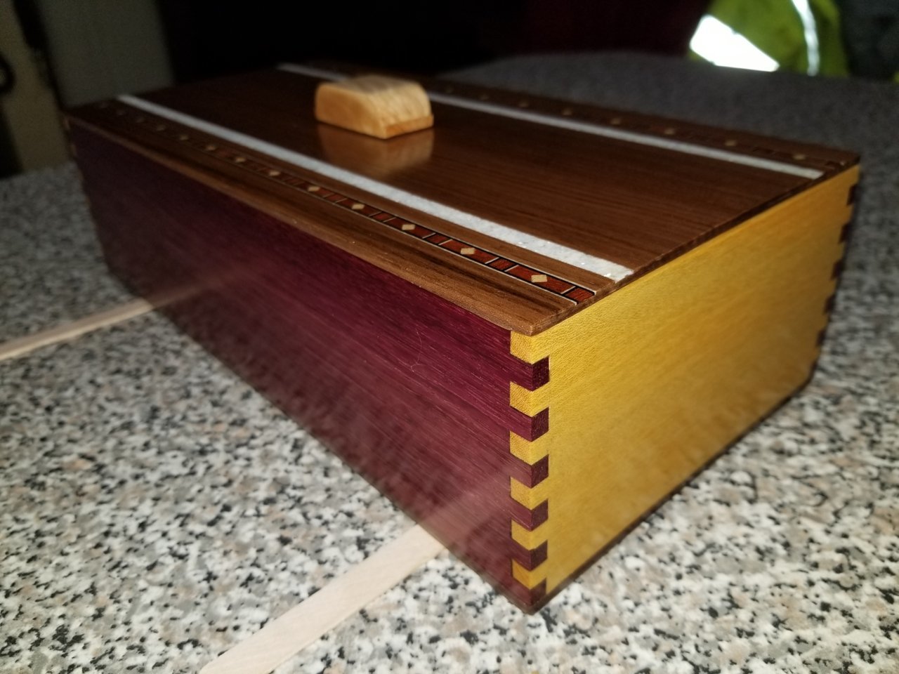

    This is a purple heart, yellow heart, and walnut box, with inlays. My wife picked the colors.

    Haha thanks! Got them from Lowe’s too :anonymous:

    Careful how you attach the tops or they will crack. You want to allow the top to expand and contract across the width with the humidity. One screw in the middle of the top or glue a block of wood to the aprons with a elongated hole in it.

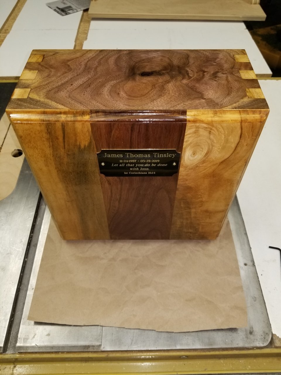

    Here is a urn for a man that got hit and killed trying to help someone on the road. He was a good fella.
