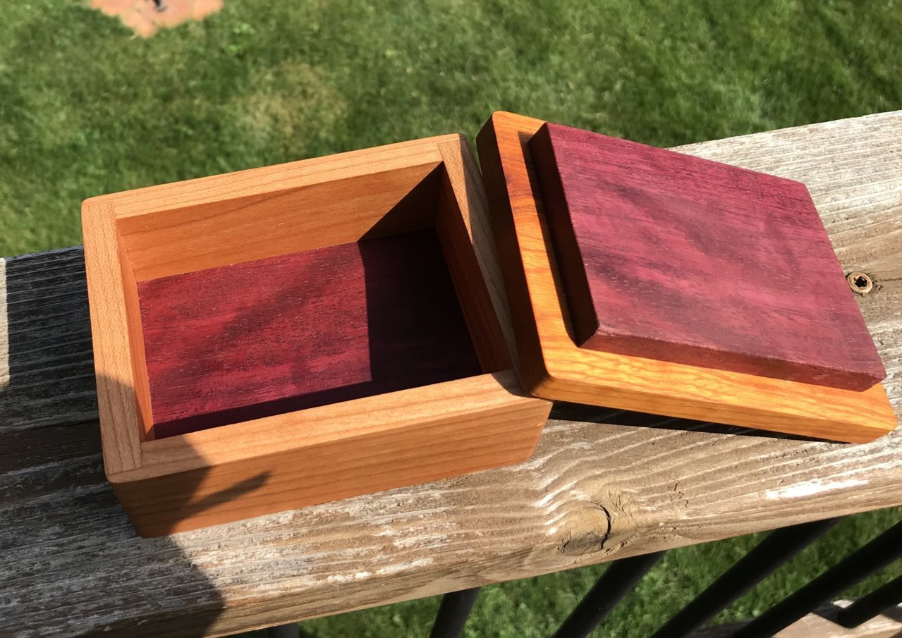

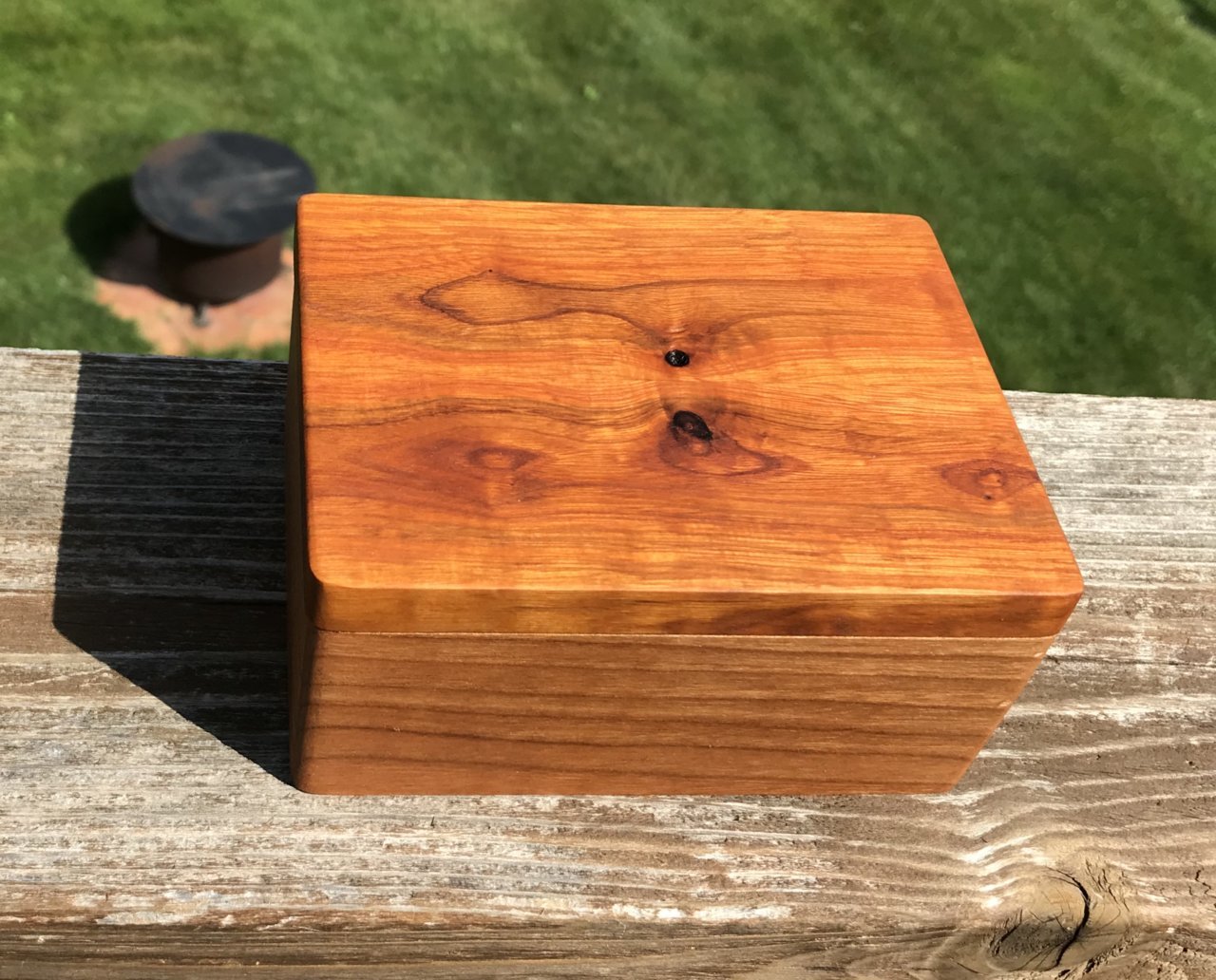

    Clearing some buckthorn and cut a large piece Into boards. Book matched some. Only thing I could think of to make was a box.
    Cherry sides. Purple Heart bottom. Butcher block oil finish38CB6367-E567-4947-AF46-A45B46F6E058.jpg613291E2-BFEA-4B04-A287-16B32685B6FB.jpg

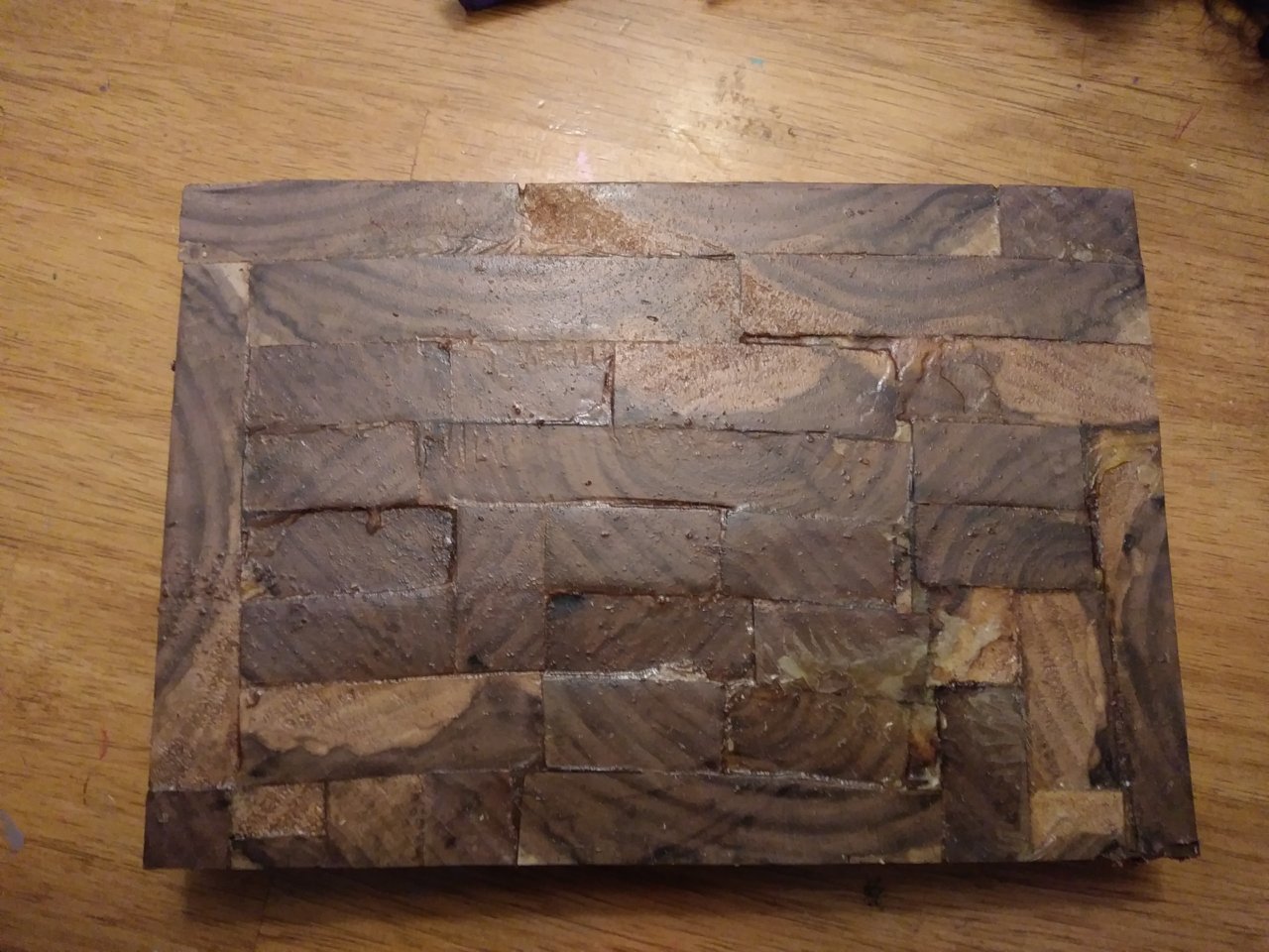

    So I built a jig for 2 sides on my cutting board and was gonna screw the other two sides in tight when I got all the pieces glued and down but it was like 90° outside and that must be the optimal temp for wood glue to dry because it was starting to set up before o got half the pieces down. So I put a think coat of glue on the back side and then when that was dry I sanded down the front side with 220 and filled in a few gaps with walnut saw dust and put a thick coat of wood glue over all of that. I'm gonna sand all that down as smooth and flush as possible and seal it up
    And yeah it probably isnt quit square. I pushed the squarest edge against the fence and ran my miter on the side and then used the cut side as my reference for the rest of the cuts...

    The grain is running in a lot of different directions. It may end up coming apart.

    Oh ill be a little disappointed if it doesn't haha all of it already had a good bow to it and there isn't enough glue in the county to keep it together... But maybe it will look good for a pic or two

    What type of wood glue did you use?

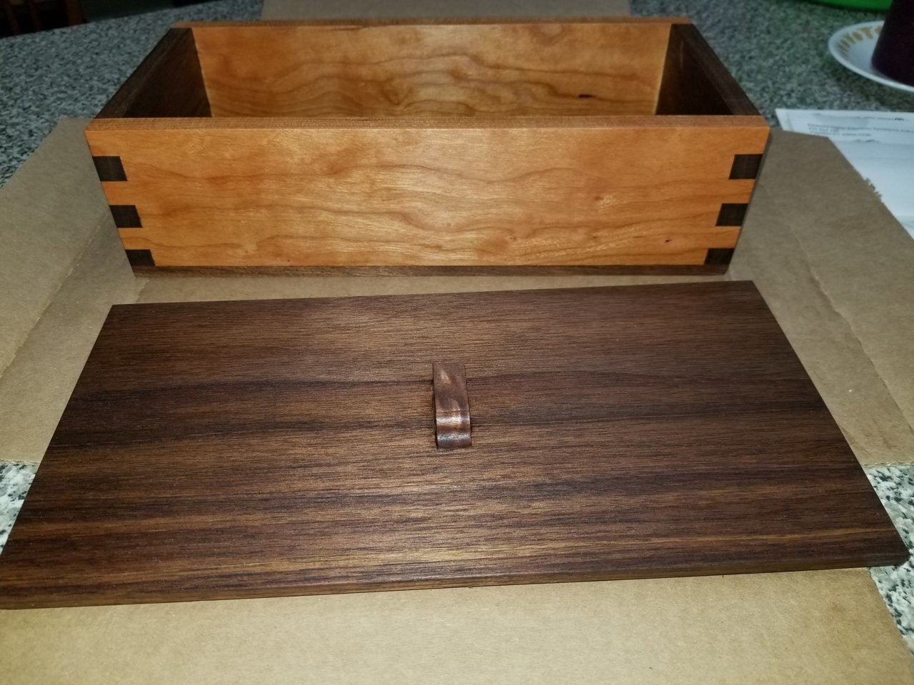

    Also first box I ever made.

    have you ever used the baking soda aging on cherry? That is the pic above.

    Tite bond??? Something like that just trying to see what happens when you do everything wrong at the same time haha

    Titebond III is recomended for indirect food contact such as cutting boards...
