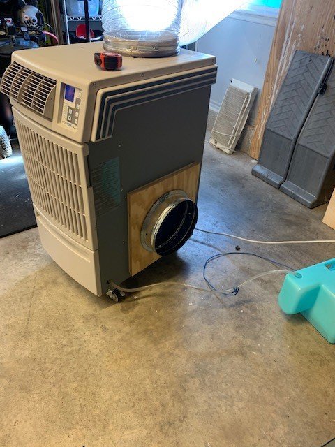

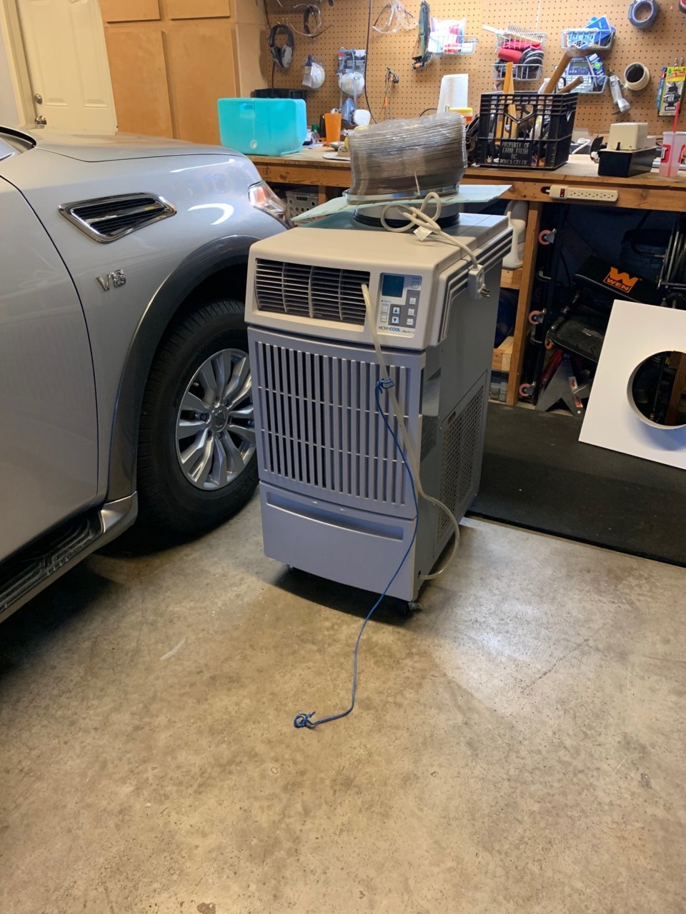

    Round 2 of the great workshop AC experiment. Got a hold of a 12000BTU industrial unit, Movincool officepro 12. I'm planning on testing tonight and running it all day Friday. I hope it works. It's hot in there!AC.jpg

  8. Jul 23, 2020 at 6:59 AM
    #5748
    Championsumo
    Championsumo Well-Known Member
    Jun 16, 2015
    #157532
    708
    Tulsa, OK
    2015 DCSB 4X4 TRD Sport
    Well Sadly it did the exact same thing as the residential portable unit I tried. Although this one cycles a lot more air. Both units create negative pressure which draws air in from the cracks in the garage door and what not, and only pull the garage down by 2 degrees or so then stop cooling. So I am on to round 3, covert this SOB to a dual hose and see if I can solve that issue. I fabbed up an intake port last night so I could draw air across the condenser coil from outside, hopefully doing away with the negative pressure.

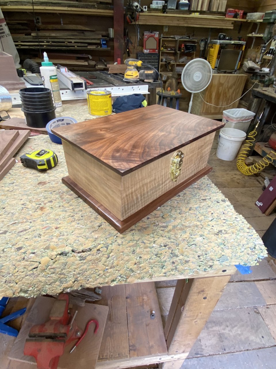

    Finally started building boxes again.
