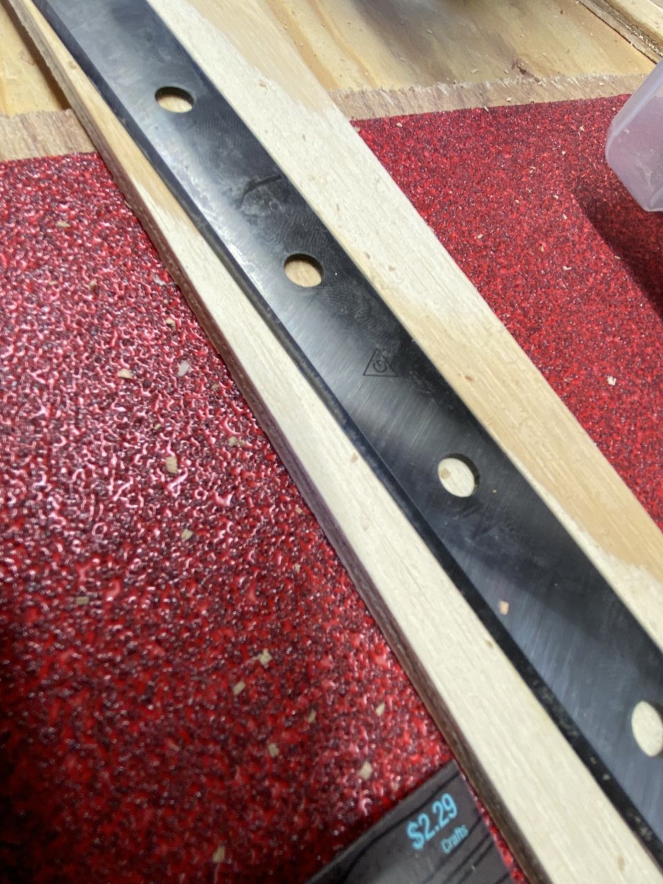

    Mystery solved!! I recently got into mixing two part epoxy to fill voids and cracks in wood. Just an accent thing. Note to self: Don’t run epoxy thru your planer! I put the new blades in on the 18th, they are shot. I had not thought about the damage epoxy could do, guess I’m sanding it down flush from now on. I surely appreciate all you guys trying to help me out, I fell like an idiot! Here is a picture of one of the blades, I-phone picture but you can still see the damage. It’s right in front of the “G” triangle.

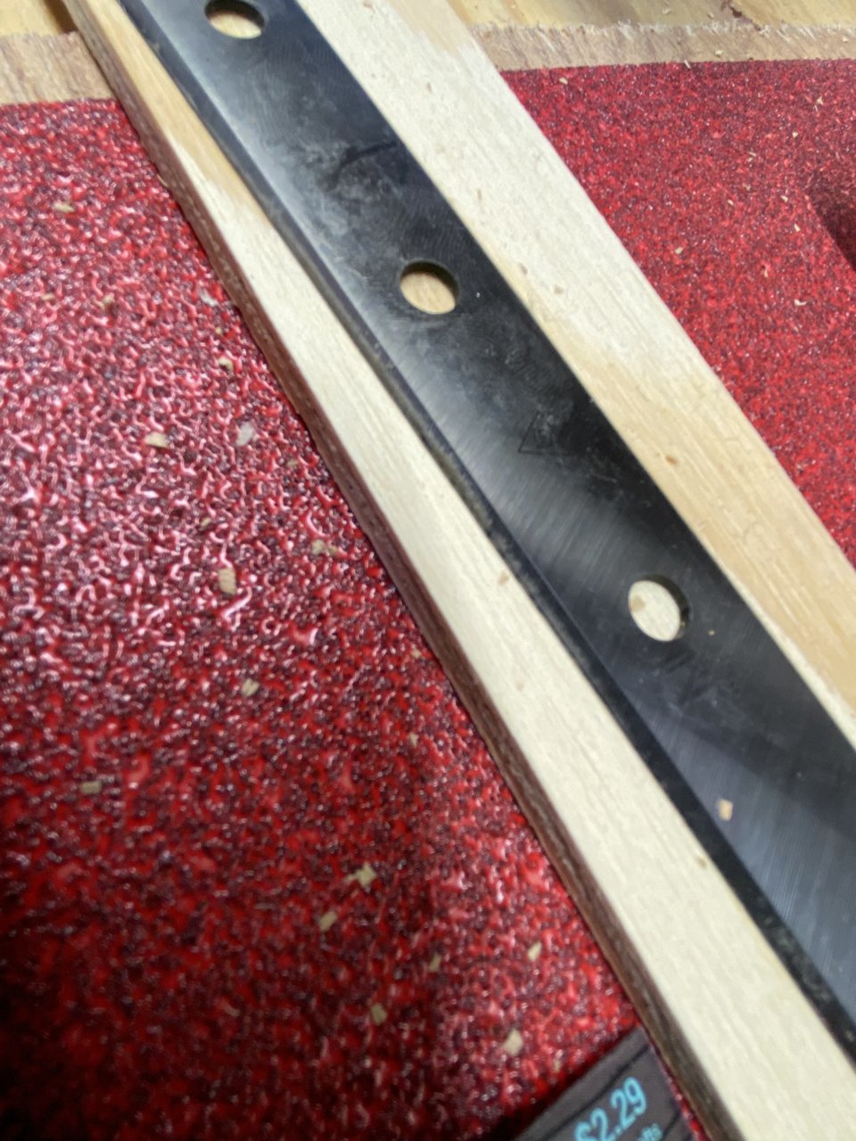

    Here is another.

    Brushes look like they got long life yet. If they were smaller/flatter id say there was an issue

    Dewalt 734 planer knives are reversible FYI

    Yeah, just flipped them.

    Are they blued now? (as in overheated)
    Agreed, they definitely have some life left.

    I just flipped them, the edge was ruined in several places.

    Are those DeWalt brand knives ?

    Yes

    interesting , they look black , all the ones I've ever got are shiny metal

    They’re silver.
