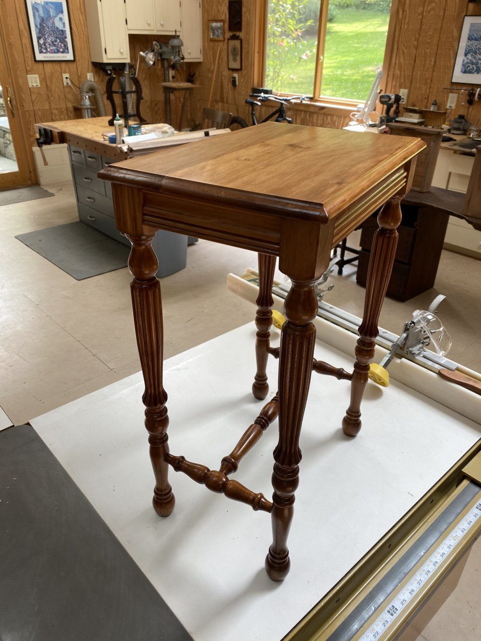

    D6B05515-9449-4811-A805-E8C154432CCD.jpg C6F5AF14-99E2-4B53-A106-C792813104F9.jpg

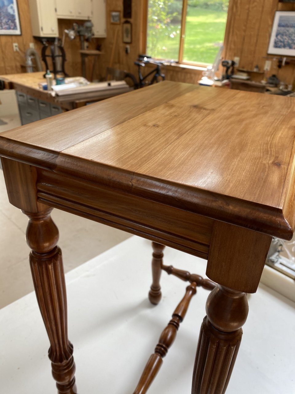

    got this night stand/end table all wrapped up and glued back up.

    Nice!

    Is that a Powermatic 66?

    Thanks, the live edge walnut desk you see in the background is next...turns out it was made by a pretty famous local woodworker about 40 years ago. I'll post some pics of it later. I already started scraping and sanding the drawers.

    Powermatic, yes. Not sure about the model, it's all my dads machinery but I know that table saw is 15-20 years old. He also has a Powermatic 15 inch(?) planer and a huge Powermatic bandsaw. The shop is basically one big powermatic ad

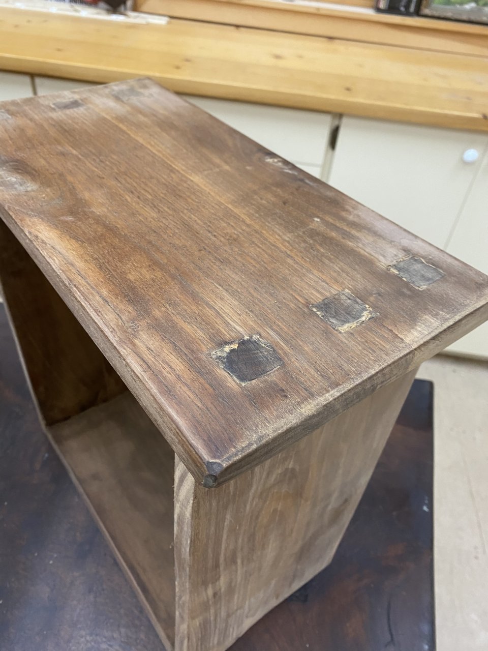

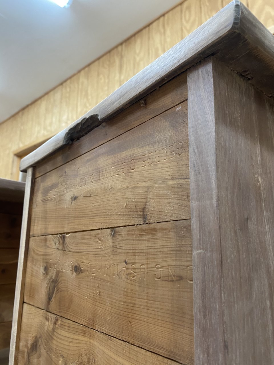

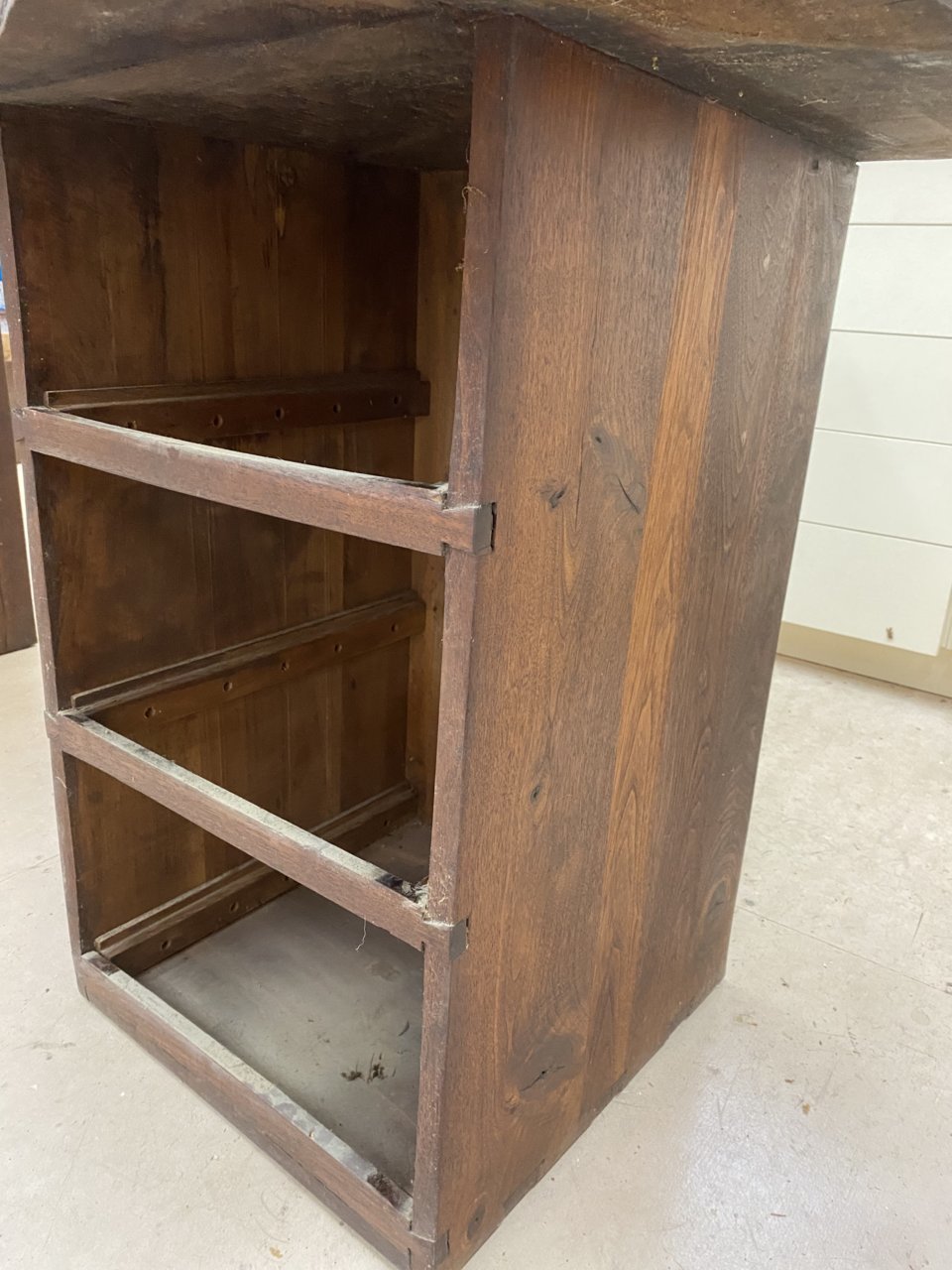

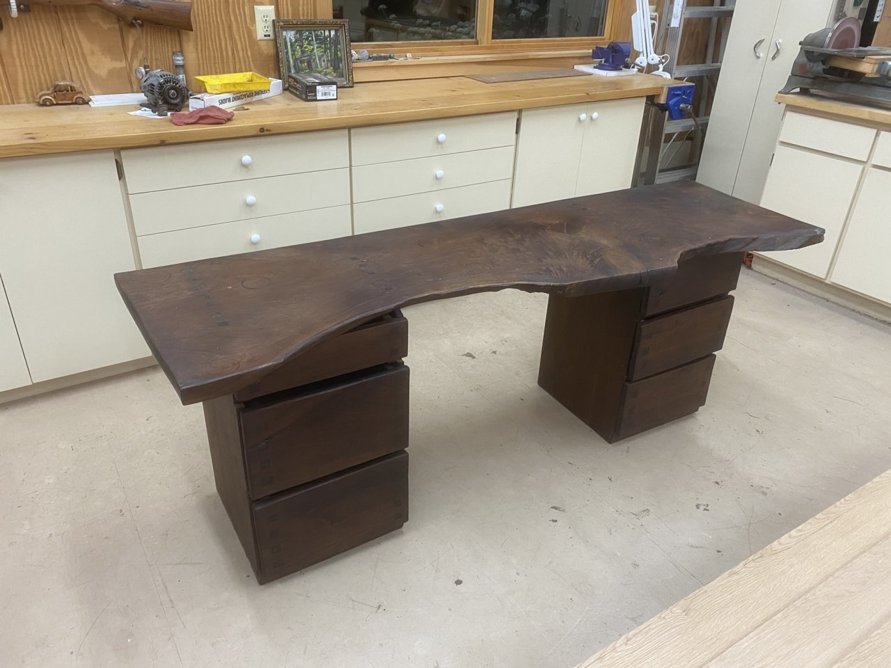

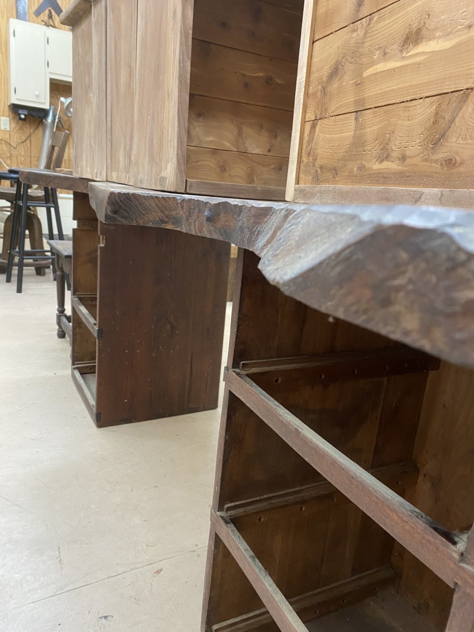

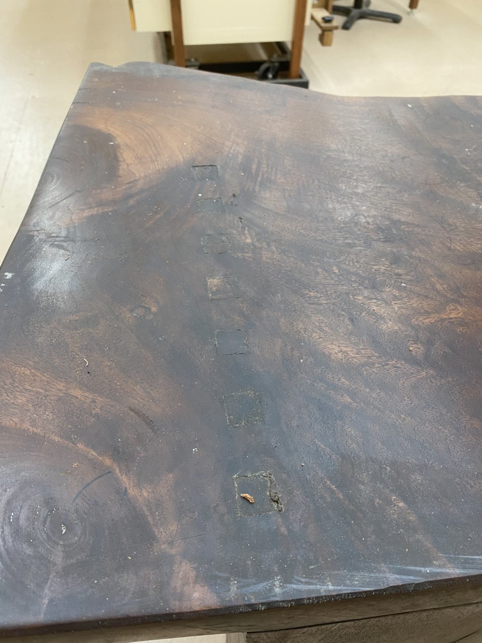

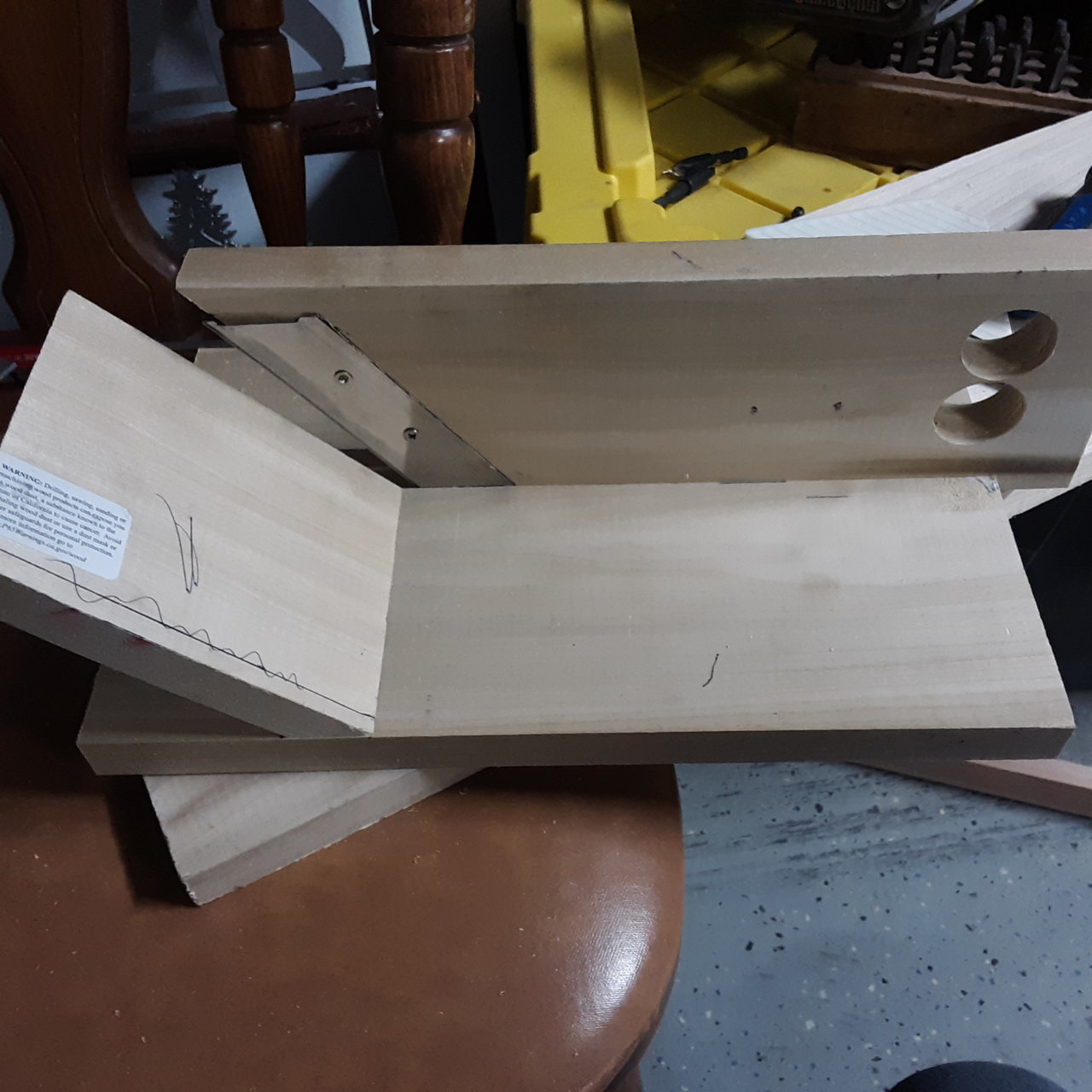

    Here’s some pics of the desk I’m working on now. Brace yourselves...
    Solid walnut drawers, drawer boxes, and top. Drawers feature hand cut dovetail and mortise and tenon construction as well as hand carved finger pull thingys underneath the drawer. The top is attached to the drawer boxes by mortise and tenon as well. From what I can tell it was made using all hand tools (and an orbital sander). The top and drawer faces are not perfectly flat and have a lot of character to them. It was made by a pretty famous local craftsman and I reached out to him and he told me it was one of his earliest pieces, made about 40 years ago when he was in his 20s. He said the replacement cost is $55k
    Its in pretty rough shape and Im slowly scraping and sanding all of it. I started the drawers already. Don’t know what I’m doing for finish/stain but I’m definitely keeping this desk.

    Holy chit, I've done a lot already!!
    That is awesome!! Can't wait for the final product.

    Holy cow! $55k...I would sell it, unless it is sentimental for you. Everything has a price.
    Kind of eager to see what it will look like when it’s finished.

    Yeah my jaw dropped when I heard that too. I got it for free right before the previous owner was gonna put it up for sale, but I promised I would restore it and use it. So I gotta keep my word. I also really like the desk and have been drawn to it since the first time I saw it about 4 months ago. It truly is quite the dilemma and I have thought about it a lot...
    plus $55k is the replacement value...i.e. if he were to have to remake it now at his current rates. There is no telling what the value is as it sits or when it’s refinished, but it certainly has some history. Might be worth getting an appraisal done afterwards.
