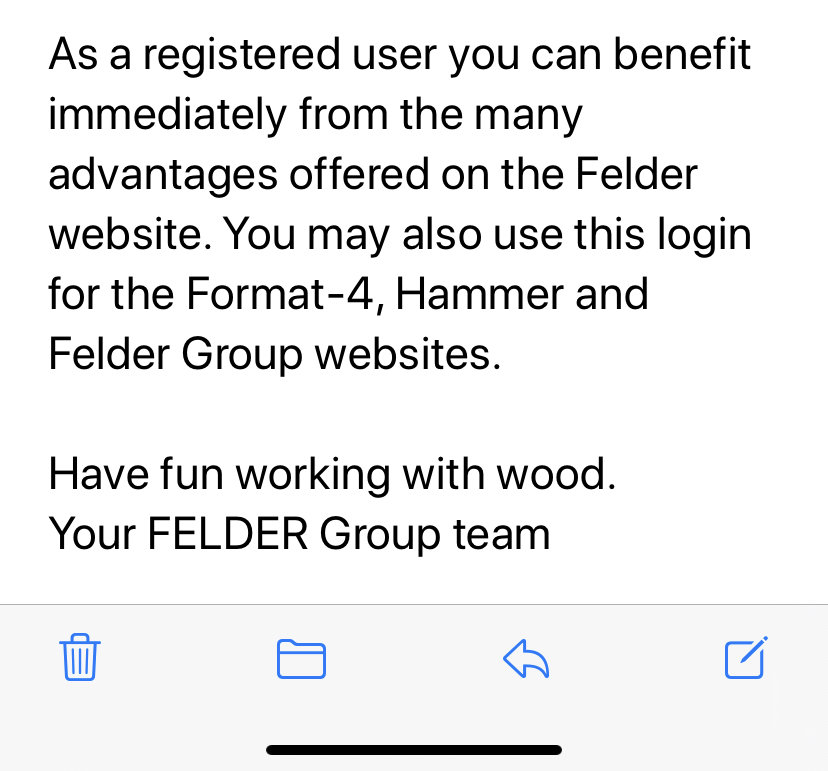

    I’m getting a quote. :anonymous:
    *edit: a quote for the A3-31
    I’m looking at the 3hp Sawstop.
