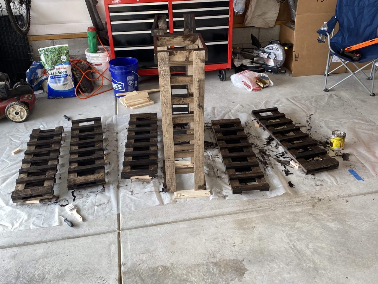

    Ya. See if I can exchange and get the warranty on replacement. Made do with the skilsaw for the last few minor touch up cuts. Need to flip and stain other side and will prob do another coat. Progress pic:

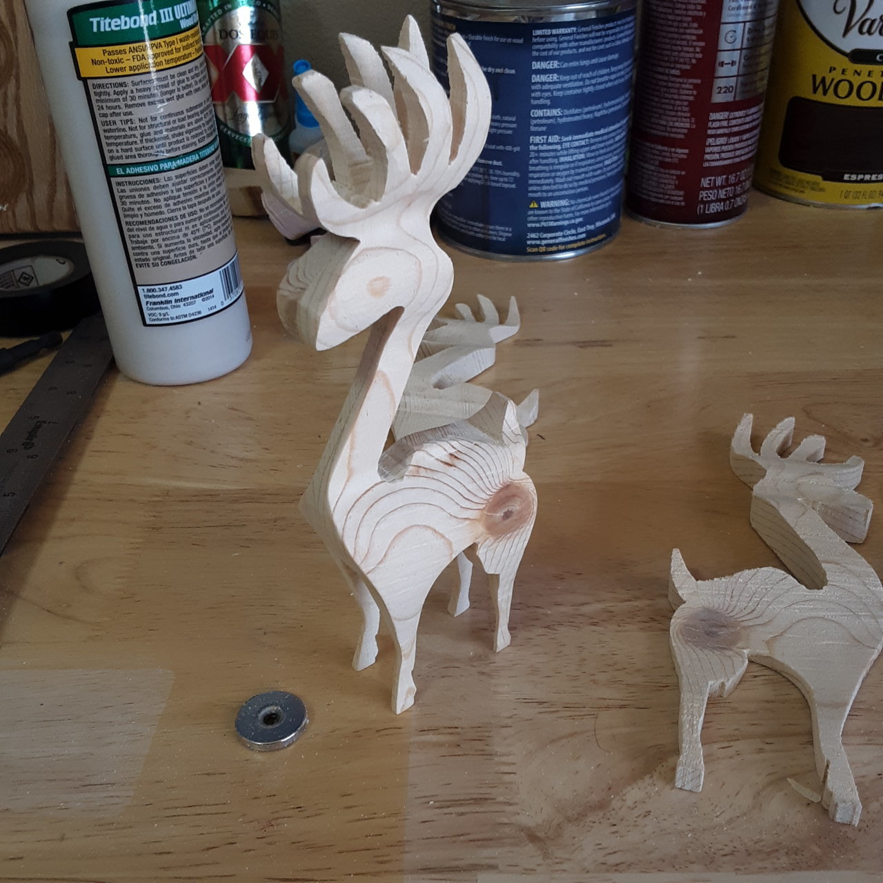

    Messing around on bandsaw today. Used a Template glued to the block

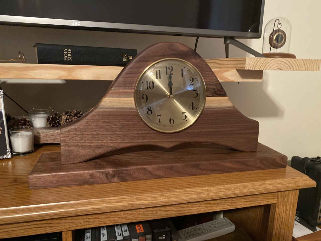

    Got a free walnut tree from a good friend last year. I actually got it for another friend who has a sawmill. He cut it up and gave me some lumber out of it. I made this mantle clock for the young man that gave us the tree.

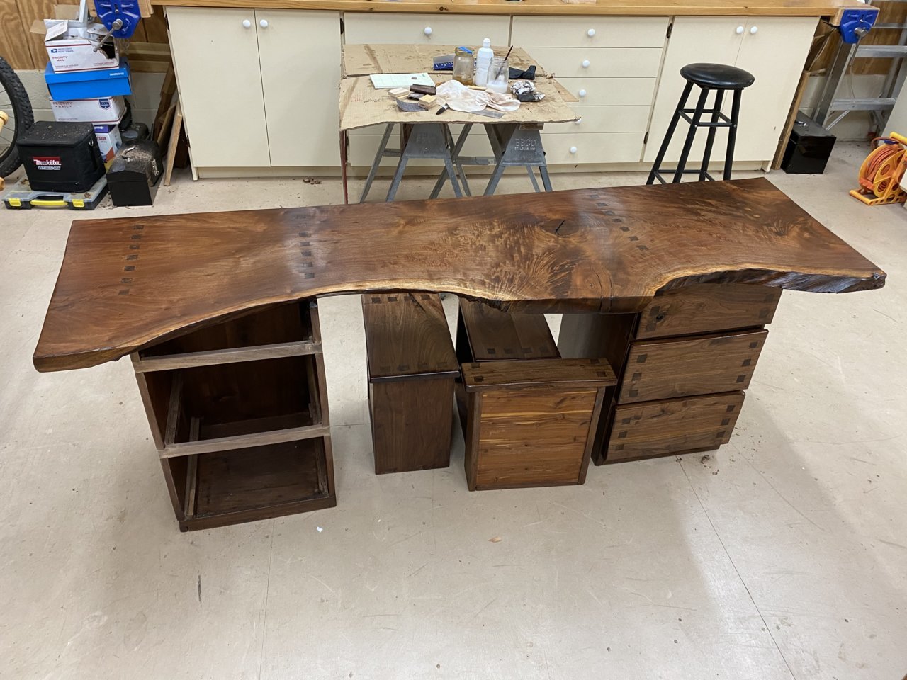

    been putting in a lot of hours on the desk recently. So so so close to being done.
    To recap what I ended up doing:
    Sanded the top and drawer fronts down to bare wood. The rest of the desk just got a quick sanding with 120 then 220. The top got sanded all the way down to 400 grit. Fresh antique oil on the whole thing. Did 2-3 coats on the top and other lighter areas. Shellac to seal. Then water based poly.
    I’m only putting shellac and poly on the top and drawer fronts because they’ll see the most wear and “touch” . I’ve been wiping on the water based poly on the top but it’s not going on thick enough (probably because it’s a brush on poly not wipe on). Going to try a fine bristle brush for the next coat or two and see if i can even things out.

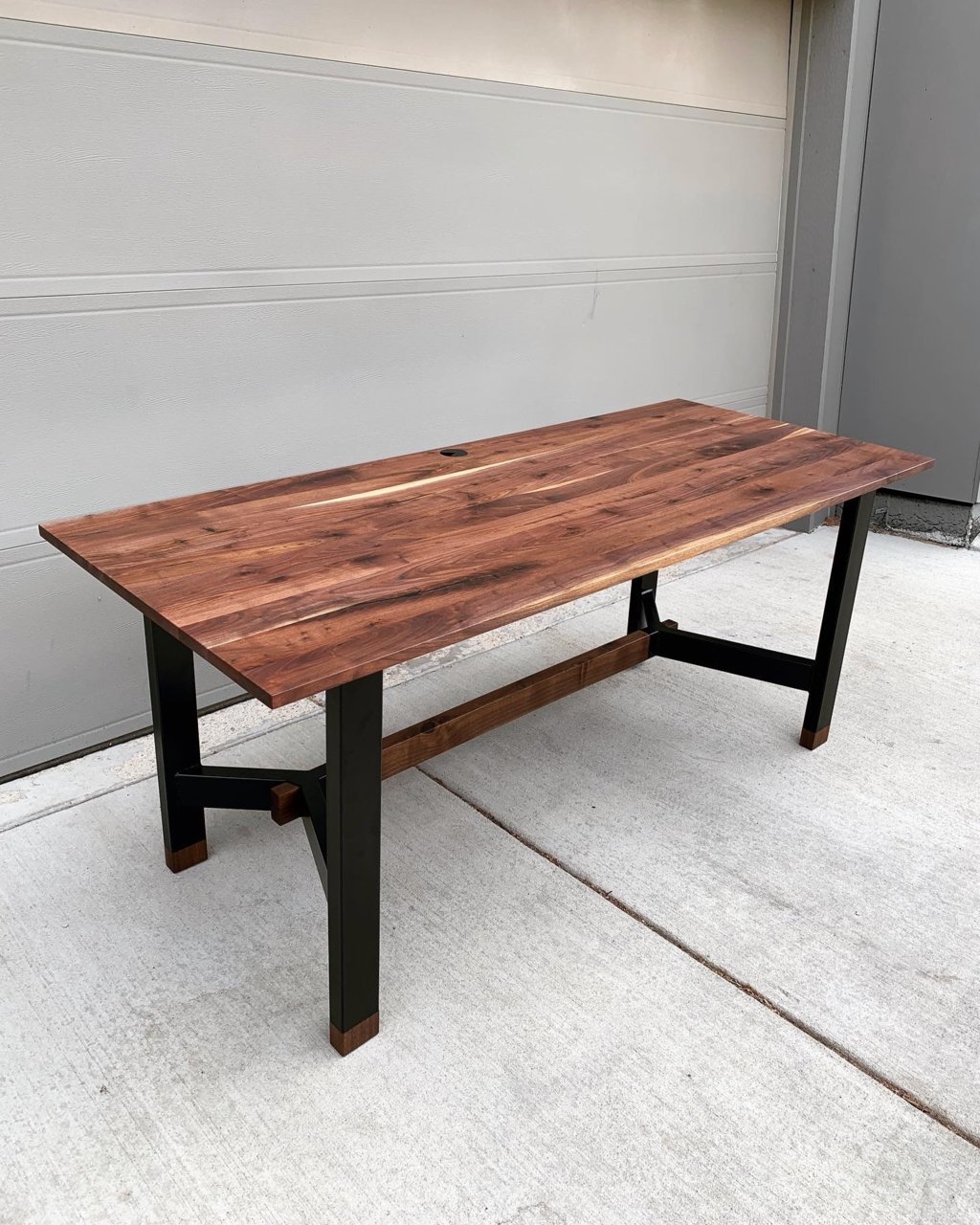

    Just stumbled upon this thread. I build custom furniture for a living so this is fun stuff! My website is dustandspark.com if anyone is interested.
    Here's one of my favorite builds from earlier this year:
