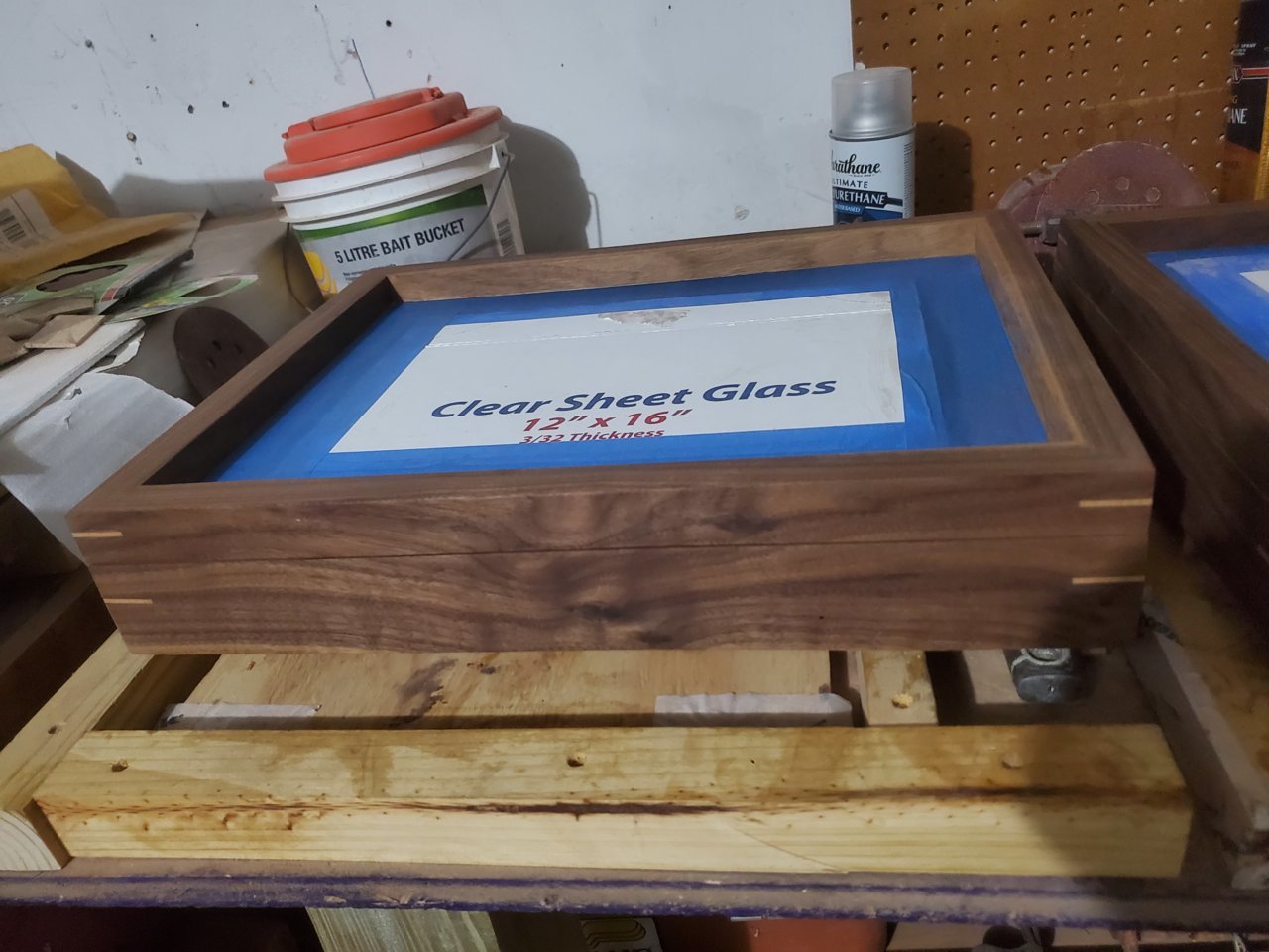

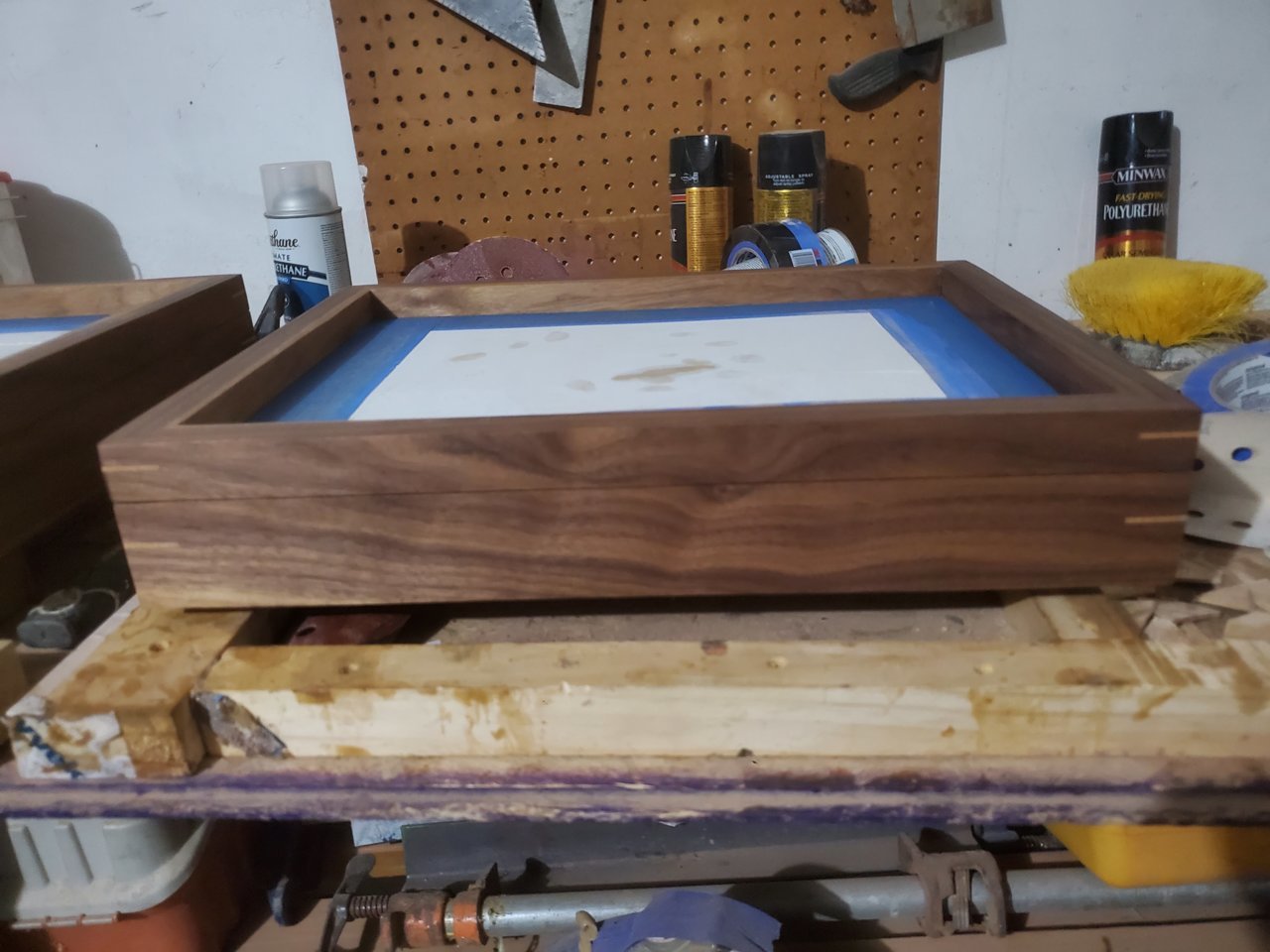

    2 more artifact display cases ready for finish.

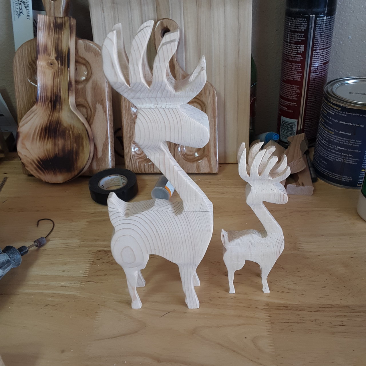

    These take a long time to sand
