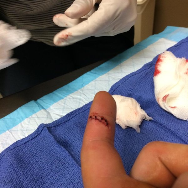

    I slipped with a 3/4" chisel when preparing a stringer for stairs.

    Oops. How many stitches?

    5

    Nice. Had the same number in my fingertip when I lopped the corner of it some years ago with a swiss army knife. The two through the fingernail were the worst to watch.

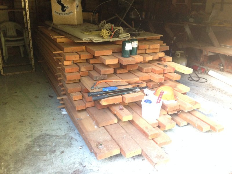

    Had to dig into one of my secret squirrel lumber stashes today
    This is some full 2" random width , fine grain Doug Fir I've had stickered and air drying in this shed for literally a decade
    It's primo material , I bought a couple part lifts from a saw mill that was going tits up
    Current price to buy fine grain Fir 2x6 here is $9/lin foot , I think I might sell my whole stash and retire lol

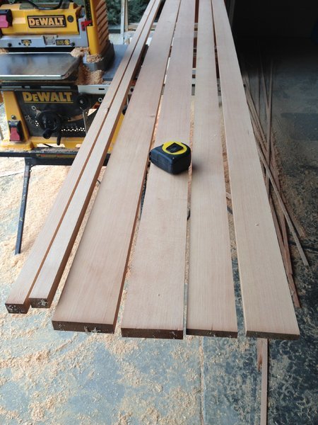

    So milling today
    Good yield , just out of the 2 / 2x6 I got 2 / 1"x4" head casings , 2 / 11/16"x3 1/4" aprons and 2 / 1 1/4"x1" applied nosings
    As you can see by the grain , this is mint material

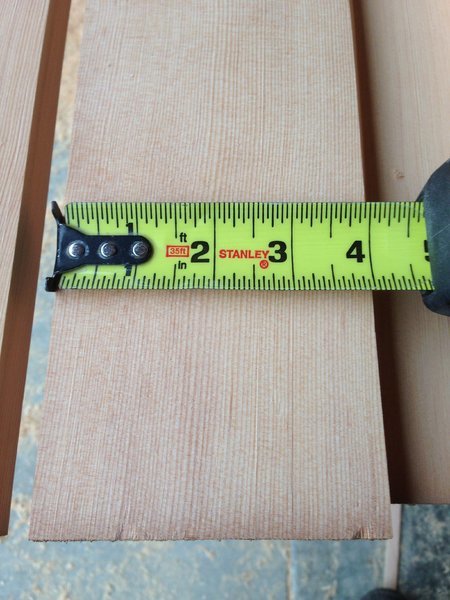

    Pro Tip ~
    That right there is the secret sauce ingredient for installing door and window casings using flat stock like in Arts + Crafts or Japanese trim styles
    The V rebate in the back of the casing eliminates the bridging effect you get when the edge of the window liner / door jamb is not perfectly flush witb the drywall ( like never )

    I usually leave about 1/4" of flat area on each edge to seat properly against the face of the window liner / door jamb / drywall for glue and it allows a bit of trimming incase things are really out of plane , that pic doesn't really show that too well but there you go
