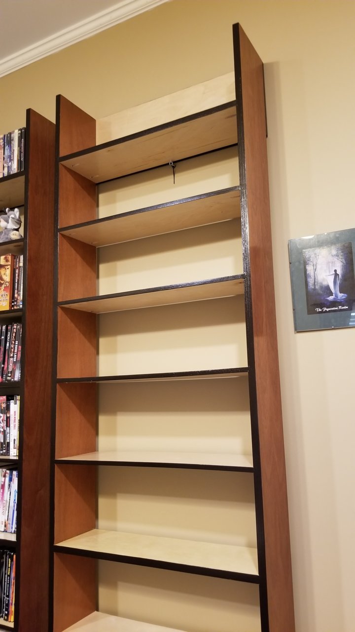

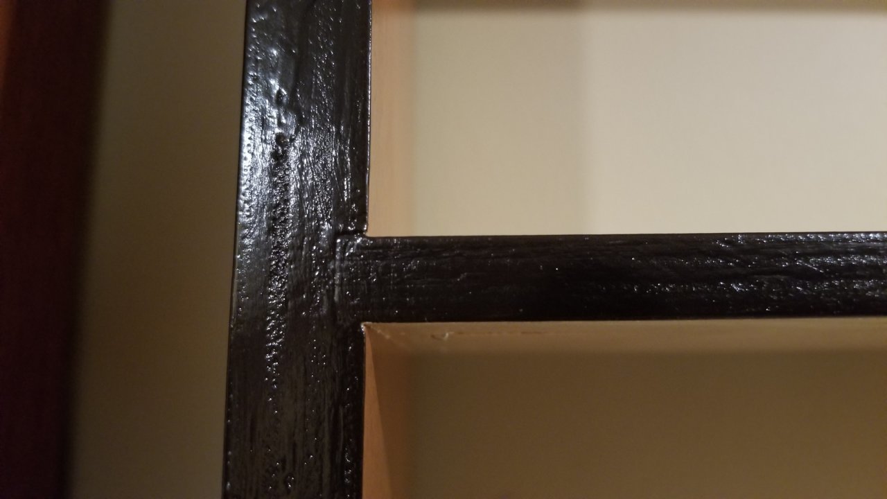

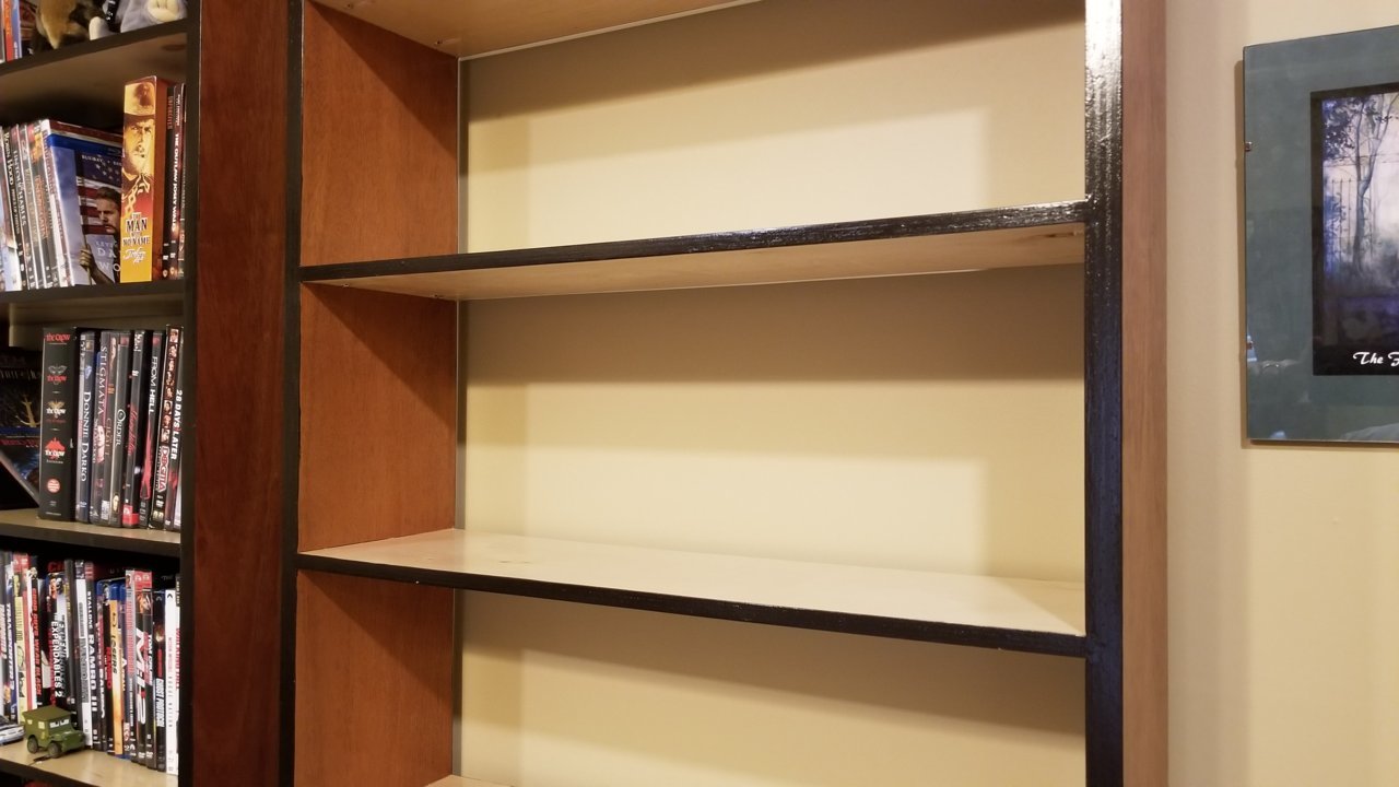

    Finished my dvd shelves. 2 of them each about 2' wide and 7.5' tall.
    All made from leftovers/scraps or 1 off pieces of wood I've had for years that wasn't really enough material for other projects that came up. The long skinny mahogany has been sitting here 9 years at least. I hate wasting materials, even if it's just plywood.
    First time that i haven't faced the edges of plywood with real wood. Did 2 coats clear, painted edges with 2 coats of "milk paint", then 2 more coats of clear.
    Kinda wish i had taped next to edges instead of free hand painting. Brush wrapped over edge in some places. But, for what it is, I'm happy with the results.

    Looks good

    Thanks.
    I feel like it's almost too simple looking. Plain.
    Gonna keep telling myself 'it's just a movie shelf, it's perfectly functional as is.' Lol.

    Some times simple is better IMO

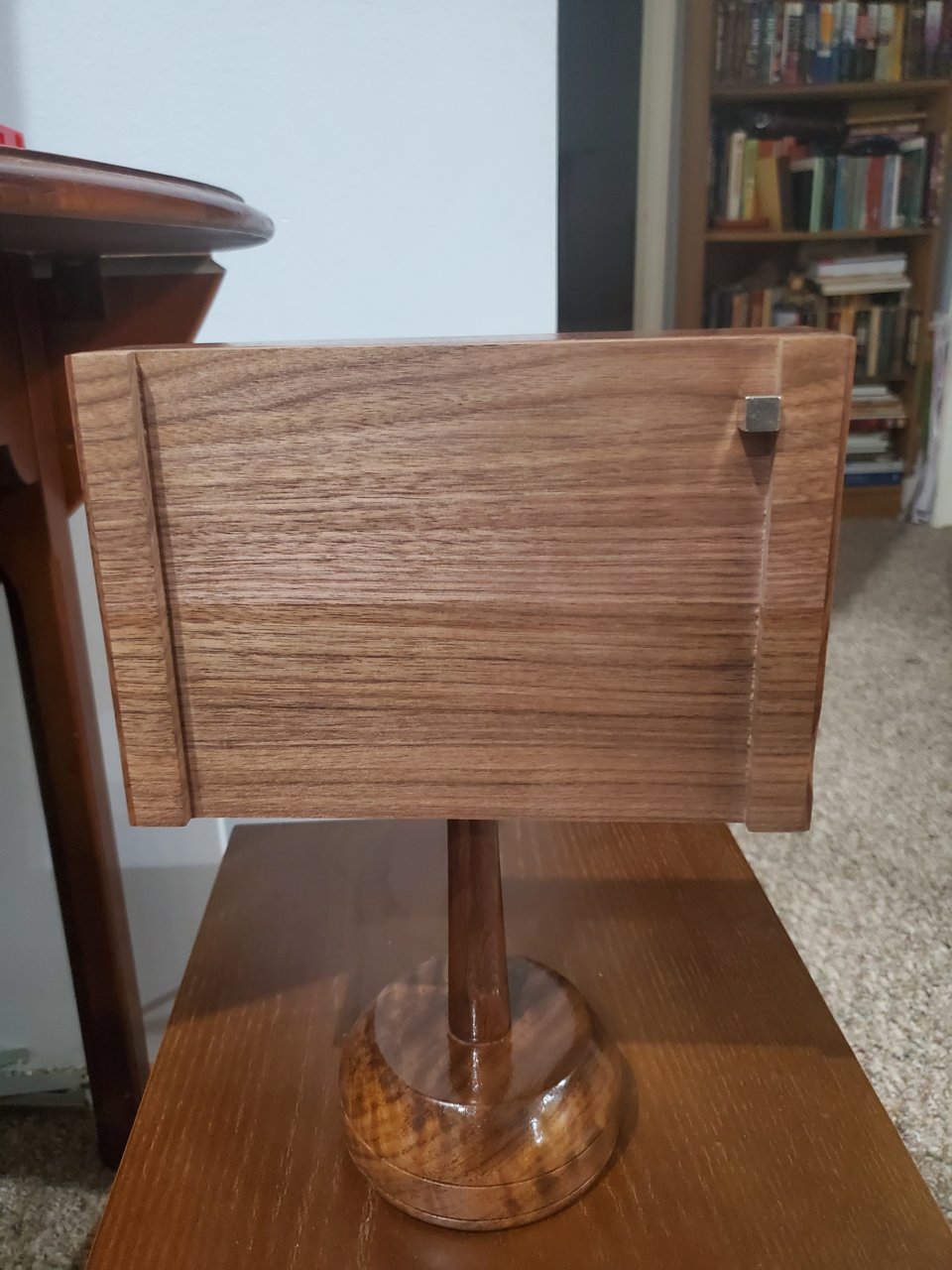

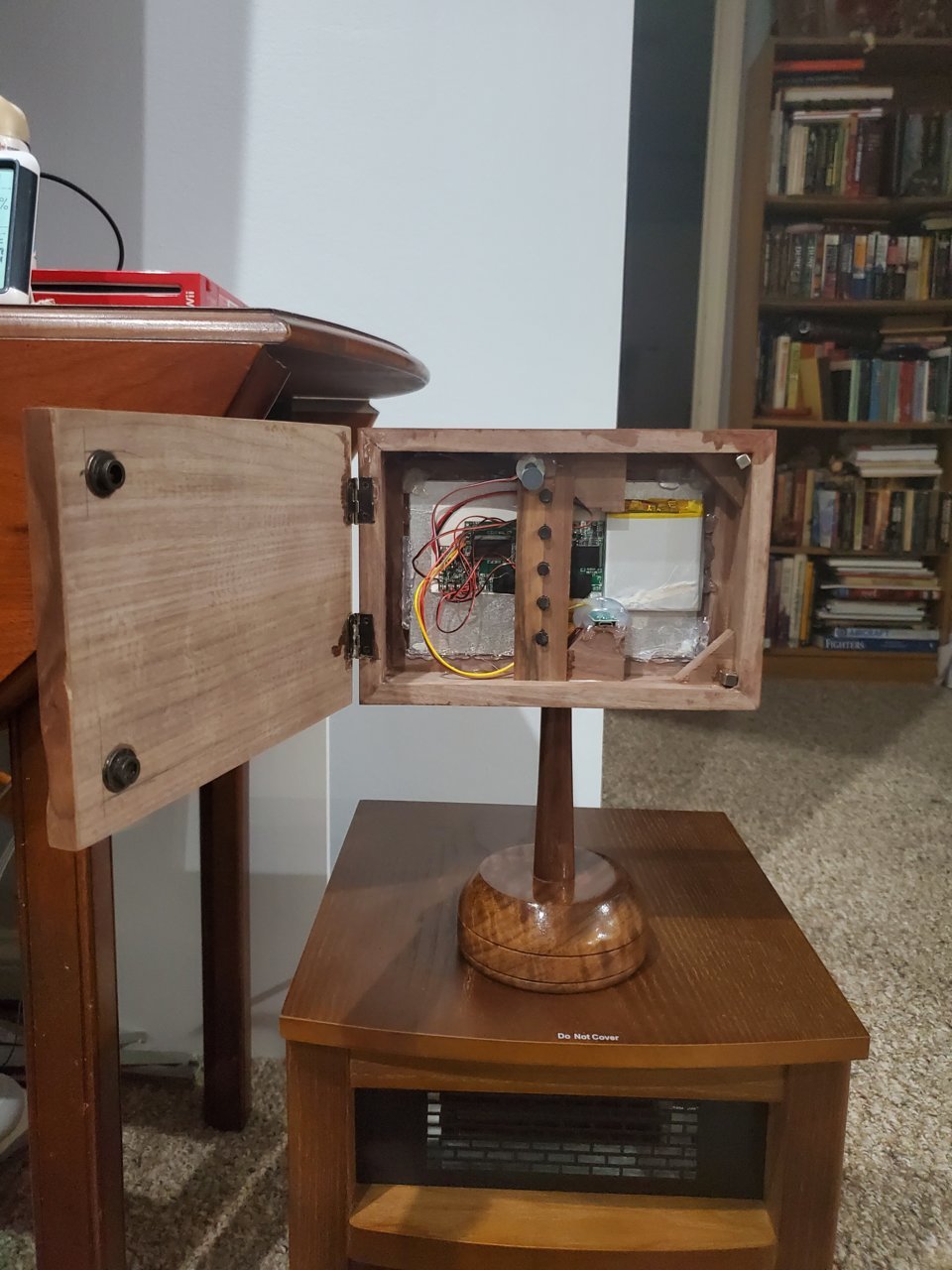

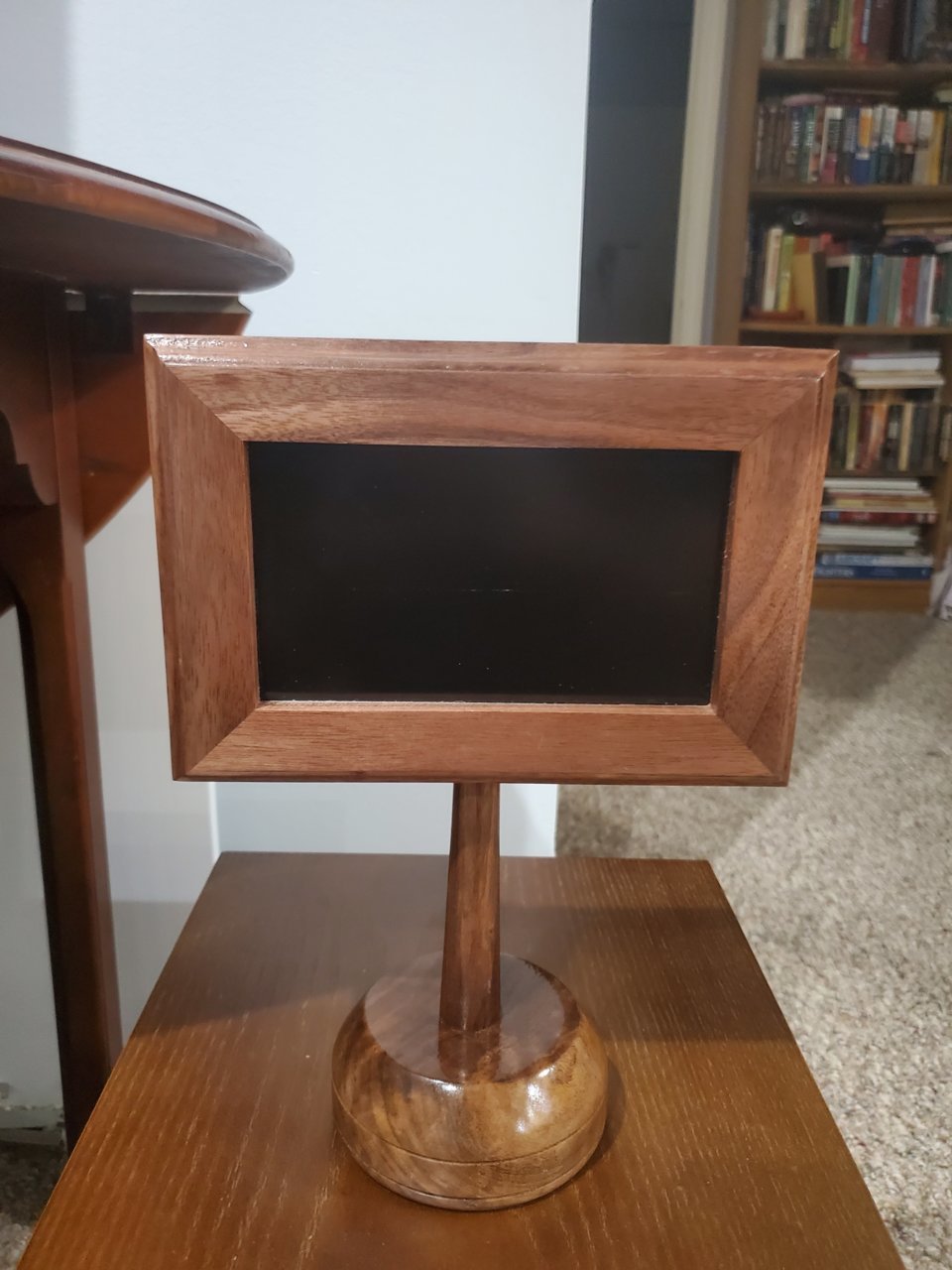

    Ok the finished video billboard for the happy Birthday Kyle Foundation dot org.
    Solid walnut, some reclaimed walnut, some new walnut, and a green walnut bowl blank base.
    The magnet turns it on and off and opens the door. 20201117_173502.jpg 20201117_173509.jpg 20201117_173444.jpg 20201117_173426.jpg 20201117_173413.jpg

    Thats neat!
