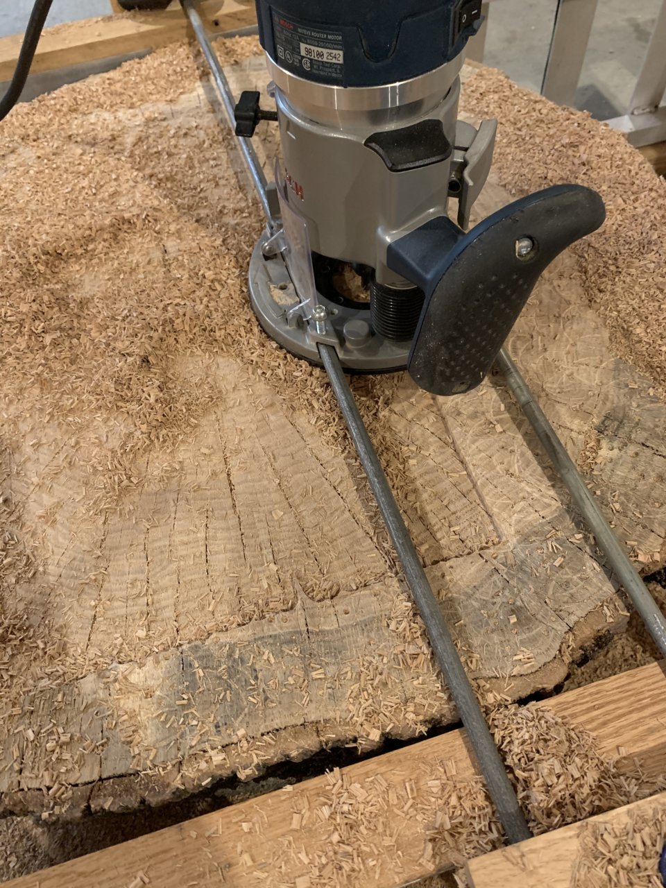

    Does it slide on the bars or does the bars slide on something? If the latter you could put a wood support/scrap piece across the bar span the height of the bit depth. I assume you are trying to flatten the wood

    Yes, the log has about a 3/4” slope from one side to the other. I was gonna: slide on the rods, move the ends, make another pass, repeat.

    You prob have to build a router flattening sled. Not too difficult, i built one before

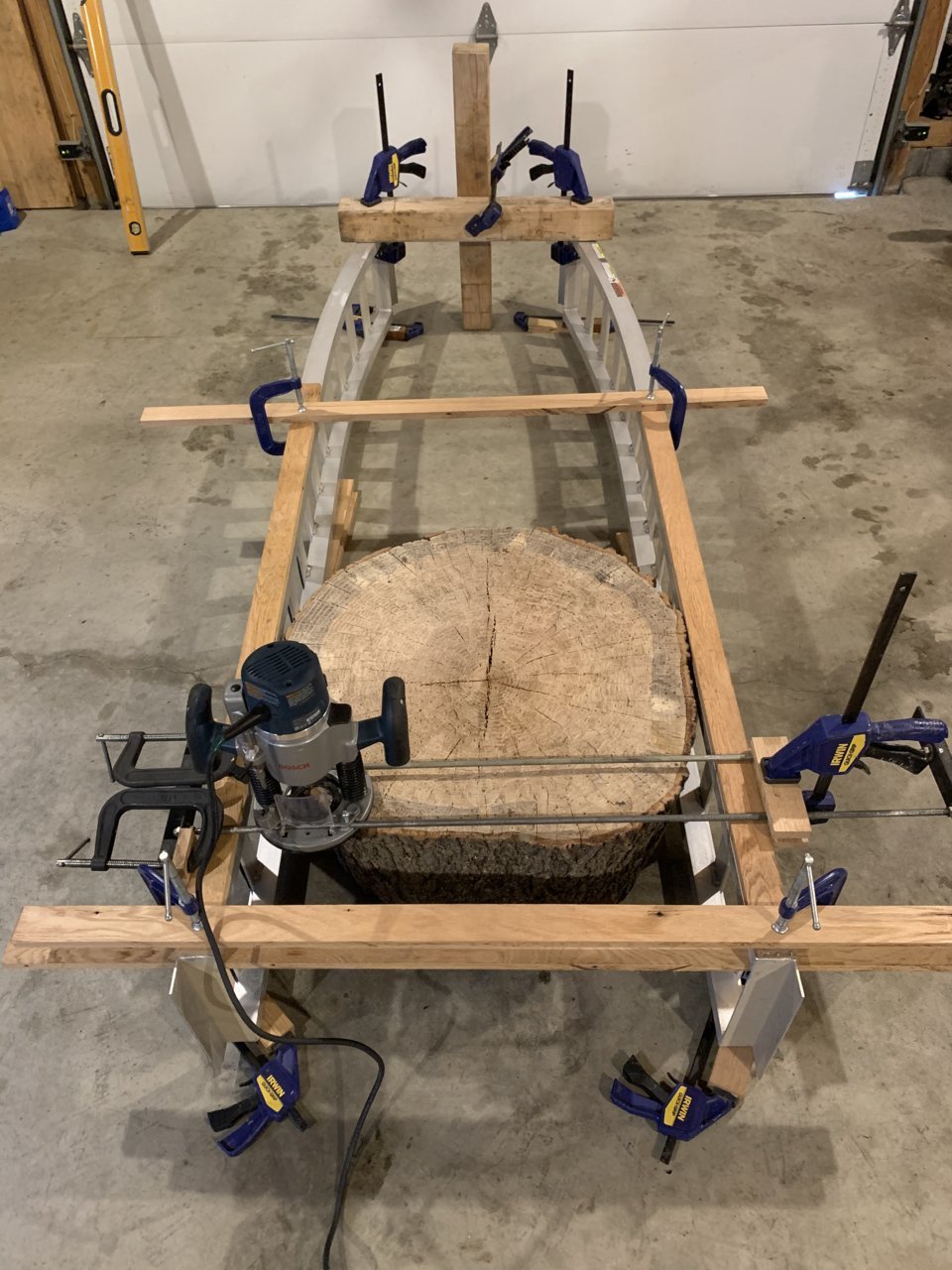

    So.... if I whip up a box/sled for the router I think I can get my aluminum ramps rigged on their sides and leveled for ‘rails’. Stay tuned...

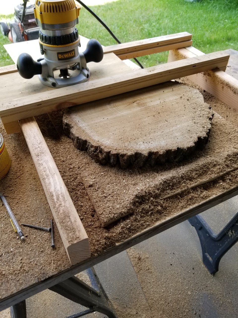

    Yeah, a sled is where it's at.

    Simple but works! You have an extension on the bit or does it reach ok?

    No extension. It reached fine with the normal travel of the router.

    Once I got it all clamped, the rods weren’t as ‘flexy’ as they seemed....
