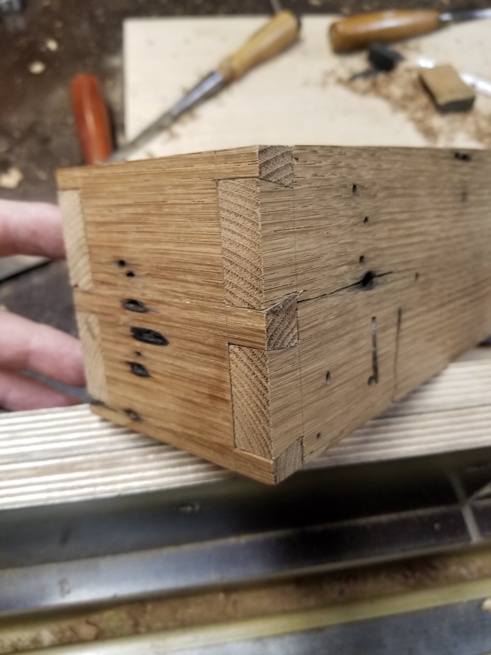

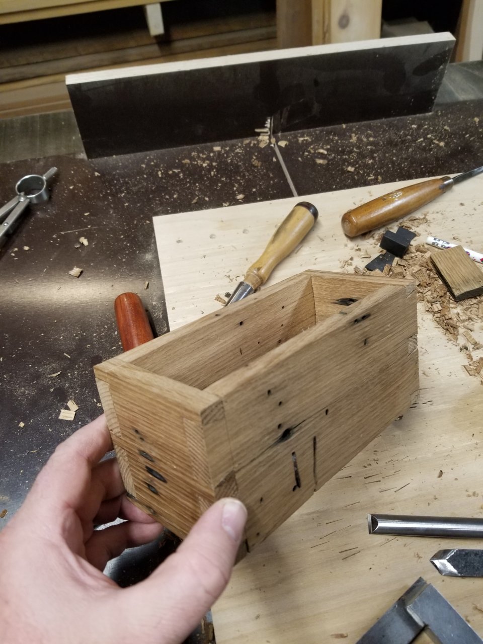

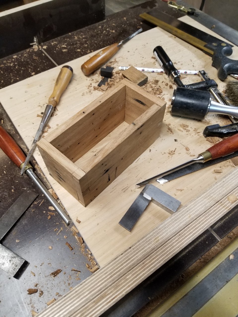

    Nice dove tails

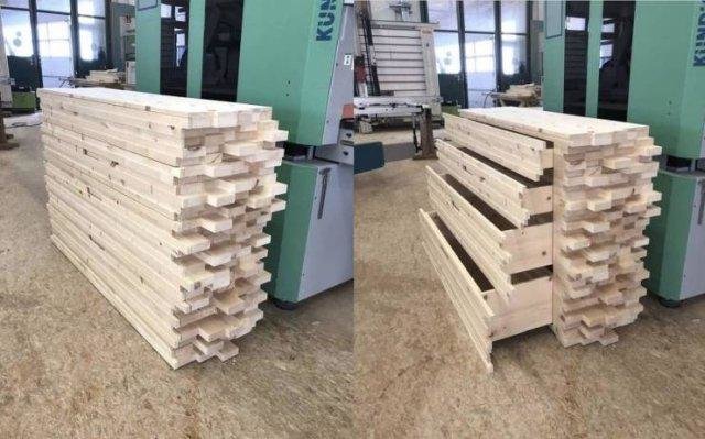

    I dont feel im excessively ocd but this is neat but bothers me at the same time...wood_dresser.jpg

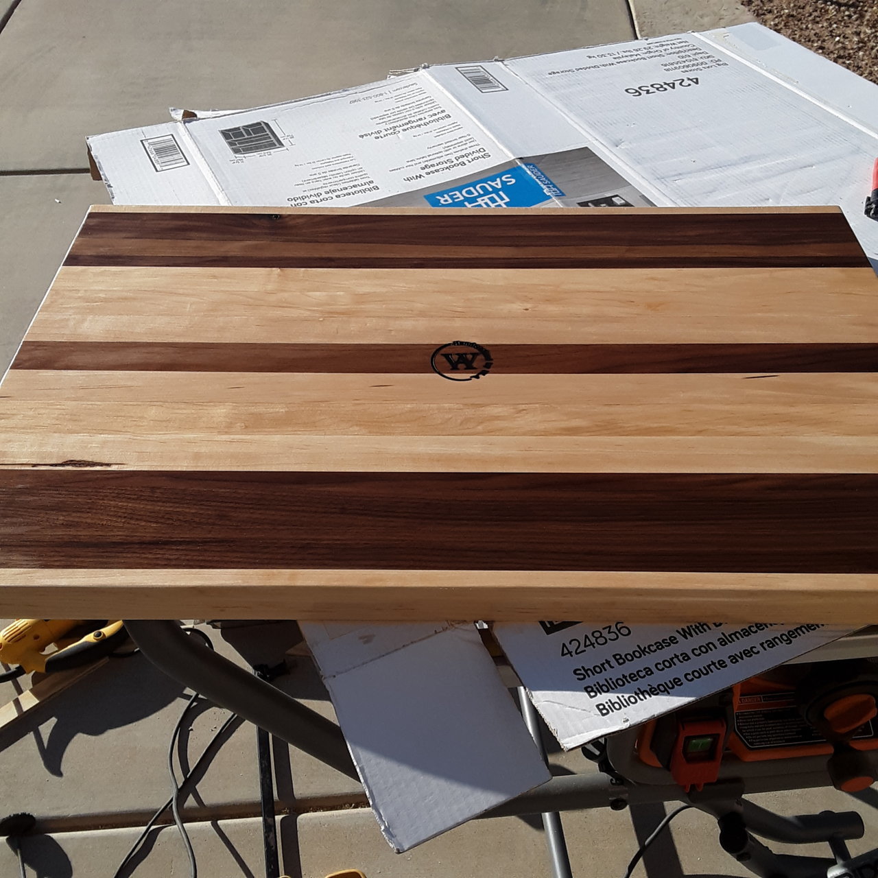

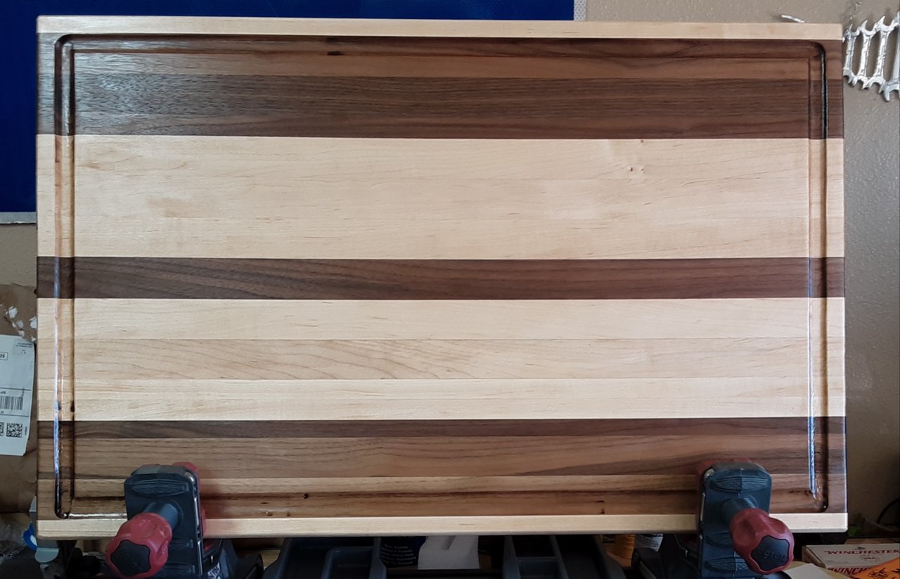

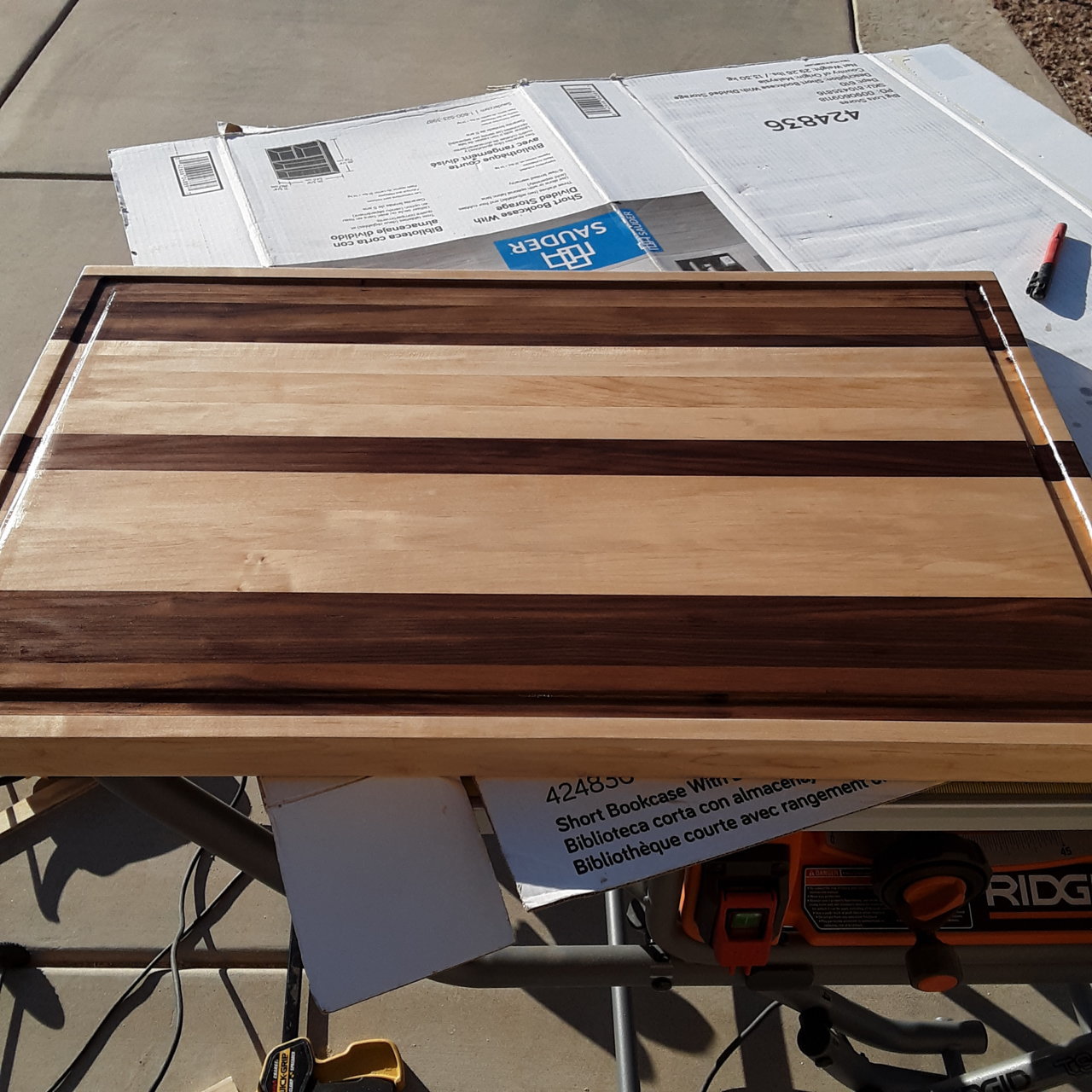

    98% done. Seal is on the back, for who ever was complaining last time...:laugh:

    Looking good! What finish did you use?

    I use i coat of salad bowl finish then i was using a feed n wax but apparently its not food safe...so i had to wash it off, which there wasnt really anything bad in the feed nwax but better safe than sorry. So ill be putting mineral oil on it.

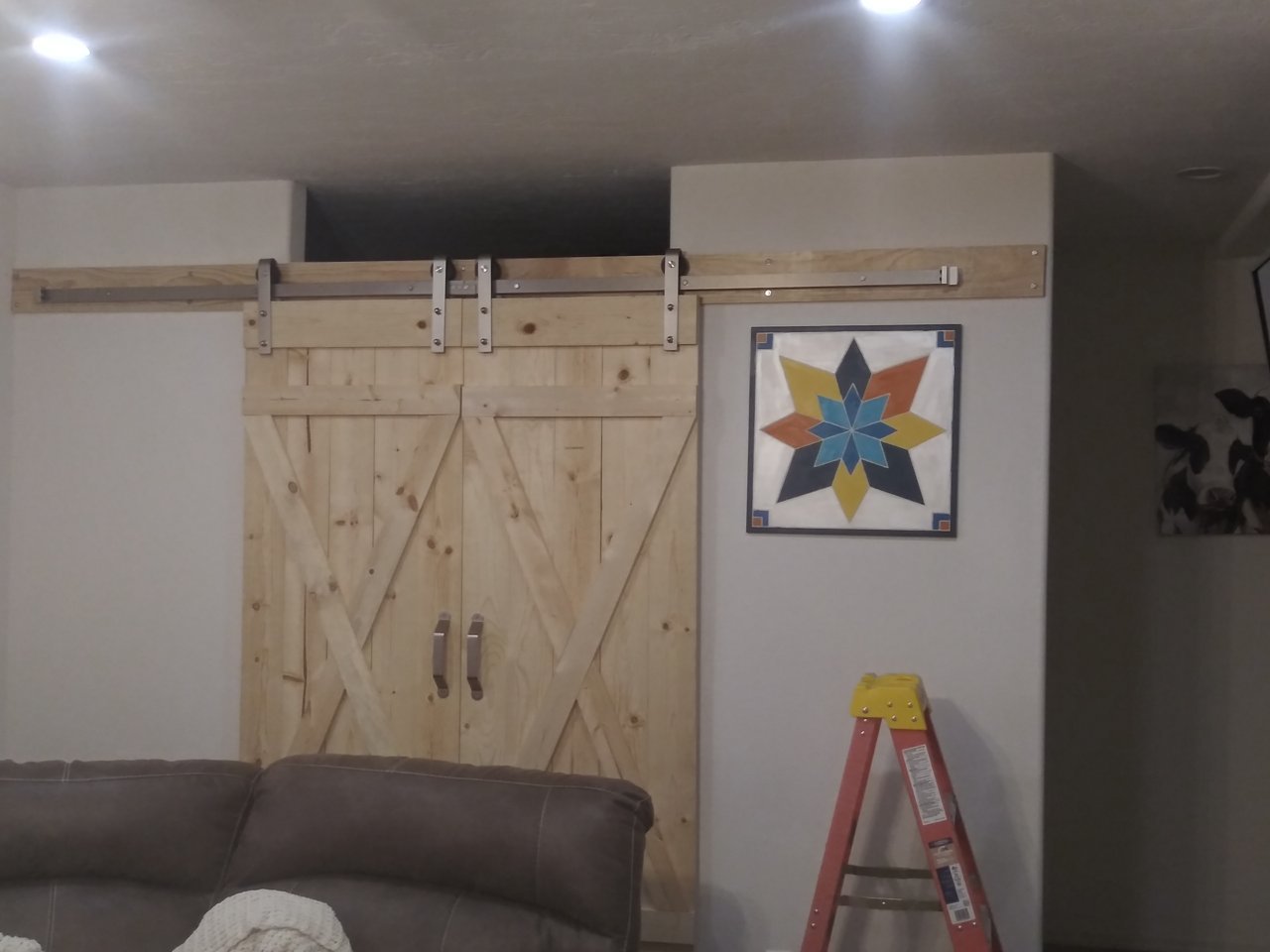

    Made a set of bastard sized barn doors and got them hung.

    Nice

    Thank you sir.
    This is a rain day for me. I'm still having a hard time figuring out a wifes hidden message. For now I "got to" make her a set of doors.

    Nice! I have used salad bowl finish in the past, but have just been using mineral oil + beeswax to coat my cutting boards (which by themselves don't get that shine I saw in your photos). Maybe I should buy another can of the salad bowl finish..

    I did multiple coats on the juice groove as its not going to be cut on so it will stay nice. It does take a few days to cure though for thicker coats. This is what i use

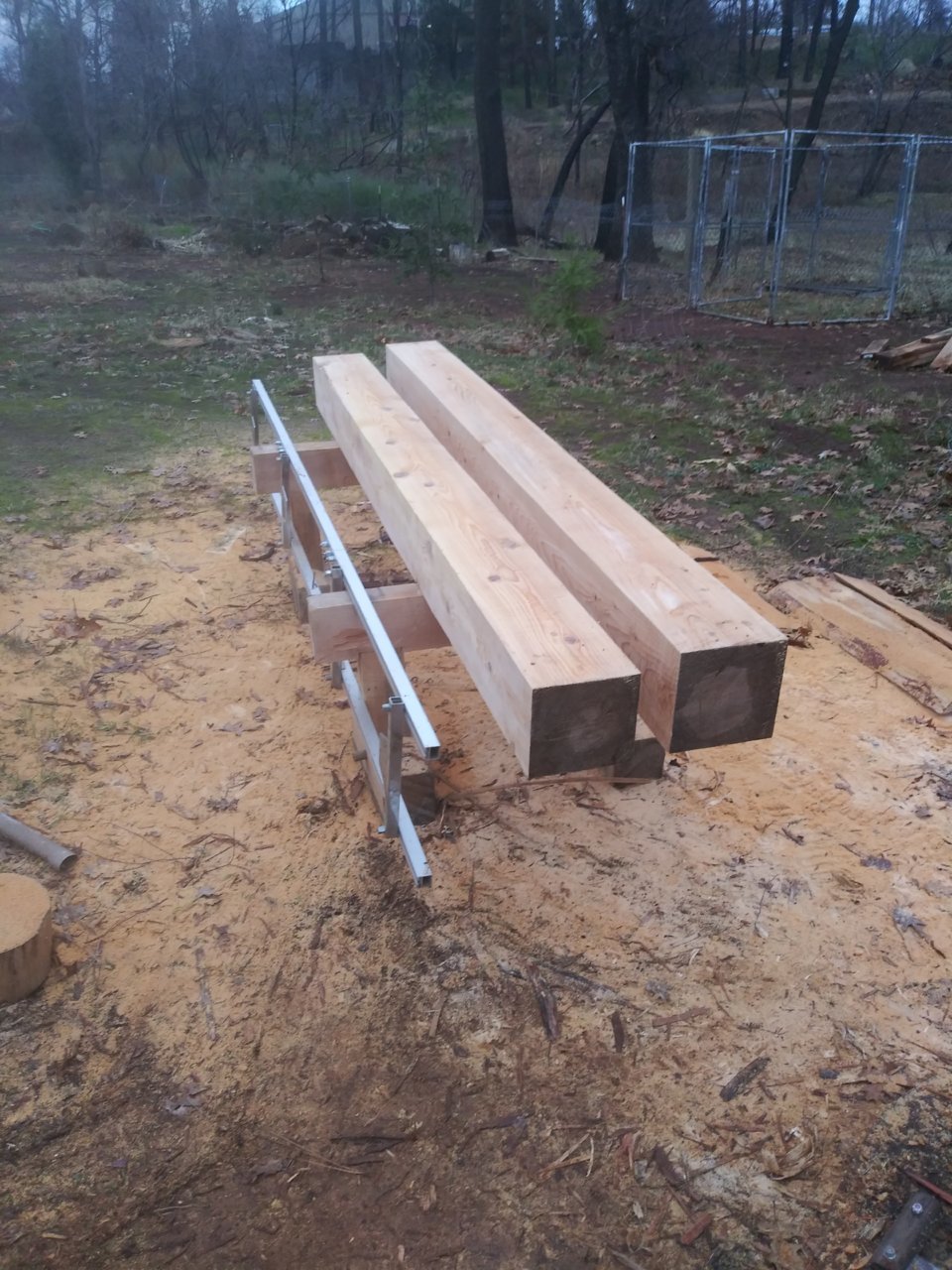

    Milled out a few beams between the rain. Can't wait to get them all milled to start the pergola. A little help from a few old timers and we gonna get a mortis and tenon pergola!

    Chainsaw mill? What chainsaw are you using?

    Yes alaskan chainsaw mill. Using still MS 661c for making the cants then swap over to the MS 261 for boards. Love the combo. It works great.
