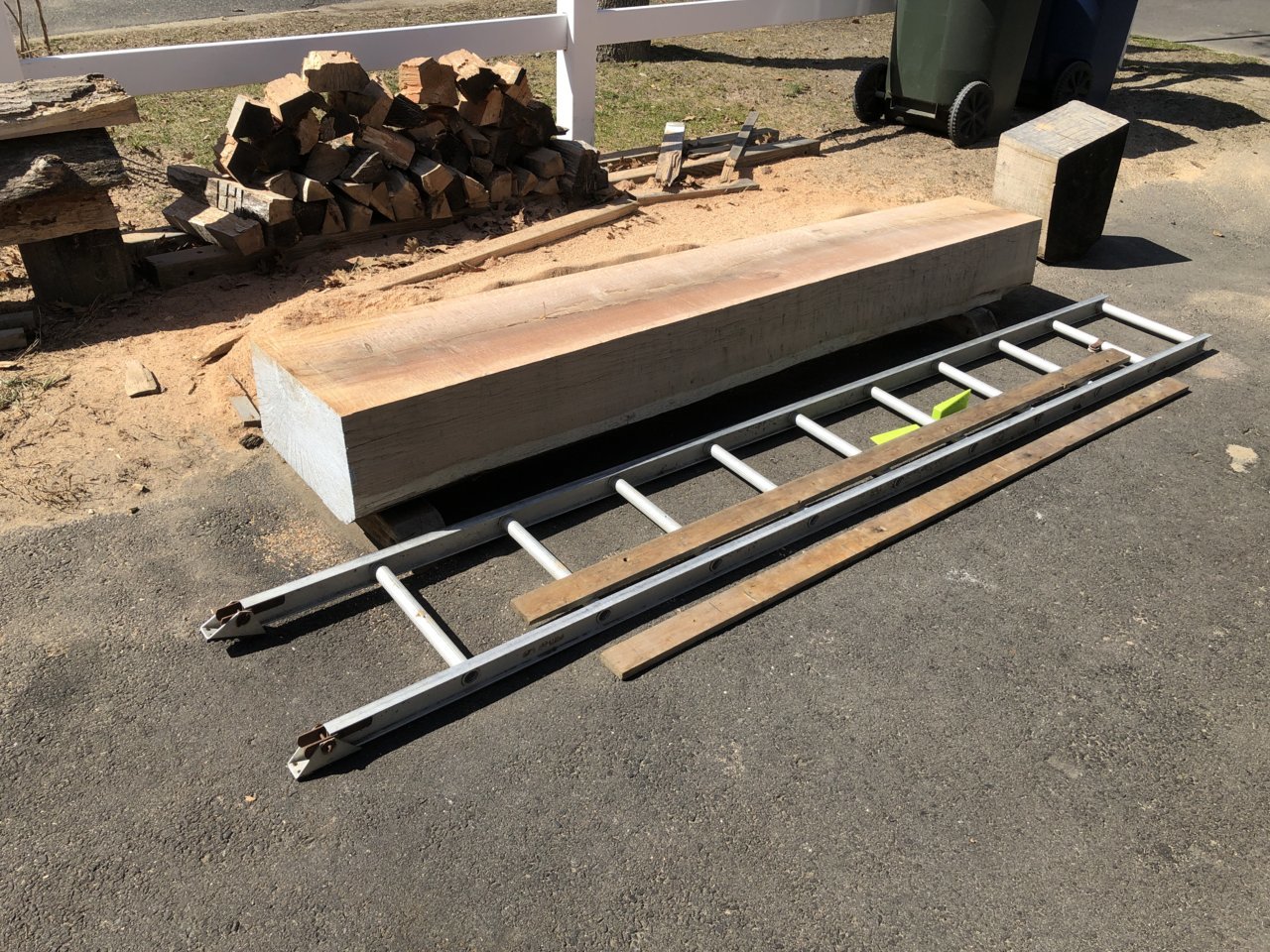

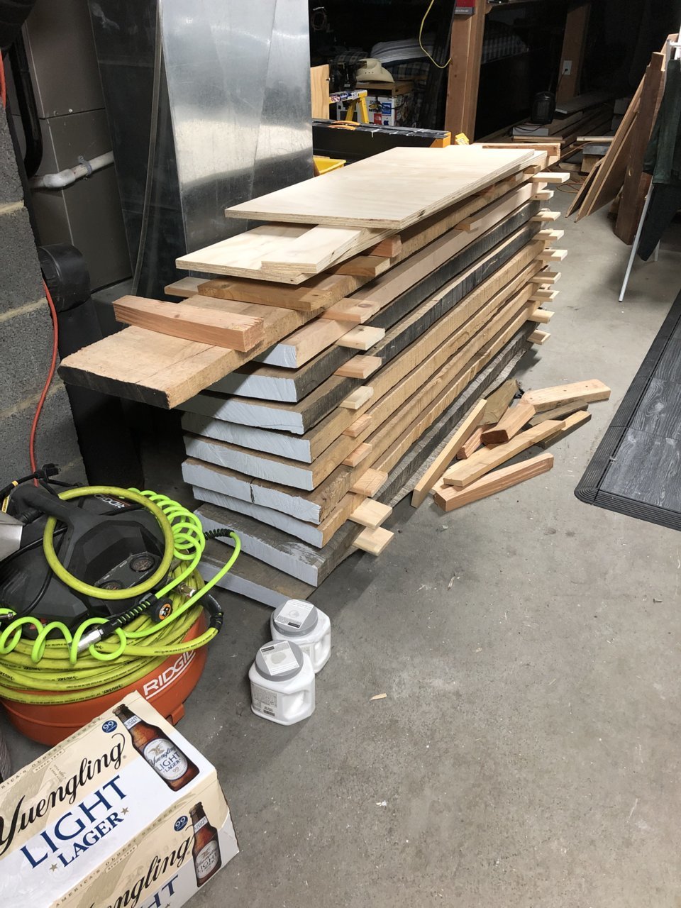

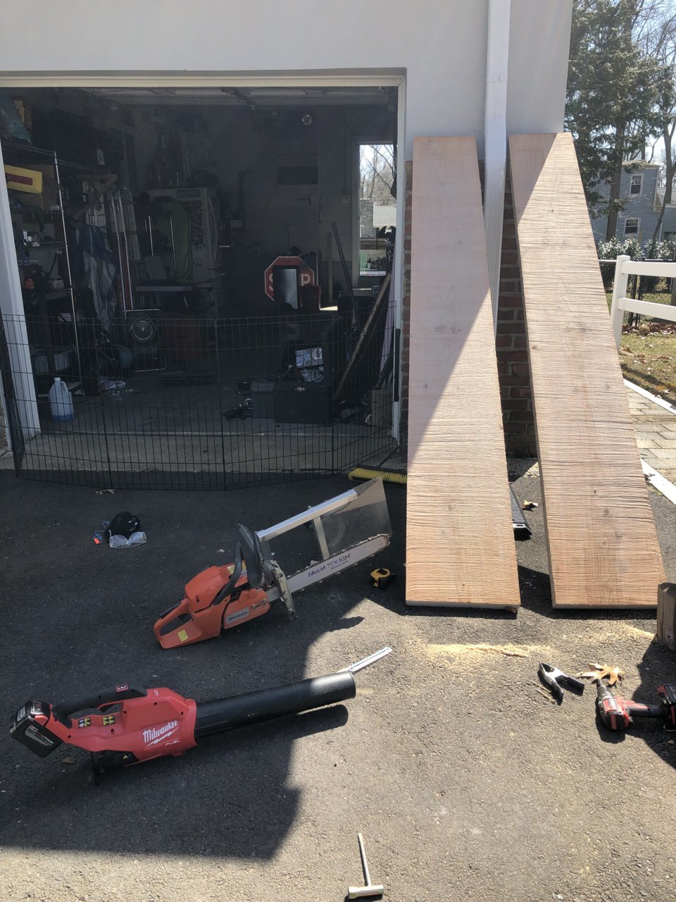

    Do you use ripping chains or just regular chains. I milled a large red oak that I had taken down. My chainsaw mill is the smaller one that only clamps onto the bar in one spot. Bought it to use on my ms250, and milled quite a bit before finding a good deal on a larger saw. Even with a ripping chain and the larger saw, it was a very slow process. I’d like to find a softer wood and see if it makes much difference.

    I use chisel bit round file full comp for my milling. Its a standard grind. Meaning I don't grind or file it to a 10 degree angle every other tooth like a rip chain. I just keep it. At 32and down 10. So across is 32 degree and fille with the tooth my hand or handle of the file is down 10 degrees basicly pushing the file up ten degrees and across the tooth at 32 degrees.
    I fall timber for a living on the west coast. Northern California to be exact. We cut big stuff and I use the same chain and gring angles for all of it.

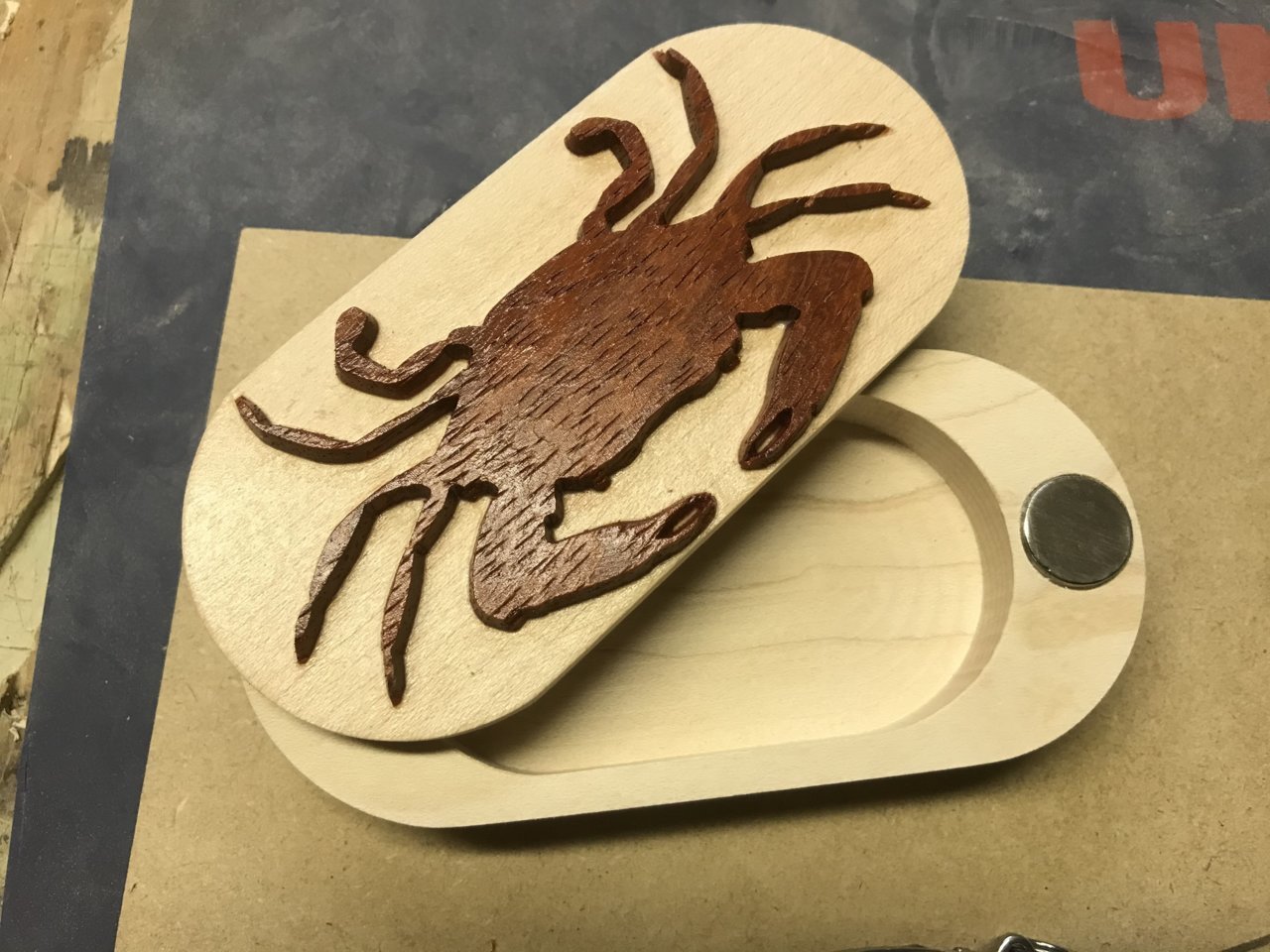

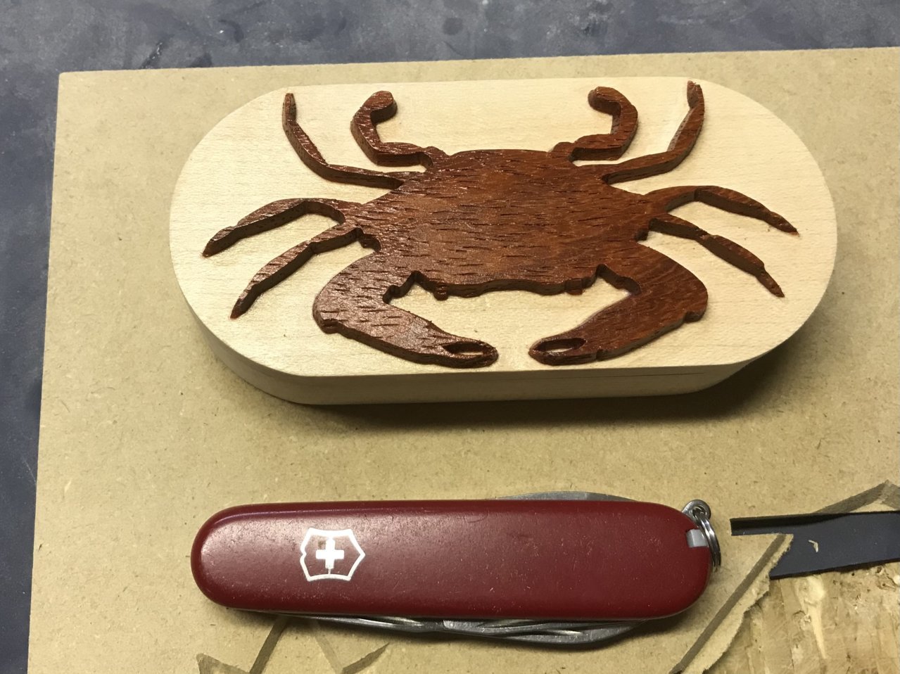

    Maple with paduak crab. Magnets work way better and then I thought

    Very nice! Was the crab a Vcarve?

    Yes

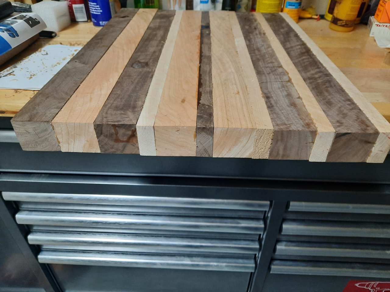

    Starting another board, intentionally not symmetrical.

    Nice. I've got two boards in the clamps right now actually. They're my first ones. I'm trying to decide if I should grab the router for a 1/4 or 1/8" round over to break the edges or just break the edges with the block plane. What do you guys prefer?

    Mostly preference, bigger boards i use 1/2 round over bit, smaller i use 1/4 or just break edge over

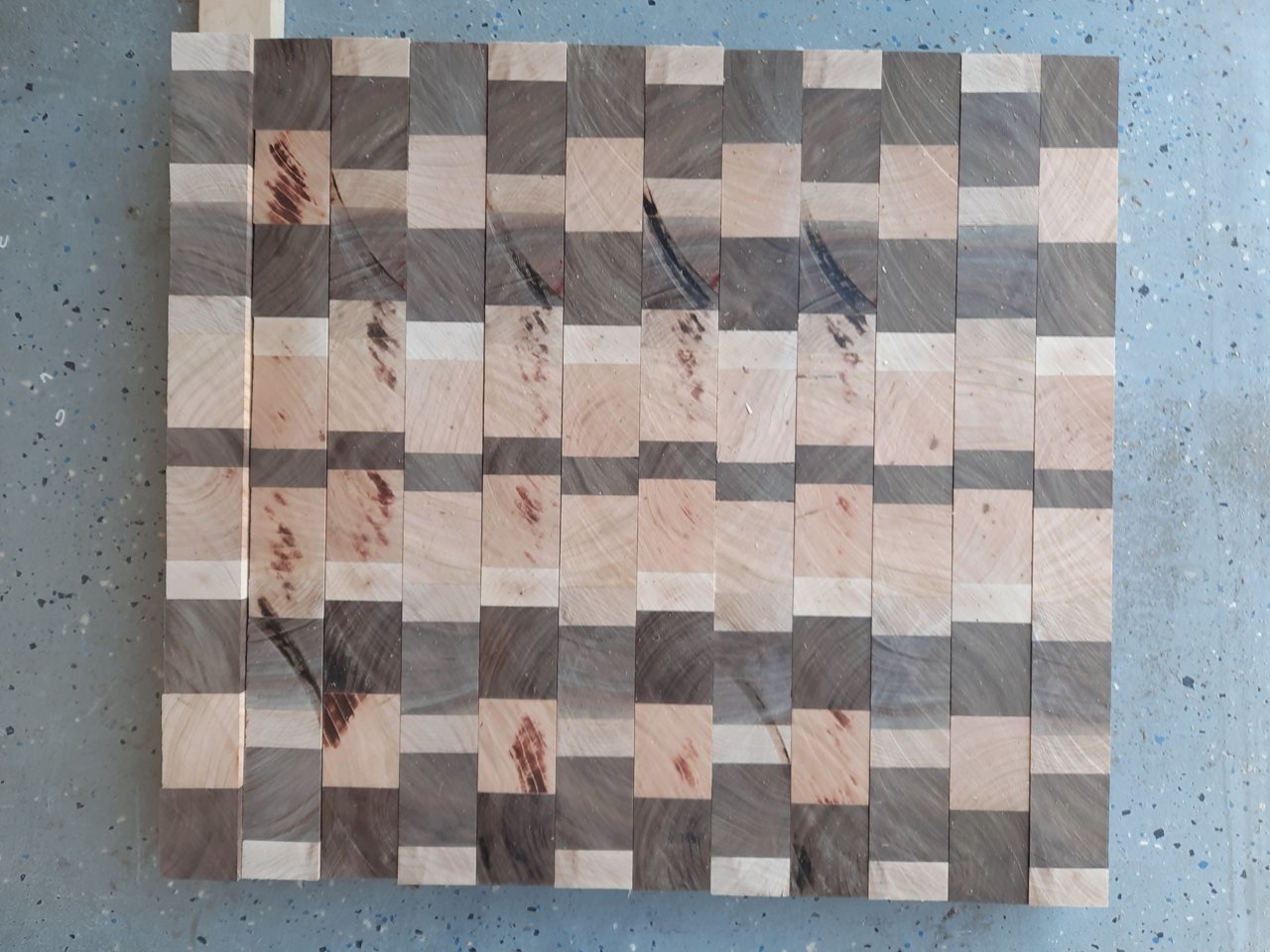

    Love it.

    I dont have a planer still, but so far its going good.

    Black walnut, cherry and sugar maple?

    not sure about sugar maple, but says maple ftom home depot

    Sugar maple is just a generic term that is harder than traditional maple. It's really good for floors and cutting boards.

    The cherry always smells good cutting it

    I love working with cherry too but it's kind of pricey in my area. Actually, everything is kind of pricey right now.
