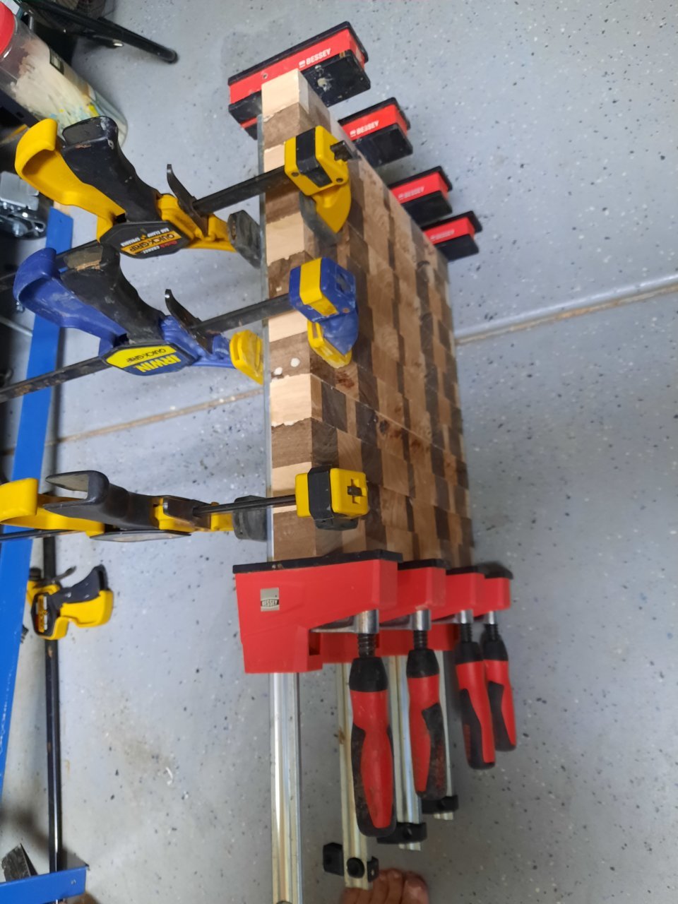

    Those Bessey parallel clamps are fantastic. Love mine!

    Hard to clean but great clamping power

    A little tape goes a long way to prevent a harder clean up...

    Can rub cutting board oil on the metal and wipe down with a rag and it helps remove the glue easier

    Maybe the next stimulus check will be enough for me to buy a pair of those. :rolleyes:

    They are worth it

    I have 6 of the Bora brand from woodcraft. They are marked down sometimes at Home Depot for $35 each.

    i use wax paper to isolate clamps from the wood during glue ups , especially with pipe clamps so there is no staining from the pipes
