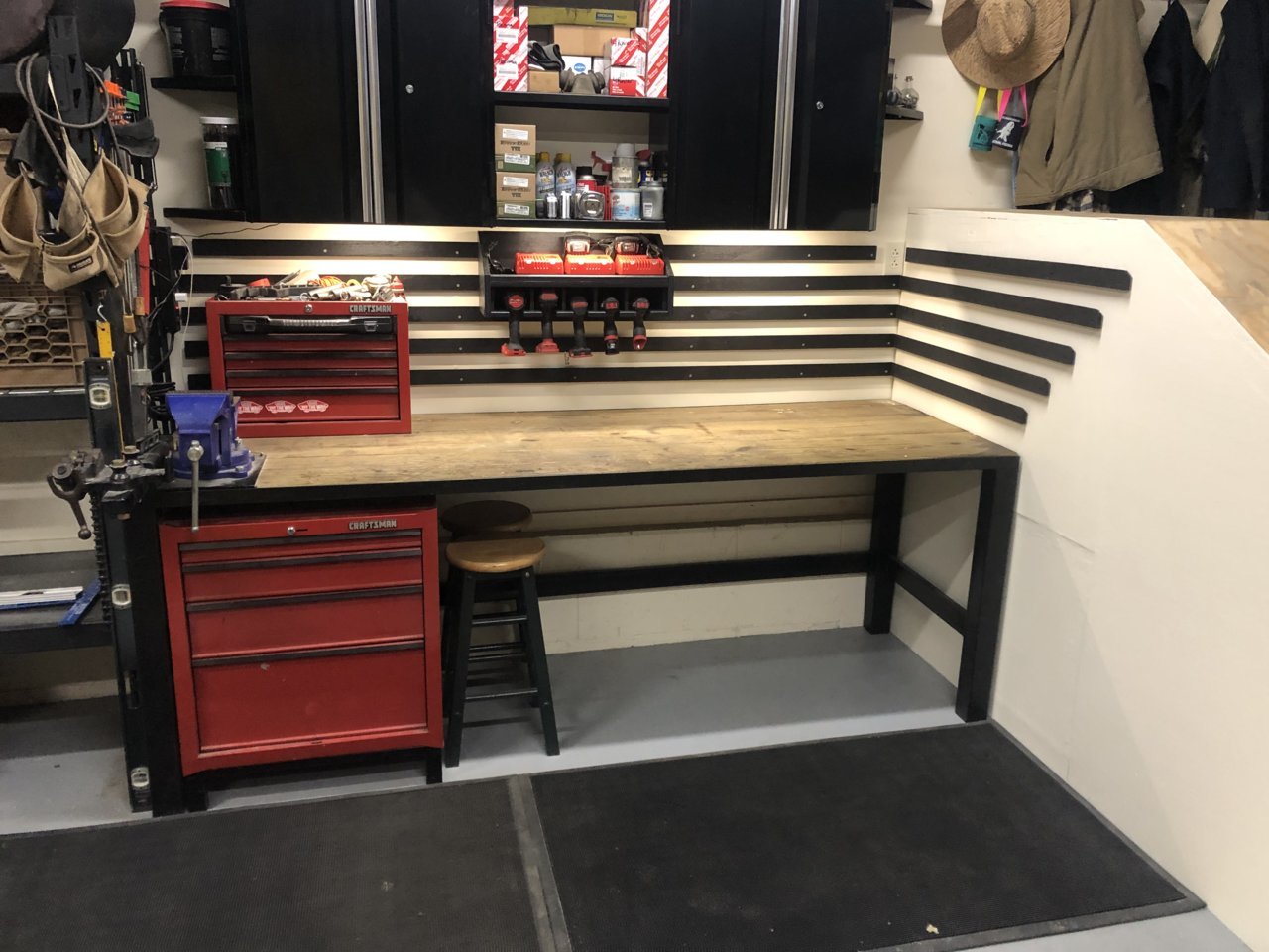

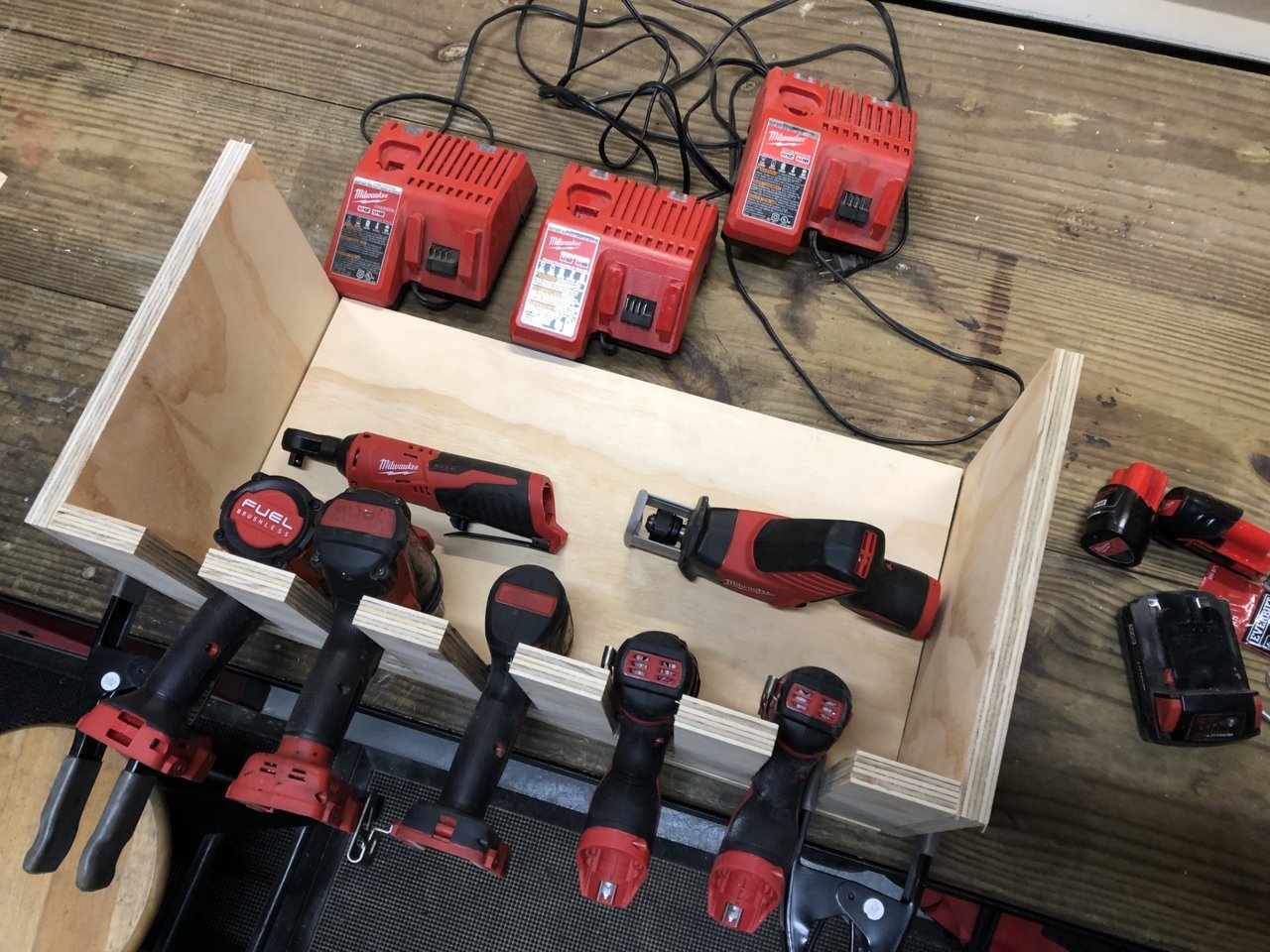

    Made one as well with recently accumulated Milwaukee’s and some free time..
    More cleat mounts to come

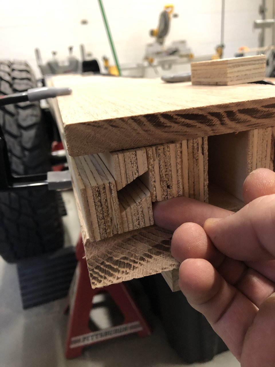

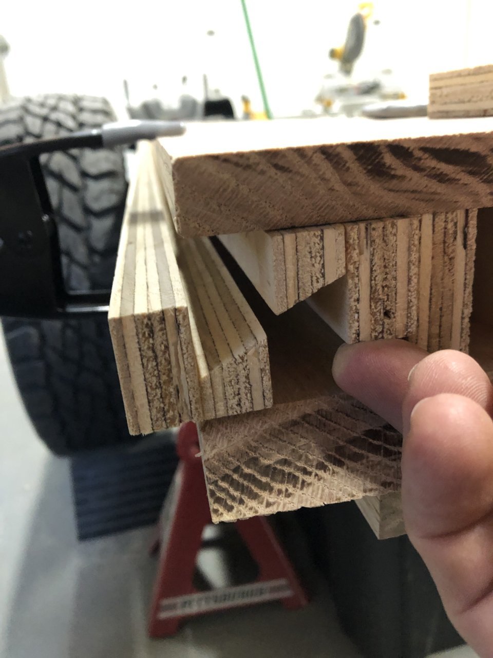

    Wanted to follow up to my question..
    A 25° cleat did work for floating shelves
    https://youtu.be/ODKLlq7CfrI

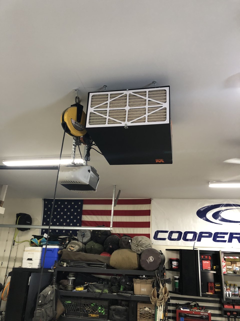

    Also the Wen air filtration is great. I’m sure any filtration is good but this is my first experience with one. My garage shop is 23x25’x11” tall.. I opted for the unit with 3 speed rating for 556/702/1044 CFM. The higher ratings are overkill for the shop size but figured better to have it over efficient. Was also planning to lower it on chains for heavier dust builds but what I’ve seen collected it’s perfectly fine at the ceiling.
