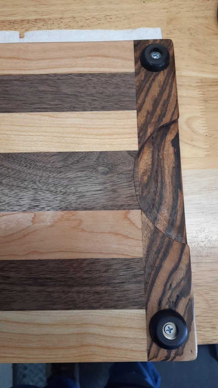

    Some stuff. Not a lot, just some.

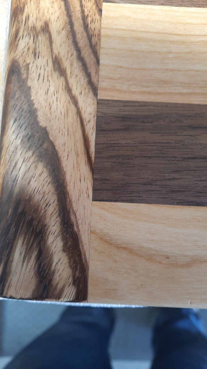

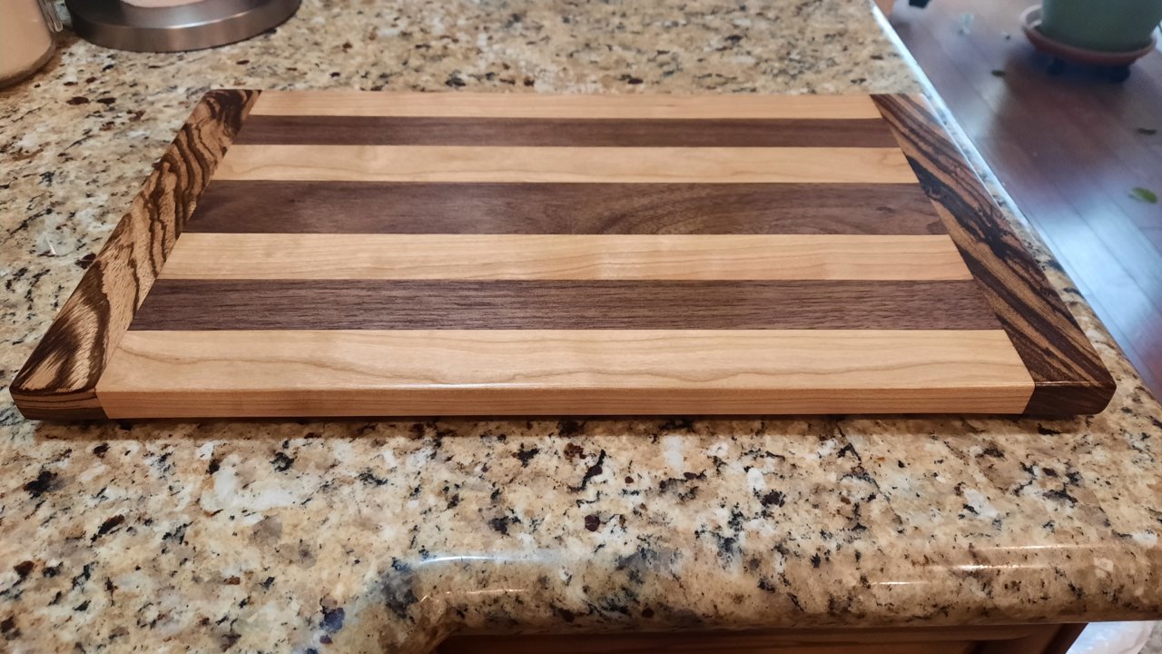

    Curious as to how you connected the bread board ends.
    Looks gorgeous BTW

    thanks!
    Its just Squared and glued, also hand holds and flat rubber feet on bottom since its Only 3/4" thick.

    I'm curios if they will pop off with wood movement... although it may not be concern with your desert environment.

    No sure, it is sealed so its stabilized decent imo. Its headed to michigan so see how it holds up

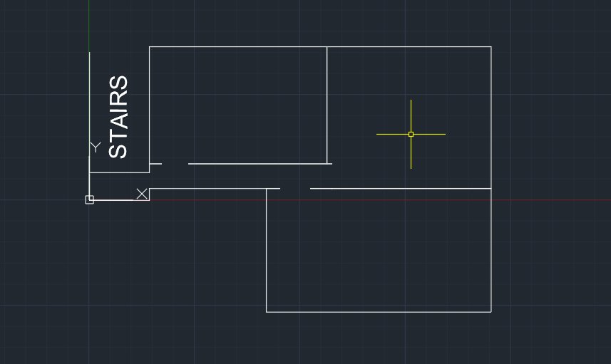

    I'm laying it across 3 bedrooms and a hallway and would like it to be continuous without a transition in each doorway...having a hard time figuring out where to start since you can only lay it down in one direction (tongue side facing out and add to the tongue side).
    I'll do a quick sketch in a second of the room and hall layout..

    If that makes sense...not to scale obviously

    Start in that bottom right hand corner with the male side of the tongue pointed up, Or start in the top right corner with the male side of the tongue pointed to the left.
    I think I would go with the first option though as it will allow you to have the planks running long ways down that hallway. It seems to me like that would look better.
    Does that make sense?

    I'd go with the first option as well, but take some time to measure it out first. That long run down the hallway is where I'd try and focus on the most as it's got the longest sight line. I wouldn't want to have to rip a 1" strip down the left or right side of that hallway alllll the way down if I didn't have to.
    Further to that as most things are seldom square you may find starting in that bottom right room square to the wall, you may end up having a taper going down that hallway which only gets accentuated with the length.
    I'd almost think laying down a strip along the "bottom" (south side if your picture was north up top) of the hall and then spacing pieces 'south' into that bedroom to see what kind of taper you're looking at.
    Baseboard will cover for some small gaps you'd be leaving for expansion around the whole project

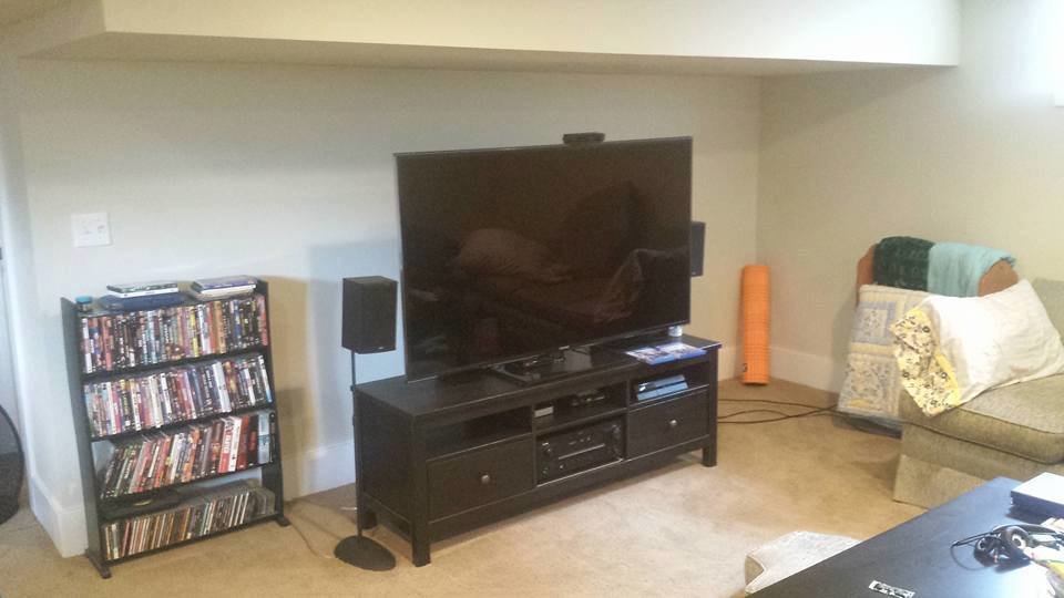

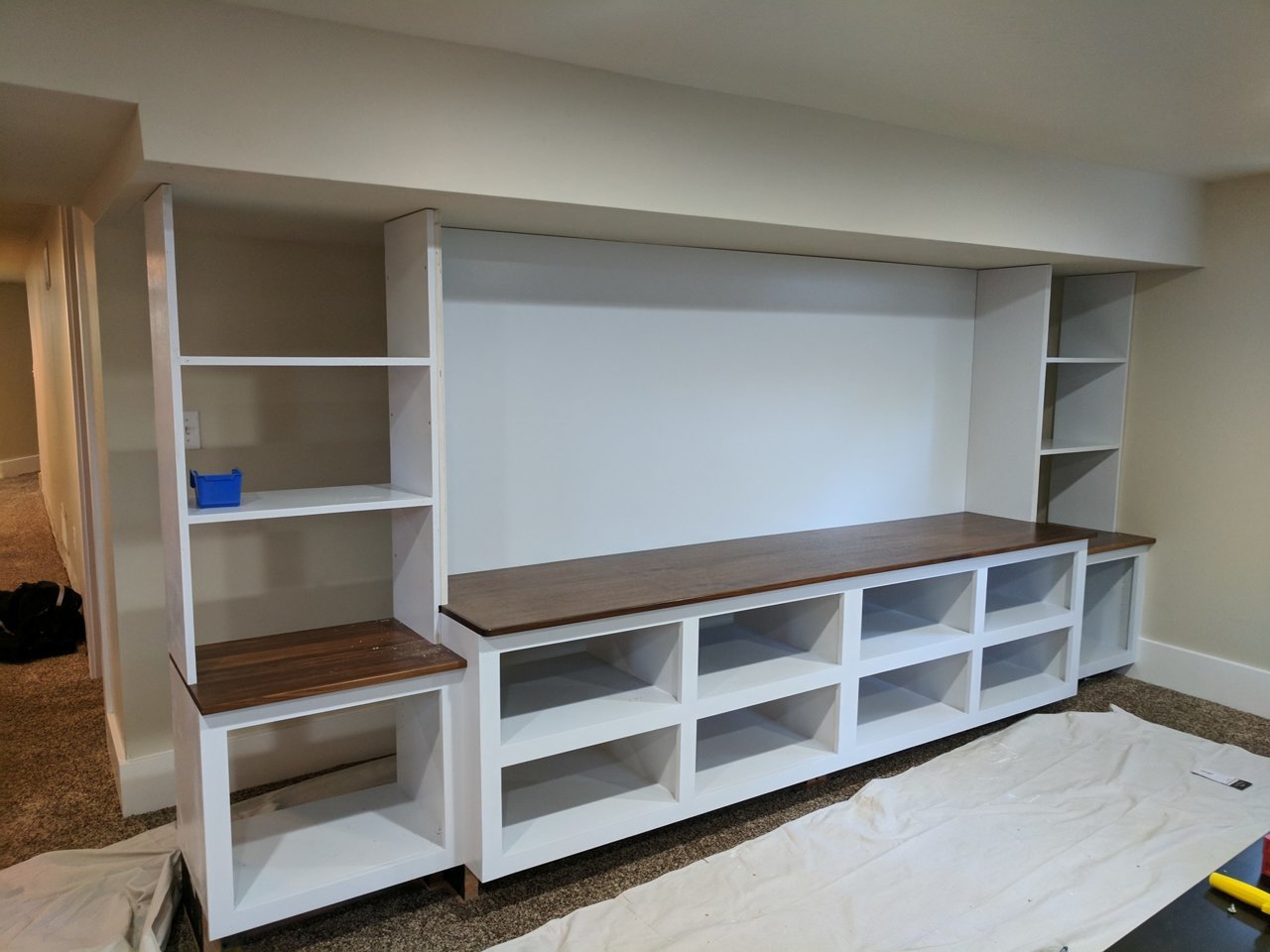

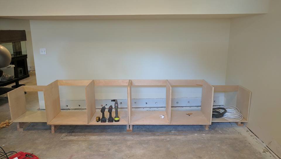

    this was in the basement a few years ago:
    22552601_10214407409078247_1535116019312_b615c5f0e249051090eb253e3df746d51ee503d4.jpg

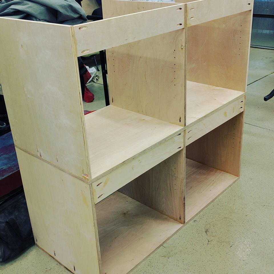

    but then i built some cabinets
    14088396_10210278608820821_1447472157317_03f22f4e6976c772bd0f75d5fd1b0c293ce5c4e2.jpg
    14095932_10210279410640866_2931323053320_4054458c5dde87f515a6ffd57a02ed9278e7c725.jpg

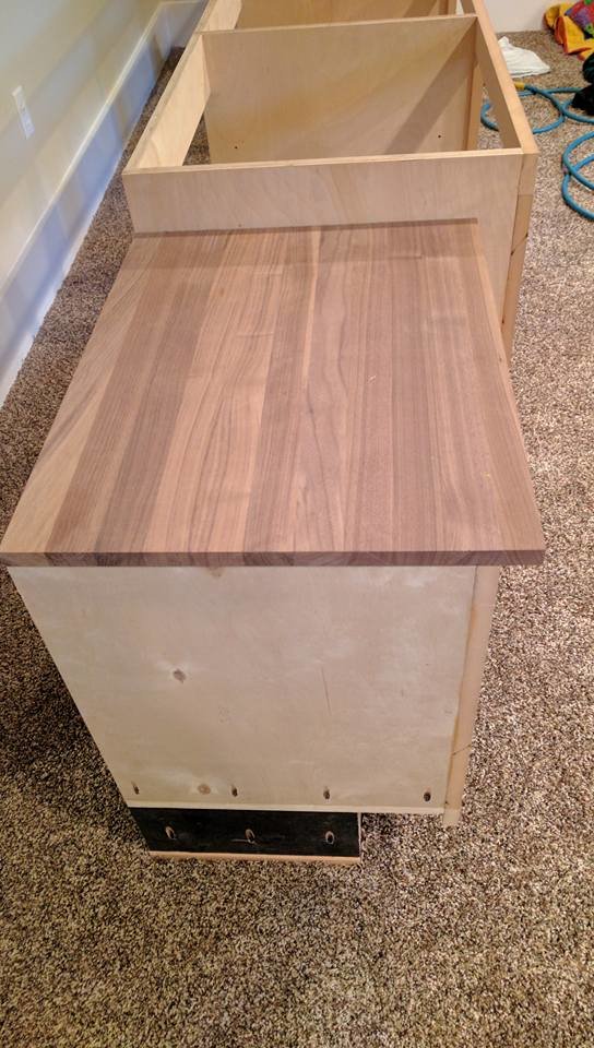

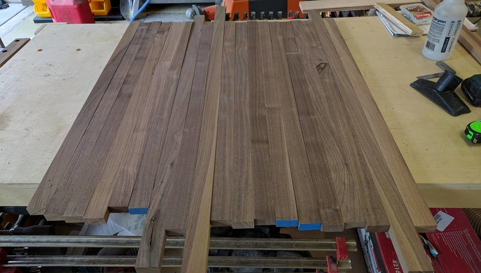

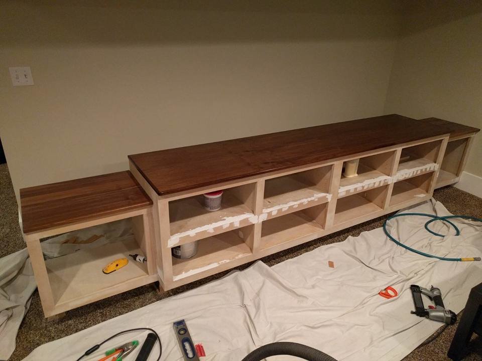

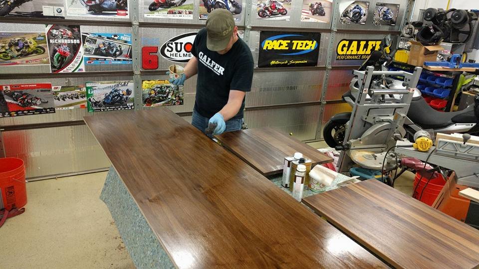

    and some countertops
    14265033_10210426078827479_8467804886568_64dfa304a3daf9e8a9a53b7abbb619cd9b86f530.jpg
    14568055_10210687477722288_6520568104165_dfc313c567301a966eb511f73267277bd8778ab0.jpg
    14650501_10210755366619468_8348005336555_868849604e6fa7aa084e3eef20310143b53e4166.jpg
    14925805_10210897237966163_4836112999766_dc349027a40c16bff12ef36a021e1932a55ee1d2.jpg

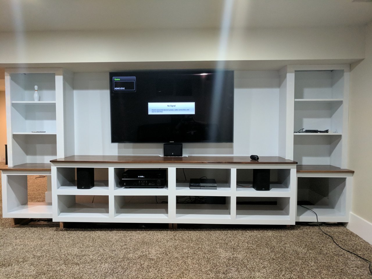

    and with a coat of paint, she's 90% of the way there
    22496372_10214383632723853_5883493625403_f3225d1715243c3bd049ace72cbe17809c8dcbd0.jpg
    22548844_10214383631003810_4411688423107_0d60d3088f0239e23ea796fc626be96d0002180c.jpg
    missing drawers in the bottom 4 cubbies and doors on the bottom ends.

    Mighty nice work! :cheers:
    Any thoughts of moving the speakers to either next to the TV or on the left and right shelves instead of down low?

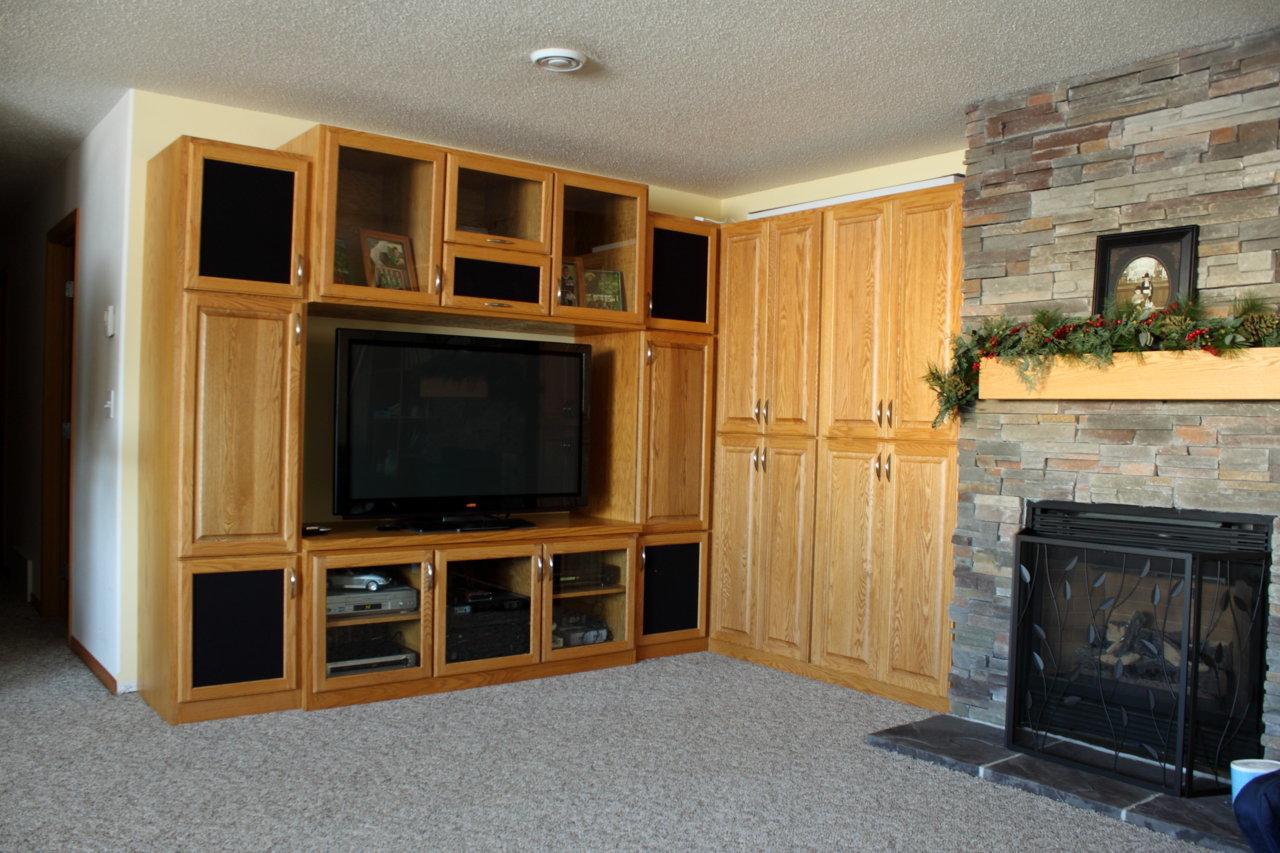

    Here's the entertainment center I designed and a former coworker built at my previous house.
    The left, right and center speakers are behind the black speaker cloth above the TV, the subwoofer was in the bottom right corner and the PS3 was in the bottom left.
    The cabinet to the left of the TV had full extension slides and held all of my movies.
    Not pictured was crown moulding that was added later.

    yes, the goal is to build speakers worth showing off instead of the crappy stuff in that photo, but i haven't found the time yet. i ordered an Overnight Sensations kit to do a center channel, and if that works out i'll build L and R that will probably just stand next to the TV in the main cabinet area, which is why it's wider than the TV in that shot.
    I've considered subs in the config you have as well. the girlfriend is redoing this area with new carpet and a couch, so i'm going to lose my spot for a sub in the corner of the room in the rear, which is a shame.
