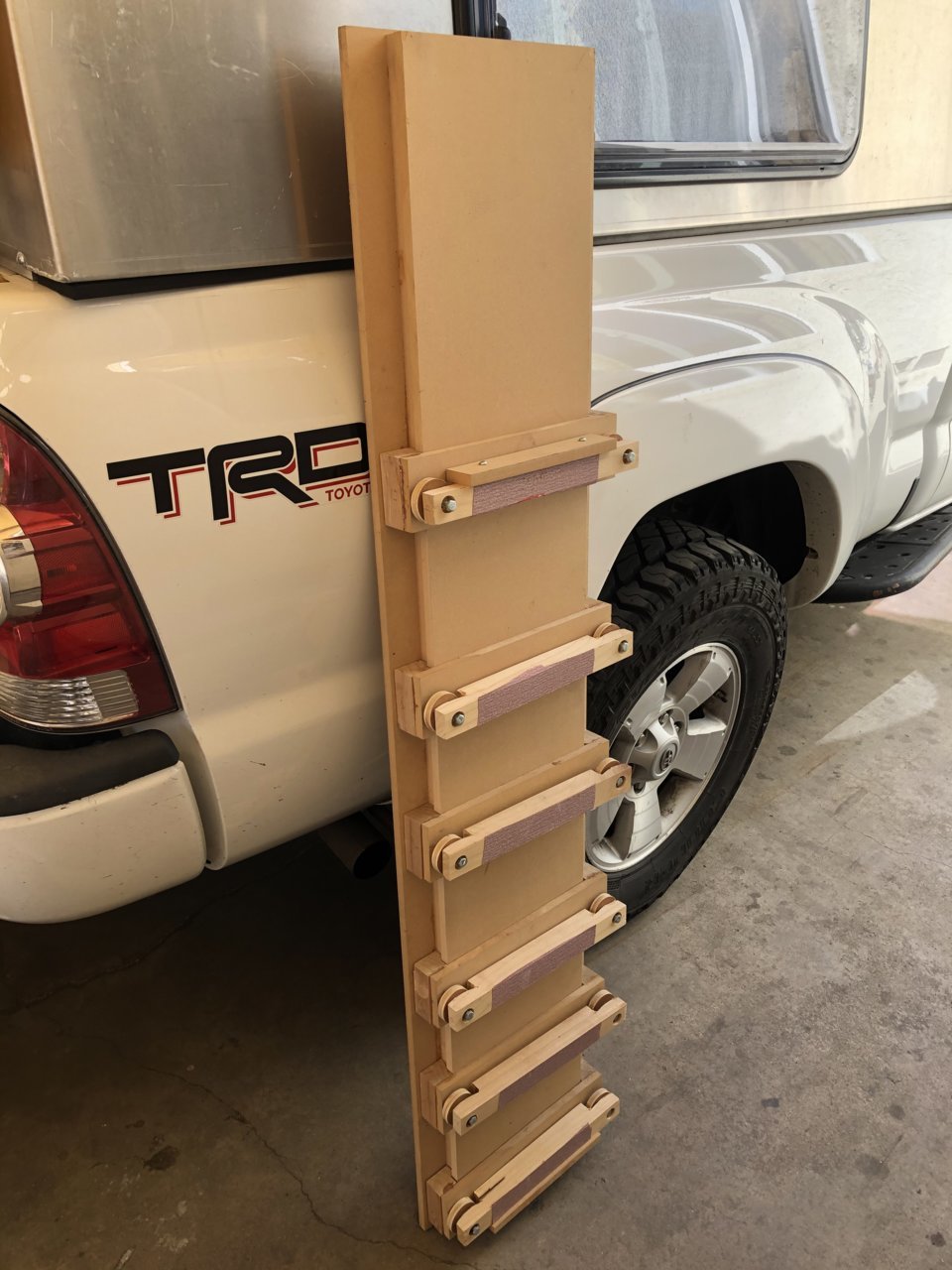

    Anyone in the la area can use a planer sled? Looking to pay in forward to a fellow tw memberCD268F07-9769-445E-9487-00BDF24E6029.jpg

    forgot to mention it was used in my 13” dewalt planer

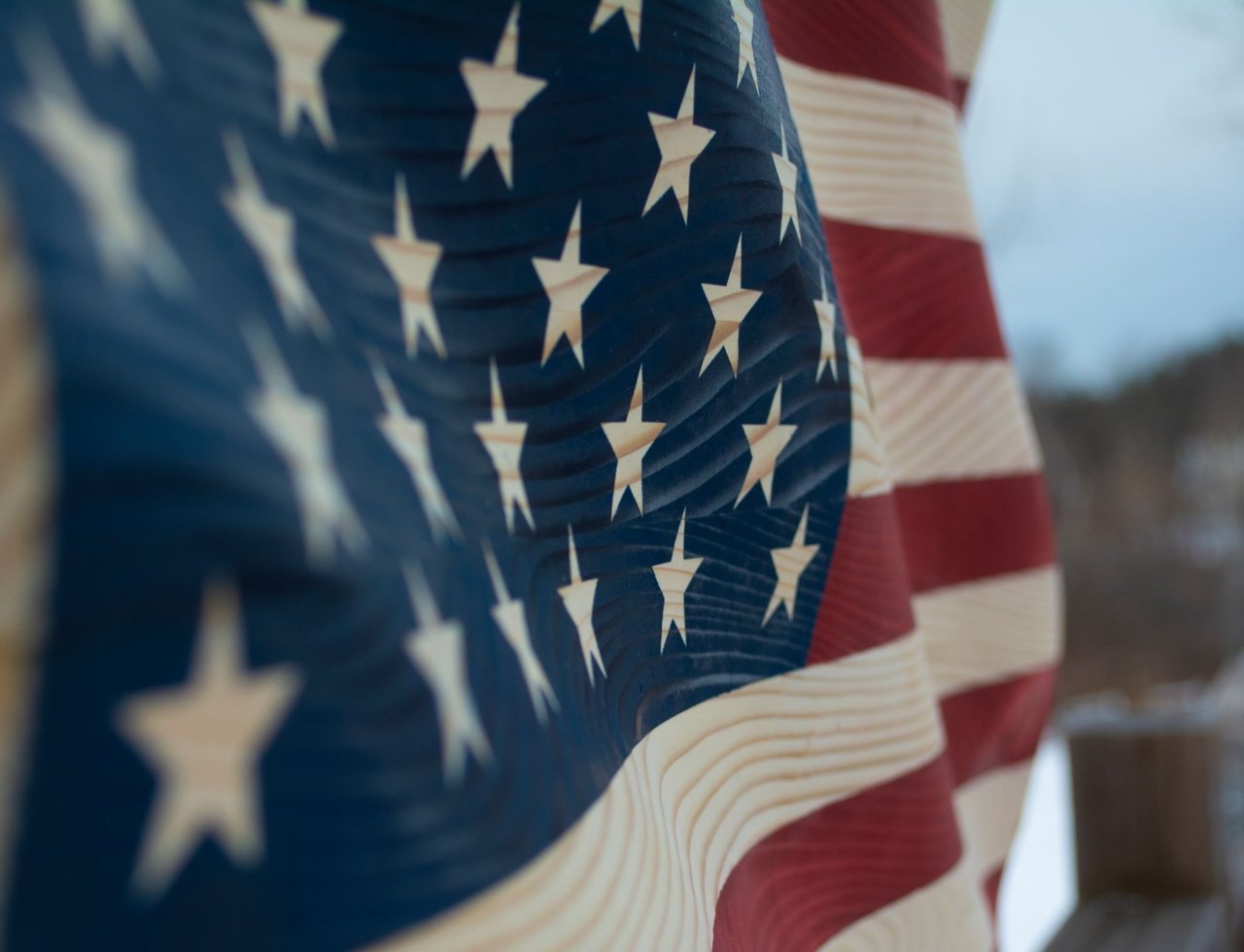

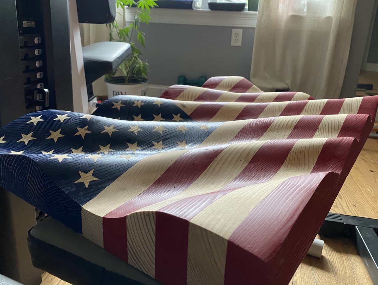

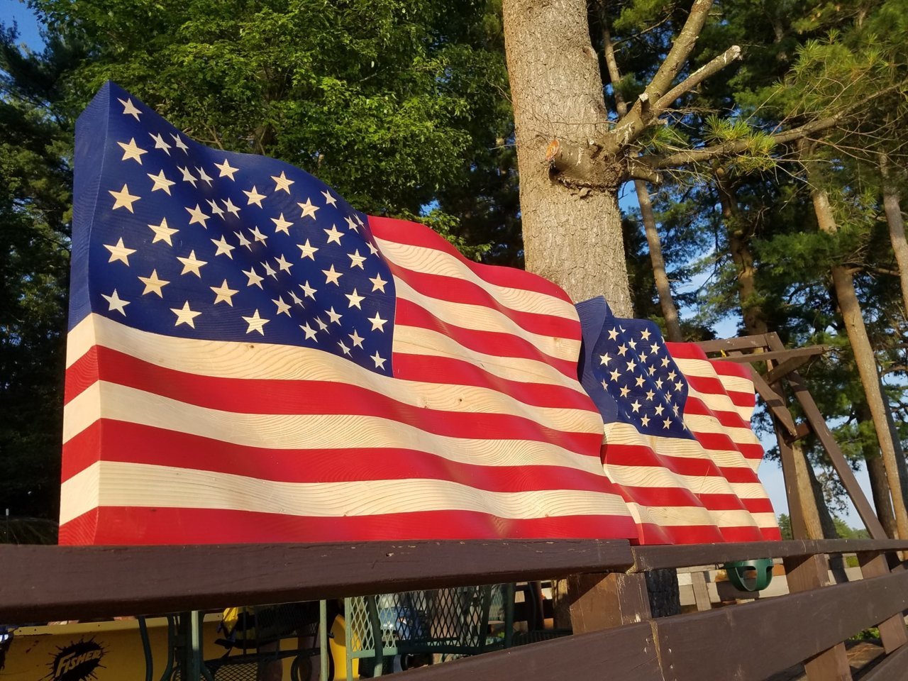

    Hey guys, just bought my first Tacoma last week and found this forum. I love that this thread was started in 2013. Anyway, I’m a woodworker so I thought I’d share some work. I’ve been making these wavy flags lately and they’re a lot of fun. Solid Douglas fir (laminated 2x4) and spray paint.

    That looks great please share how you did that.

    Thanks! I basically glue a bunch of 2x4s together into a big block, then I use a series of attachments on my angle grinder to power carve the waves. The first attachment is sort of a cupped-spikey wheel by Kutzall. From there I use a 2” random orbital sanding attachment by Arbortech to reach all the concave parts, and my 5” random orbital with a contour pad to sand the rest. Sanding takes an eternity while the carving usually only takes an hour. Painting is pretty straight forward. I lay down a vinyl sticker of the union and paint blue over it, then painstakingly remove the stickers. Stripes are just done with painters tape.

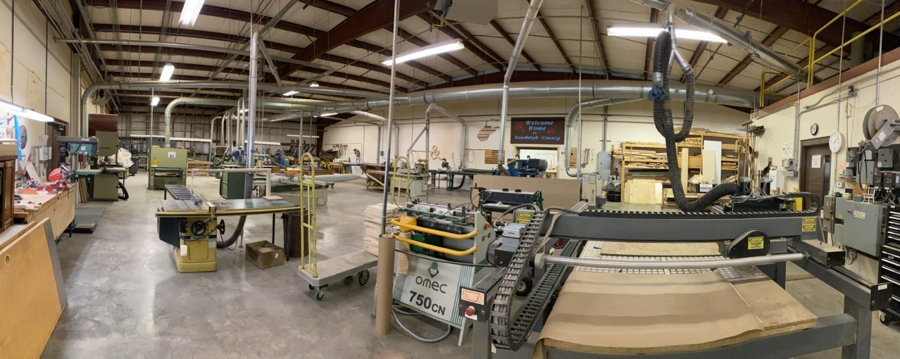

    F8D0356A-BDC5-4CE0-8DBD-E8FE9B789AC7.jpg The organization I work for just got us memberships to this co-op :eek:

    Nice!

    Those are absolutely beautiful :thumbsup:

    Cool! But I could never work in a shop that clean.

    I’m assuming the vac system helps keep it clean, I’ve never seen a wood shop that clean.
